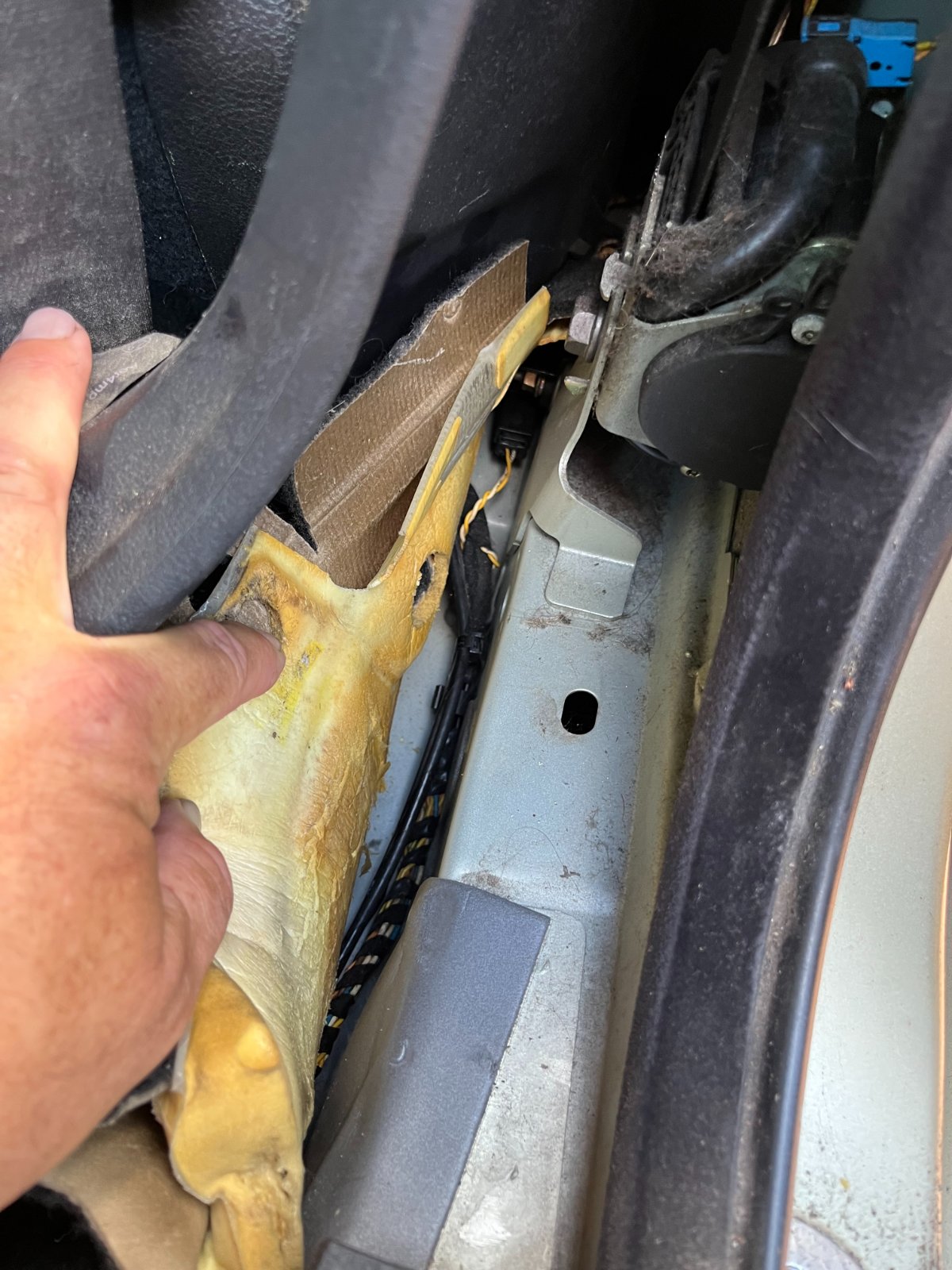

So I pulled the seat belt bolt, trim and carpets off only to find the sensor forward of the driver's side pillar (so your diagram is for the passenger side :)
It helps re access to raise the seat up and move / push it as far forward as you can.
I knew I had a bit of a water leak when it rains , both driver's side front and rear passenger foot wells get damp (Ive tried but failed to find the source) but the spongy carpet was pretty soaked, so I guess the moisture is not helping the connectors.
The sensor itself is a bugger to get to as it low and encased by a black metal shield. I tried to find the clip to release and pull the plug off but failed (ps - its under the plug closest to the floor)
In the end, I resorted to removing the top rivet and bending the shield out of the way a bit as there was no other way to slip it out after removing the bolt.
I clean and reconnected it a few time and then check the air bag warning and it went off. So far so good I thought.
I used a hair dryer on low heat running for a few minutes each time under the carpet to try and remove a bit of the moisture but suspect a few days in the sun would be required (which is probably why the warning comes and goes). That said, it was 37 C here yesterday so I left all the doors open .
Alas, driving back from work today the dreaded air bag light came back on, and then disappeared just as I got home.
So
a) could the sensor itself be the issue - any way to test ?
b) other than cutting out the carpet sponge in that location in the vain hope it might help, any other ideas ? Its sort of hidden bewteen the driver seat and seat belt
c) any ideas where the water leak might becoming from ? Seals look fine, no obvious water trails (but I have yet to used the talc powder trick)
ps - seem like they could have mounted it in the small space just below the seat belt coiler (eg inside the pillar itself) which would have lifted it up off the floor but maybe caused other issues.
cheers

On the wet issue, I'd bite the bullet - as I have many times on soggy Xantias - and remove all the carpets and let them dry fully in the sun. They won't ever do so whilst in position.
I know it's a lot of work but worth it.
I'd do the same with that sensor. Remove it and leave it in a warm place for several days to properly and fully dry out.
Then replace it and run around in the car with no carpets fitted for a few days to see if the problem is fully resolved.
x 6947
Re: Airbag, Dashboard, Seat Belt & Airbag ECU Repairs
I agree with Jim, you may have an issue with ongoing damp in that area that may well have caused the internal sensor components to become corroded from moisture ingress.
