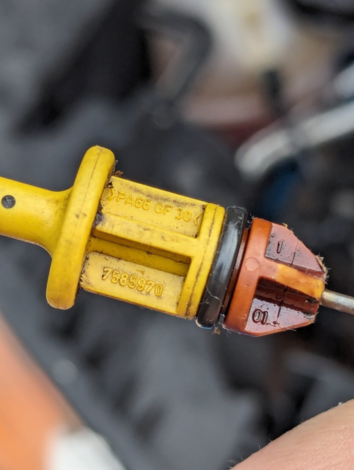

If you have to pay for a diagnostic it might cost more than just a new sensor. I would also check the dip stick is the right one, some cars have plastic tipped ones which can break and if this has happened the wrong one may have been put in. Do not put any more oil in though until the checks have been done or the level could end up too high.

Good call on the dipstick Paul, as they can break without it being obvious...
Pop a photo of the dipstick up and we'll soon be able to tell you...

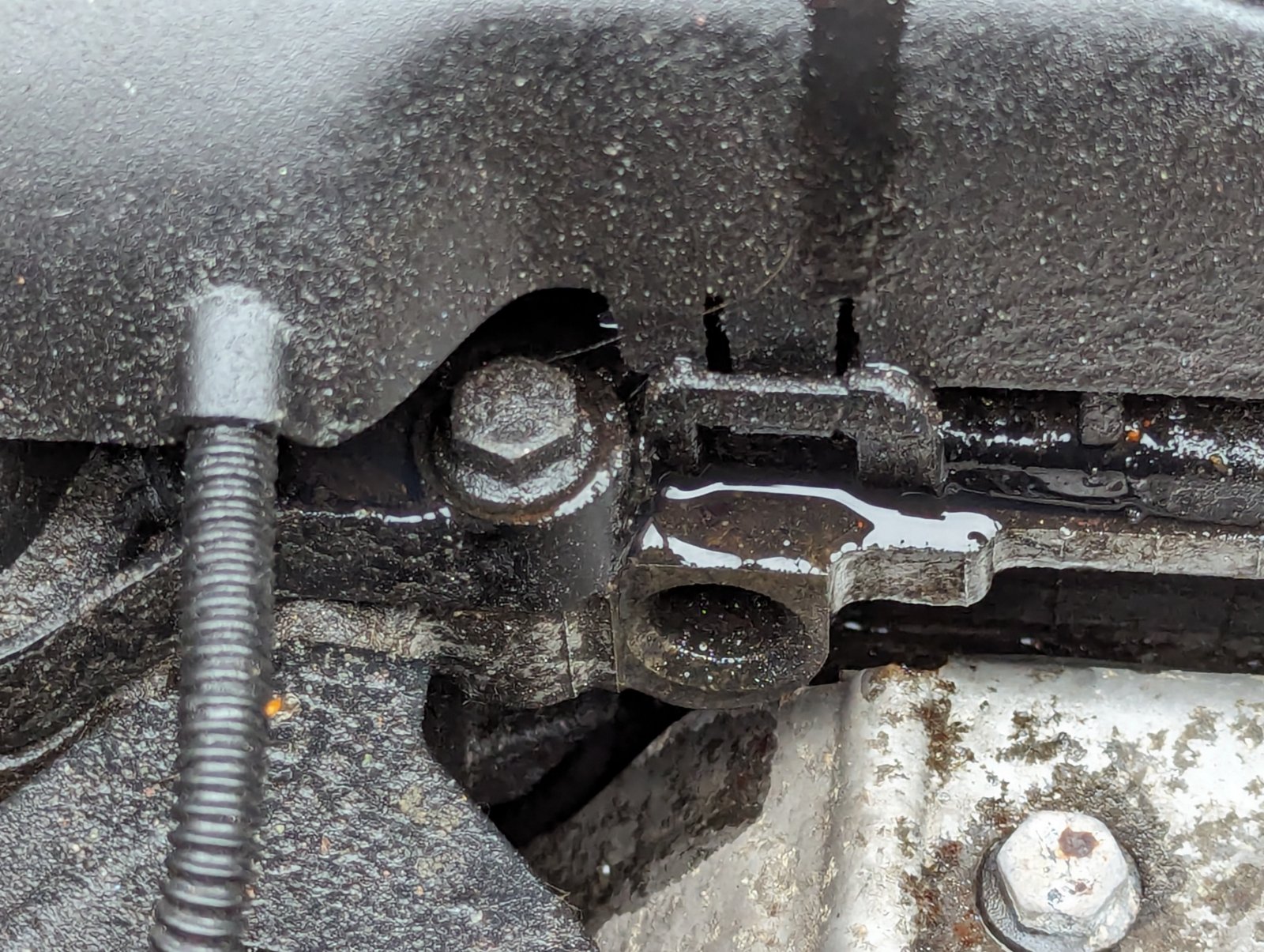

Hi i had a look at the dipstick not sure if it is the correct one, i have attached a photo, also after topping it up with oil i noticed some oil at the seal, can anyone tell me what this part is called

We need to see the other end of the dipstick too ;)
The seal you speak of is an O Ring...

I have been told i need a new rocker gaskit, i will get a photo of dipstick in day light, thanks for all the advice.

bpdburgh wrote: 18 Dec 2023, 17:52 I have been told i need a new rocker gaskit, i will get a photo of dipstick in day light, thanks for all the advice.
Yes, given the area of the leak I'd agree...

A place near me in scottish borders said £600 - £700 another place about 20miles away £150, i think the first company thought it was a full head gaskit, but they said no its rocker gaskit coming from citroen, all though the garage is not a dealer or anything, bizzare, i would have taken it down to hebden bridge they are great but with christmas and new year traffic nope, Thanks
