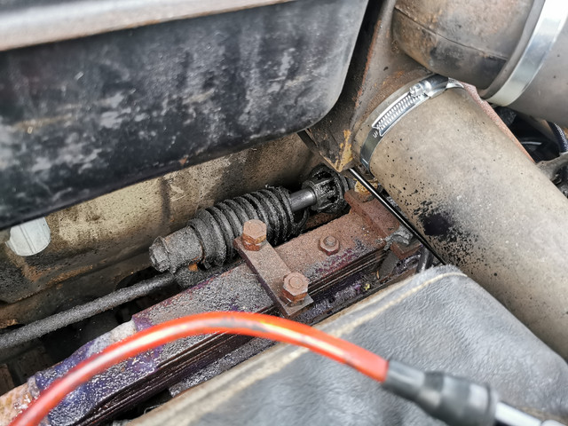

Noticed another item for my shopping list today in the form of a steering rack gaiter.

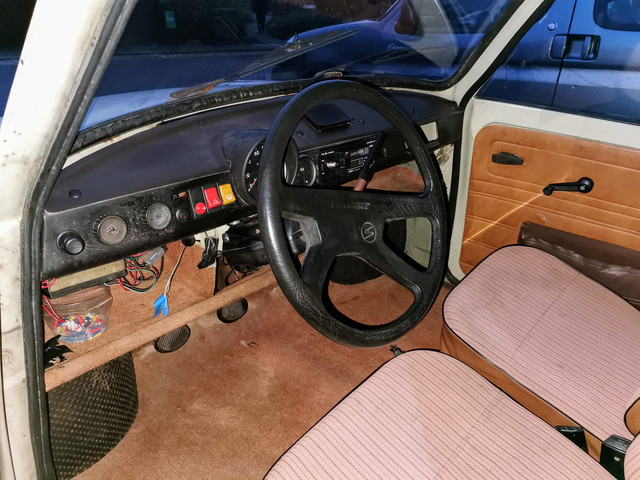

I did give the dash a (very) quick wipe over though, and have got the shelf underneath back into shape again. It had basically collapsed because several of the trim clips that hold it up had vanished.
They definitely haven't been replaced with a random selection of screws. I'll put the proper clips in once I have some to hand - all the ones I currently have are too big.

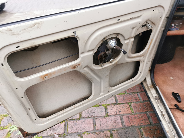

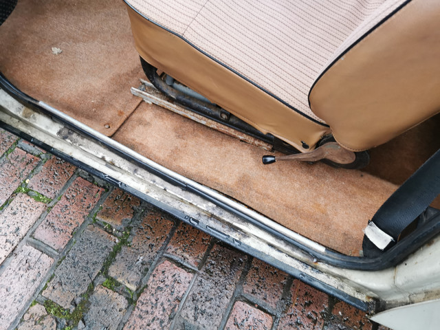

Probably the single biggest headache (I'm aware of at the moment!) with the Trabant is the water ingress. The doors are clearly playing a fair part in that based on the damp spots.
I'm sure the seals themselves have a part to play there as they're basically totally solid chunks of plastic which may have at some point been rubber. I'm sure as a result that they're really not doing much useful.
My eye was also drawn to the fact that there's no drip shield behind the door card.
It sounds as though there may actually not have been anything in there, and admittedly the door card itself was bone dry when I took it off.
Trim clips...I have a grand total of three present for each front door out of...eighteen it looks like. So I'll really need to try to find some that fit! It would be nice to have door cards that don't flap around every time you close the doors.

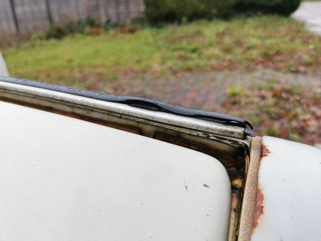

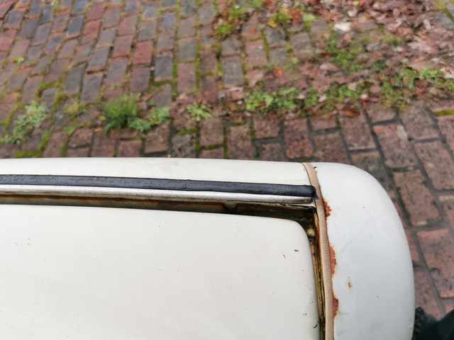

On the driver's side front wing top the rubber infill strip on the panel join had lifted near the front in a couple of places.
As you could see this from the driver's seat it was disproportionately bugging my OCD.
Thankfully with some careful prodding with a flat blade screwdriver I was able to get the infill strip back into its groove and to sit flat again.
It's a tiny detail at the end of the day, but they all add up eventually.

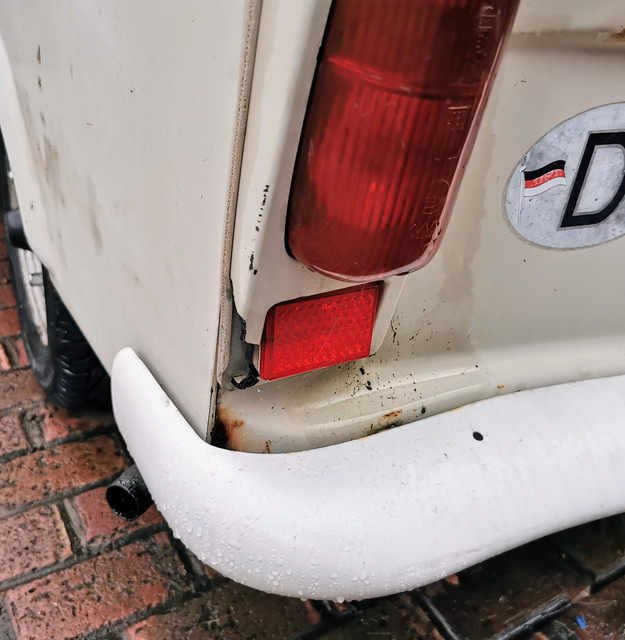

On a similar note is this rear light surround which I'll need to find a replacement for. if I had the broken off bit I could probably glue it back together, but sadly I don't.
I've also had a look at the very loose latching of the boot lid. On that one I'm scratching my head a little as the striker plate is adjusted as far down as it can be, but there's still a good 3/4" of slack when the bootlid is latched. I do wonder if this is just down to the seal itself degrading rather than there being anything wrong with the latch - as it all looks fine.

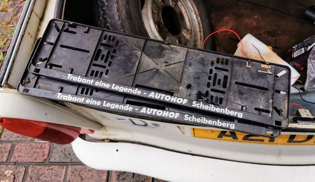

Did find a pair of number plate surrounds in the boot while rummaging around which obviously date from the car's previous life in Germany.
I'm really not a fan of fussy things like this on cars so they'll probably just be carefully stored to be handed on to the next owner with the car when it's eventually moved on rather than put back on the car by me. Interesting to see though.
The whole "this will only be here for a month or three and I'll not be spending any money on it" thing isn't going very well. This evening I put a €300-ish order through to Trabantwelt for the following.

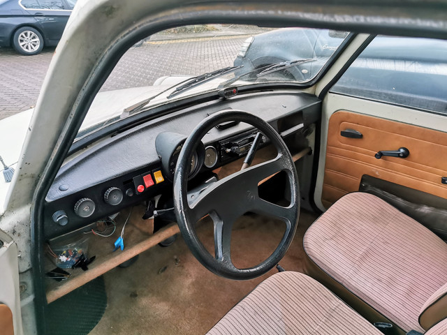

Today I could have been sensible and taken the Peugeot to get my various bits of running around done, but that's boring, sensible talk.
Plus with how much of a zoo anywhere near to a retail establishment is at this time of year a tiny car is a major bonus. Being relatively immune to door dings in car parks isn't a bad thing either.

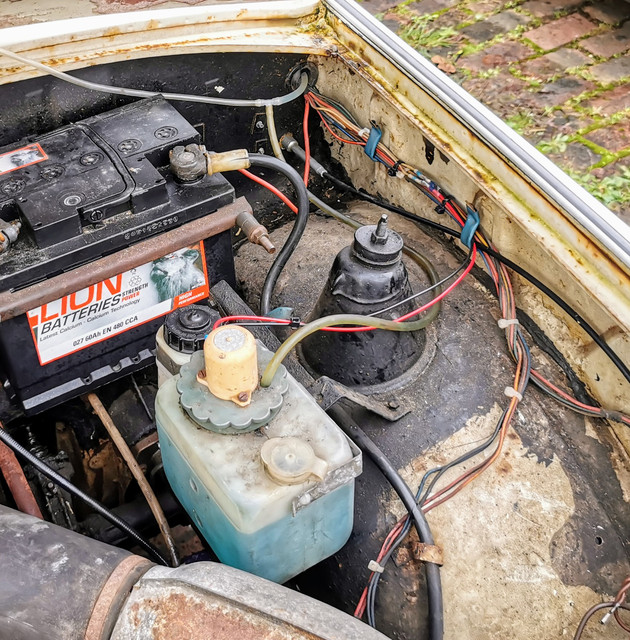

With those two cut wires hooked back up the windscreen washers now work correctly from the control again. Not the tidiest job I've ever done but it will do.

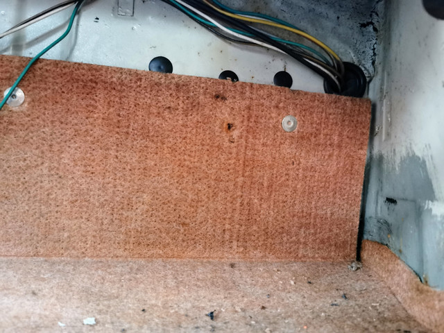

Under the dash I had spotted a couple of holes in the bulkhead through which I could see daylight, so found a couple of trim clips to fill those - I put a blob of grease behind them to discourage any water or fumes from using it as a way to enter the cabin.
Sure there are probably plenty more of those, and the grommet the wiring loom goes through there has an opening I can easily fit my thumb through, but I've tried at least!
While I had the trim clip box out I replaced the one broken clip which was holding the dash mat to the top of the dash. Of course it looked daft with one that was slightly different in design to the others, so I went and replaced all of them so they at least match.
Hoping this weekend I will have a chance to do something about the dangling wiring under there, but it's always hard to say how time will work out at weekends.

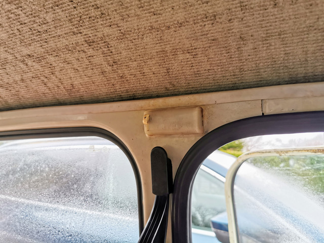

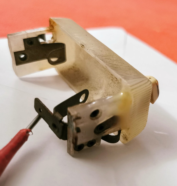

The interior light was just dangling by it's wires as part of the housing has cracked. I've attacked this with epoxy this evening so hopefully it will stay put in future. Not sure if the contacts will clean up enough for it to actually work - but not falling out as soon as you close a door would be progress.

The repair to the interior light lens appears to have worked.
It hasn't fallen out again so far anyway. Unfortunately it also doesn't seem to work, though I've yet to ascertain if we have power to it yet and couldn't summon the enthusiasm to go all the way back inside and upstairs to retrieve a meter today.

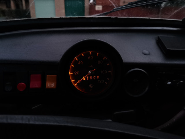

I did have the occasion to actually make use of the headlights after dark today and can confirm that they are marginally less useful than the dash illumination.
Not great.
I have a feeling that they're just aimed really low to compensate for being LHD headlights as they did seem to be doing a halfway decent job of lighting the tarmac about 6' in front of the car, but that was it. I need to take a closer look at them to see if they are the same 7" size that seem to be really common. If so I'll probably look at seeing if we can modify a spare backing plate to use a Mini style headlight unit, allowing us to get proper RHD lights on the car. Helpfully I do have a couple of spare bowls so I can experiment easily enough there.

Your speedo illumination is about on a par with that of a Series 1 AX
