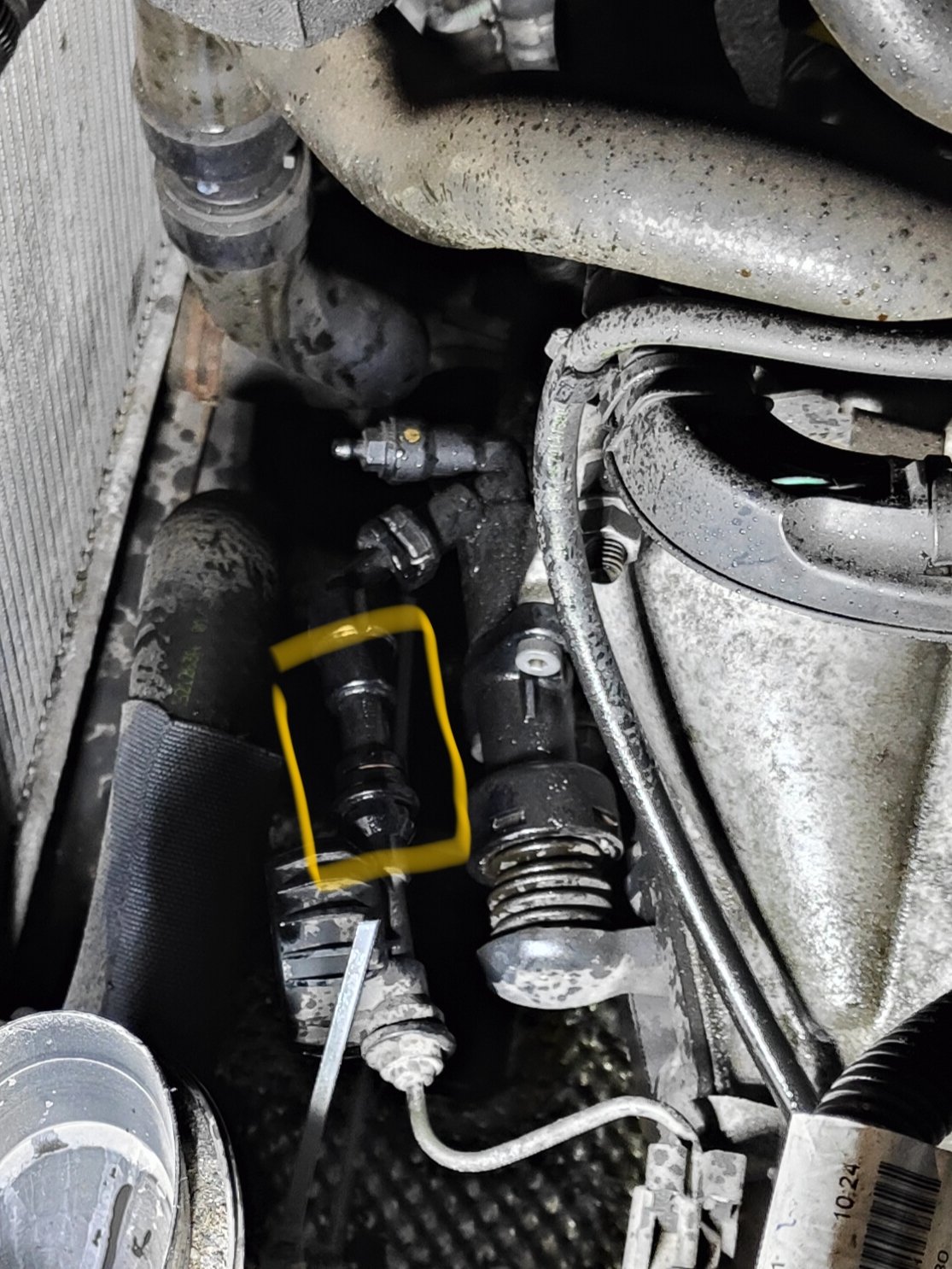

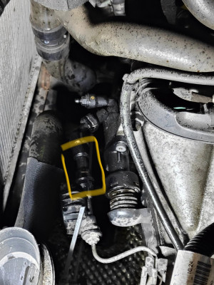

Car broke down last night on rush hour when the clutch pedal dropped to the floor
Had the RAC out and they recovered me to a local garage who have been trying to fix it today
Looks like it is the pipe in front of the slave cylinder that goes to the bleed nipple and the pipe has lost two small circlips that hold it together meaning the clutch fluid is spraying out as soon as the clutch is pressed
Pic attached, fluid coming out where the yellow box is highlighted
Does anyone know if these circlips can be obtained on their own or do I need the whole new part? Garage says that is a special order from Citroen if I can't get the clips?
Aaaaagh!

That's the declutching master cylinder and is only sold complete by Citroen.
