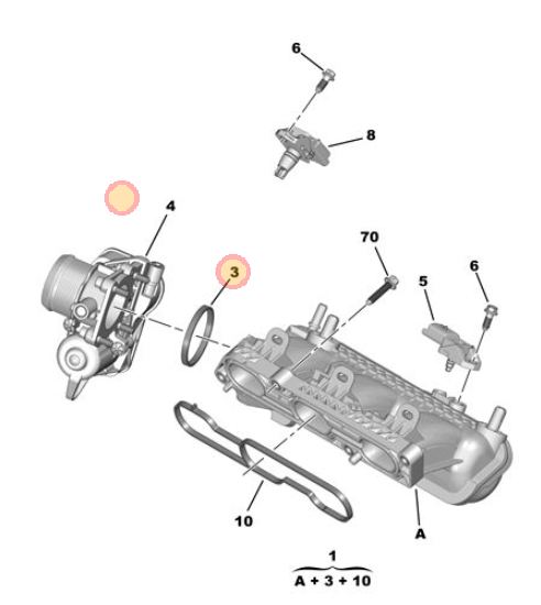

Right, I have more information.
I'm hoping the image will attach successfully.
Part no 3 is 9803918480 - the grommet
Part no 4 is 9842936880 - the throttle
Costing ... sit down and take a deep breath ... £428. I wonder how many hours labour I have to add to that.
I might get my garage to double check that the part is needed and that it's not something else making the noise before I break the piggy bank.
