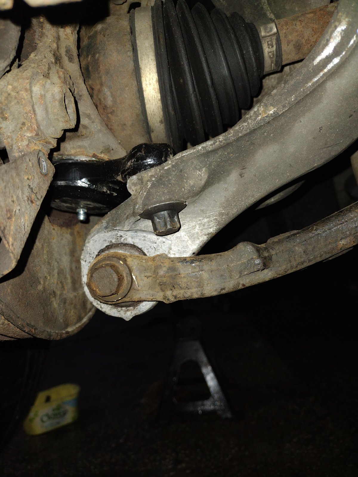

A = the nut that's supposed to hold the strut (anti roll bar drop link on other end of this)
B = driveshaft which it's can't have sat against in service (as would have worn a grove in it with the load it would have seen!)
Quite baffling!
Me, in May!!
Quite baffling!
Me, in May!!

Just for completeness, FRIP with grease nipple installed today:
Described profusely here:
viewtopic.php?p=782201#p782201
