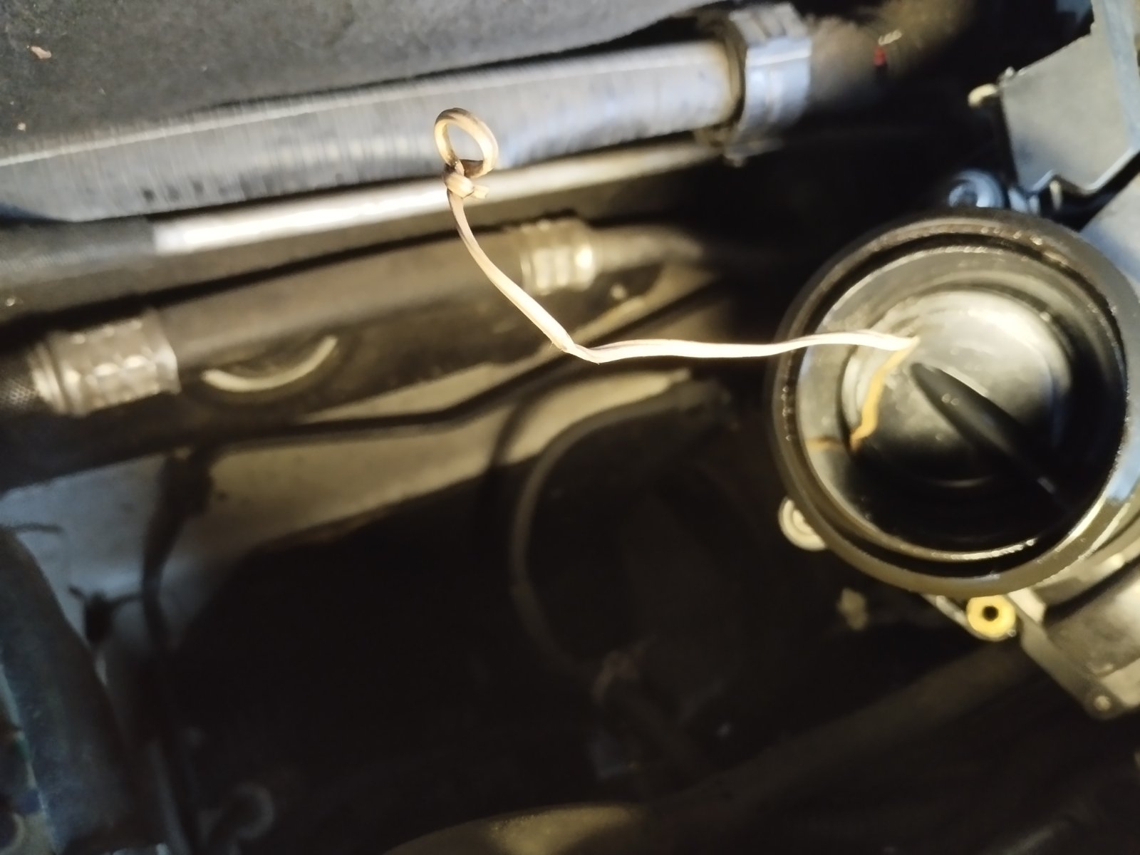

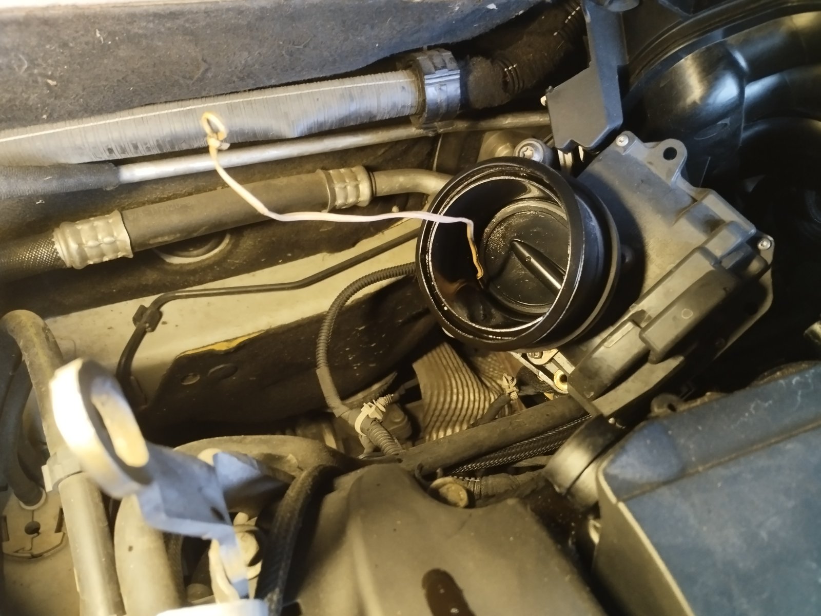

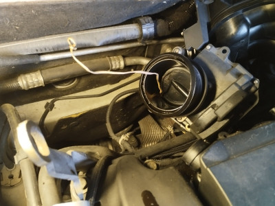

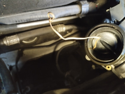

Unread post by xantia_v6 »
What is that?
What is that?
The thick plottens...
And how did it get there?
Posts: 11006
Joined: 09 Nov 2005, 22:03
x 1476
Re: THP Engine Fault Codes
I removed that wire tie and the P3010 fault disappeared, but there were still permanent faults with throttle calibration and the throttle actuator test would not work.
I reassembled far enough to start the engine, but it was not very happy, with erratic idle.
I reinitialised the ECU auto-adaptives and went through the throttle calibration procedure.
It now seems to be idling OK, and all of the fault codes have cleared. I will take it for a test run tomorrow.
