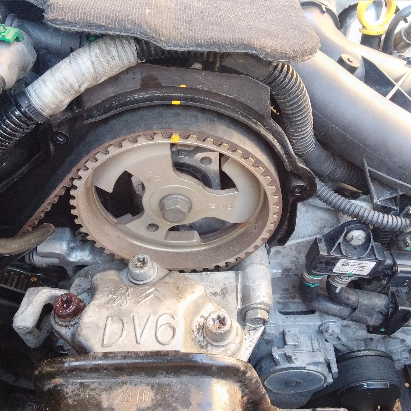

Its amazing what you find when ...

What am I looking for?

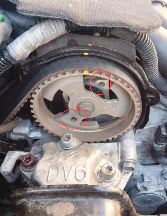

Looks like a cam pulley 180° out to me (spin the crank twice more!)

It still starts up ok , reason i checked , service history said changed full cambelt kit 2018 at 92500 miles so i checked & belt looks good but when i saw the yellow paint dots i lined them up and that photo i took shows my confusion. How ever i lineed the top hole up and the bottom lined up spot on , but the paint mark is in a different position, i thought it might of been done due to the cam shaft oil seal being replaced and the mechanic being a bit lazy ?
