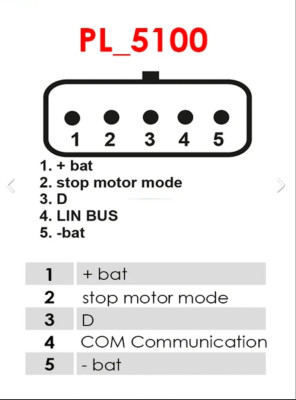

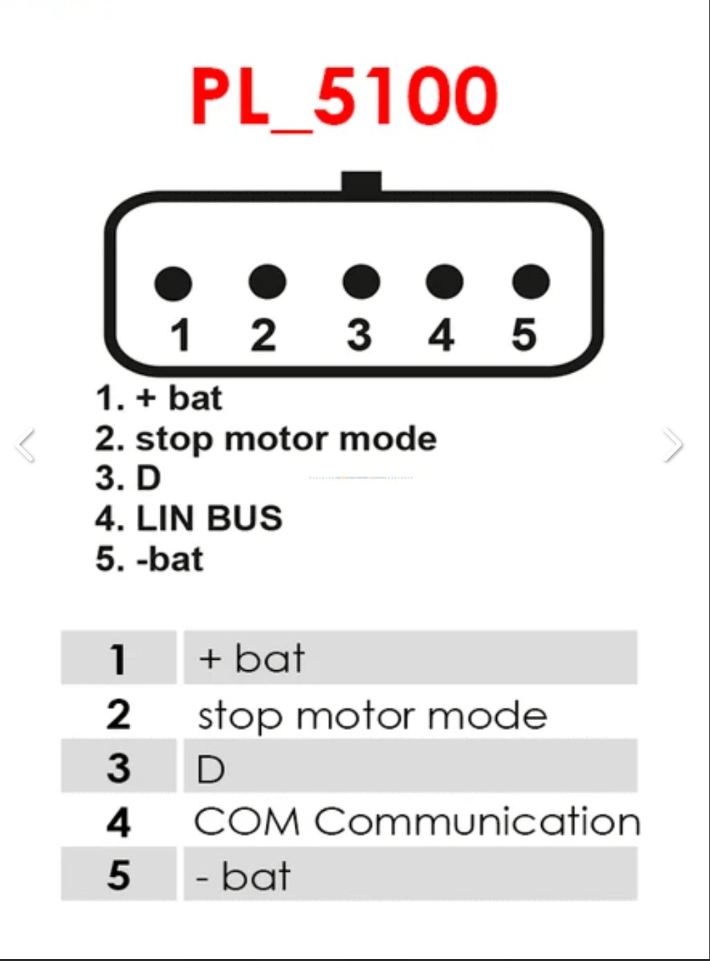

Yes, its the smart 180a alternator with 5 pin connector.
https://as-pl.com/en/p/A3439(VALEO)
At the it doesn't charge at all so i was trying to force it to charge to see if it's the alternator part or the ecu part of the alternator thats broken. Can even be something closer to the controller talking to the alternator through the lin bus. So my first check was to se if i could trick the alternator to output power always like a full field test for dumb alternators.
