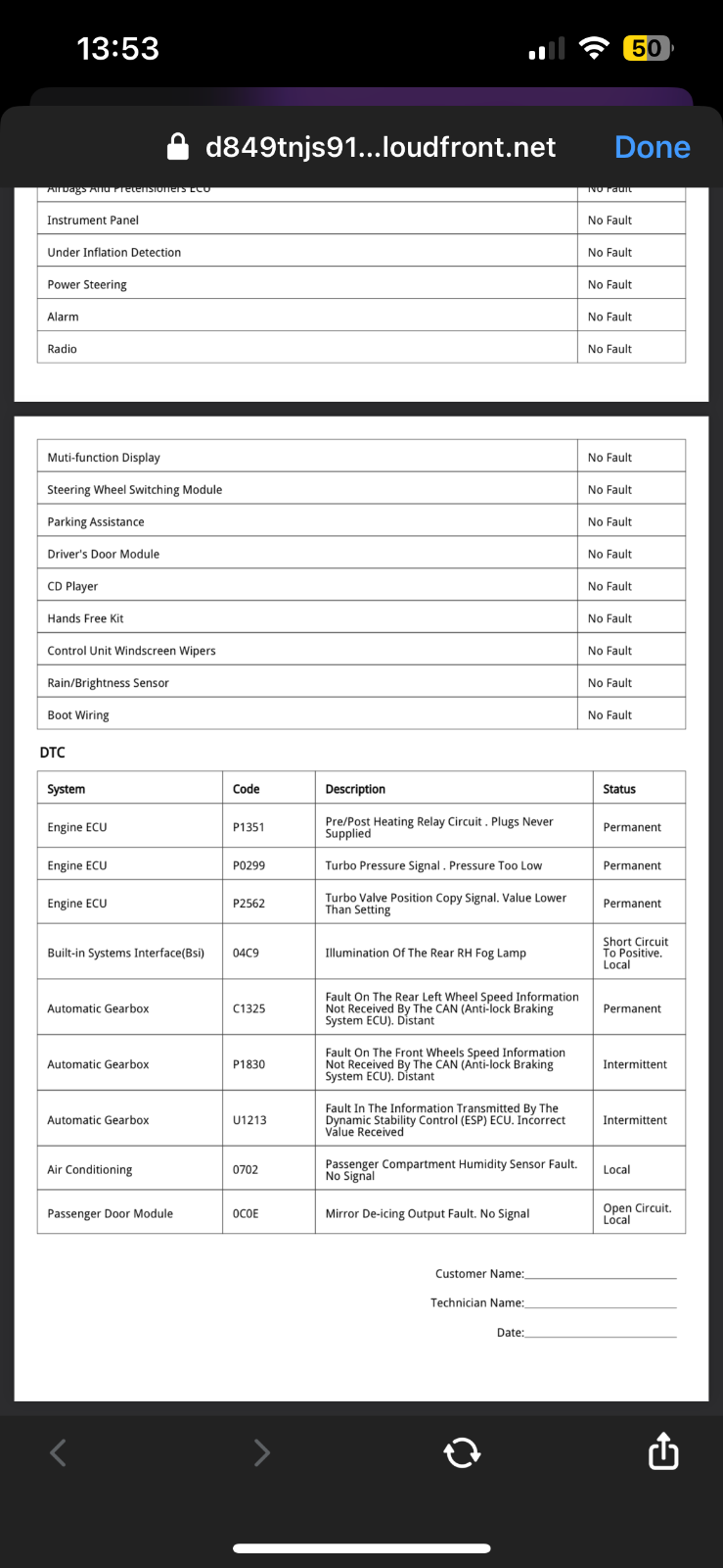

Thank you for the reply, I had a mobile mechanic out to run diagnostics and he gave me a copy of the report which should be attached to this comment (if I’ve done it right)GiveMeABreak wrote: 14 Nov 2023, 13:25 Limp mode is only triggered as a result of action by the engine ECU for obvious reasons to prevent damage if there is an issue, and this would have triggered a fault code. So not sure what diagnostics your garage are using, but if it's a professional tool, and no faults are returned, then it won't be in limp mode. Backup mode will limit engine power regardless of the situation, not just hills, so can't be that.

You have 2 key fault codes there:
P0299
P2562
Both these are to do with the turbo. It is likely that these are what are causing the problems as without turbo pressure, you'll have no boost - especially on an incline.
The Gearbox faults will be because of the wheel speed sensor. That info is used by the ESP ECU to advise the engine ECU and the Gearbox ECU and other vehicle systems of the vehicle road speed, so is essential you get that sorted as you'll have no cruise control or ESP functionality with that fault and will continue to get gearbox warnings.
If you have your VIN, pop that up and I can relate the fault codes above to your engine specifically. Please post your VIN in full without spaces - it will be automatically masked from public view after submitting your post & will only be visible to staff.

That makes sense thank you for laying it out for me the guy working on it who I bought it from said they had a mechanic out that claimed to have snipped the wires to the sensors at the front relating to the ABS I’d now assume that it’s what’s causing the ABS/ESP ECU Transmission faultsGiveMeABreak wrote: 14 Nov 2023, 14:08 You have 2 key fault codes there:
P0299
P2562
The mobile mechanic that came out noted that the sensors at the front were working as he was getting live data when he was moving them independently and when he drove back and forward it was just the rear passenger (left) that appeared to have been worn by some dirt/debris coming into contact
He inspected the wheels one by one too
My VIN is VF3**************[VIN obfuscated, can be read by forum staff]

Ok so here are the main faults to address in addition to the Wheel Speed Sesnor. This system should be the Siemens SID803 Injection System according to your VIN, so these fault code descriptors apply:
| Fault Code: | P0299 |
| Description of Fault: | Turbocharger pressure signal: Pressure too low in relation to the reference value. Difference negative for 10 seconds, between the turbo pressure reference and the measured turbo pressure: The turbocharger pressure is below 800 mbars at the reference point, for an external temperature of 20 °C and at an altitude of 0m. Conditions of activation of the diagnostics - Engine speed above 1000 rpm - The actual engine torque is higher than 70 Nm |
| Conditions for Fault to clear: |
| Downgrade Modes whilst Fault is active: |
| Symptoms: |
| Suspect Areas: |
| Fault Code: | P2562 |
| Description of Fault: | Turbo position copy signal fault: Positive gap between the reference turbo position and the position measured. The fault is forwarded if the difference between the reference value is above 30% at the actual position (For at least 8 seconds) Conditions of activation of the diagnostics - Engine speed above 1500 rpm - Engine torque higher than 120Nm |
| Symptoms: |
| Suspect Areas: |

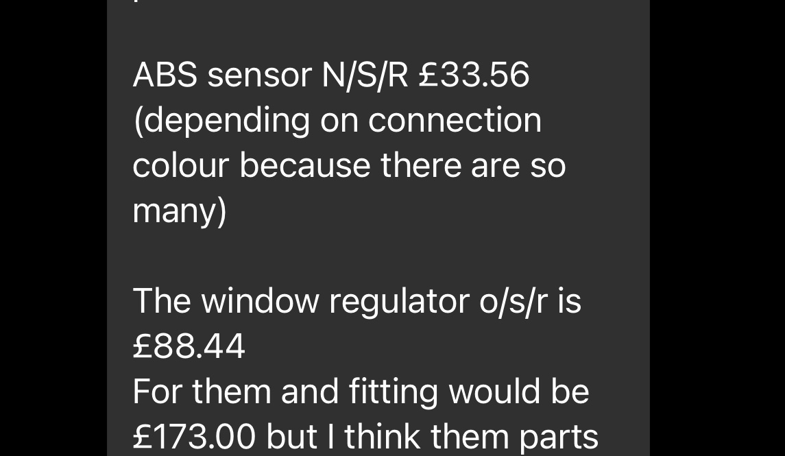

I don’t suppose you’re able to find out what colour connector would be needed for the ABS sensor using the VIN?
Fully appreciate your help here

Not sure what you are asking regarding colour connector? - if the wheel speed sensor is damaged it needs replacing and the whole sensor and cable it is attached to plugs into the static harness when fitted.

Apologies not a car person myself learning as I go along, I was told that there are different coloured connectors as a part of the ABS sensorGiveMeABreak wrote: 14 Nov 2023, 16:28 Not sure what you are asking regarding colour connector? - if the wheel speed sensor is damaged it needs replacing and the whole sensor and cable it is attached to plugs into the static harness when fitted.

We only use official parts from PSA, which would bring up the correct part number for your vehicle.
