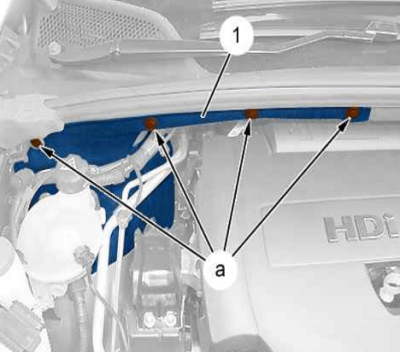

It's not shown in the owner manual because it's considered a service item undertaken by the garage at a certain service interval.
It's not located internally, which I suspect is where you've been looking. It's accessed from under the bonnet upper right hand side (UK Driver's side). You'll need to remove the trim as shown...
... to get to get to the pollen filter cover below:

Re: DS4 2021 and later - cabin air filter - replacement
I've checked it personally and Cabin Filter for DS 4 2021 and later is located at the passenger footwell after dismounting the cover below the glovebox.
- Posts: 42019
- x 6955
I think I checked under Citroen and not DS, sorry about that.
