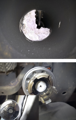

Here are some examples of where crystallisation has happened at the injector and just inside, but of course can happen further back if the heated UREA pipe stops working, or the tank stops heating for example.

This is very encouraging. I got the P20E8 00 (specifically 00) code while driving across Europe at the end of the summer when there was a bit of a late heatwave - so nothing to do with crystallisation due to cold weather or heater failure. I'm still hoping that it's just a clogged injector and/or line, and that the bottle of 4TEC anti-crystallisation fluid I bought can work its way through and maybe unblock it. I've read cases where people have done this and have seen the error disappear after a few hundred KMs of driving. My NCT (MOT equivalent) is due in January though, so if I don't see results soon, I suppose I'll need to find a mechanic who'll check the injector to see if it's fouled up.GiveMeABreak wrote: 09 Oct 2023, 10:19 P20E8 00 does indeed mean there is crystallisation between the UREA injector and the UREA heated pipe. It can occur at low mileage. It is detailed in several Technical Bulletins across the range where this fault code is present.
This AdBlue and the SCR system is a very problematic beast to deal with, and it's a bit of a black box as far as standard diagnostics tools go. The fact that there are several TSBs for this code is good news to me. I don't like the idea of bringing it to a dealer who's probably only interested in selling me the whole tank + fitting for €1500 or whatever they charge, and has no interest in doing any real diagnostics. My car is a 2016 508 RXH with 130k on the clock, so I wouldn't think Peugeot would offer any contribution.
