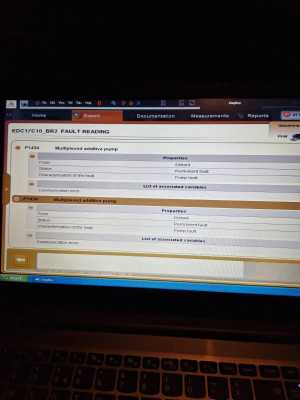

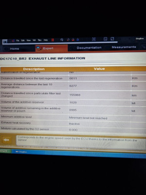

I recently purchased a 2012 citroen berling van. On refuelling for the first time I received the following message "risk of particle filter clogging". I've got a copy of diagbox and the diagnostics cable. On global test, I'm getting additive multiplexed pump - ecu not recognised. In the ECU I'm getting P1434 and P1435. Ive tried adding a replacement pump in the engine ecu, and you can clearly hear a ticking sound from the additive pump. I've not tried to delete the codes yet. Any advice would be greatly appreciated into the correct steps I need to follow. Diagbox version 7.62. Also been inspected by my own mechanic, who says the tank looks new and confirmed its full of liquid.

A little update. Connected diagbox and gone into the ECU followed by repair, replacement parts, pack repair. Then selected replacement of the additive tank, pump or pipes. When I switched the ignition on I could hear the pump. Tried to delete the codes, after entering mileage. Says not enough memory? Codes come straight back after a minute. Am I missing something?
- x 6957
Re: risk of particle filter clogging - berlingo van
You can't delete faults magically - if there is an underlying issue it needs to be investigated or the faults will just come back - that's what they are designed to do.
