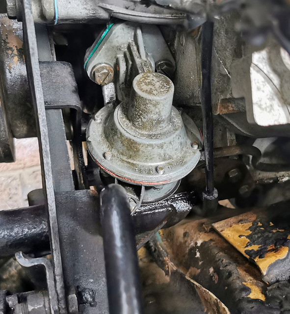

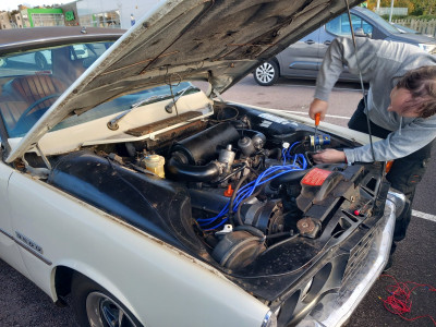

You know I called that fuelling fault resolved? Yeah...about that.
First thing today I wound up swearing at the fuel pump again as I discovered that it had been leaking overnight from the base gasket.

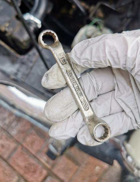

Thankfully it stopped once I got in there with a stubby wrench and got a little more tension on it. Without having to remove it from the car yet again. A job I am thoroughly fed up of doing!
Very useful tools shorter spanners.
Would definitely have had to remove the pump otherwise.

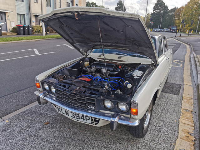

That "fixed" fuel pump has only gone and completely stopped pumping.
Previously when it was playing up I was still getting *some* fuel, so you could nurse it along even when it was acting up. Today, nope. Nothing. My guess is that I'm going to find that one of the valves has unseated itself when I pull it apart. That however is purely going to be to satisfy my curiosity, it clearly just doesn't want to live so that pump will shortly be getting chucked in the scrap metal bin. Not without a certain degree of vindictive pleasure I might say given how much time I've wasted on it.
Electric pump and blank off plate have been ordered, along with a few other bits and pieces from my longer shopping list.

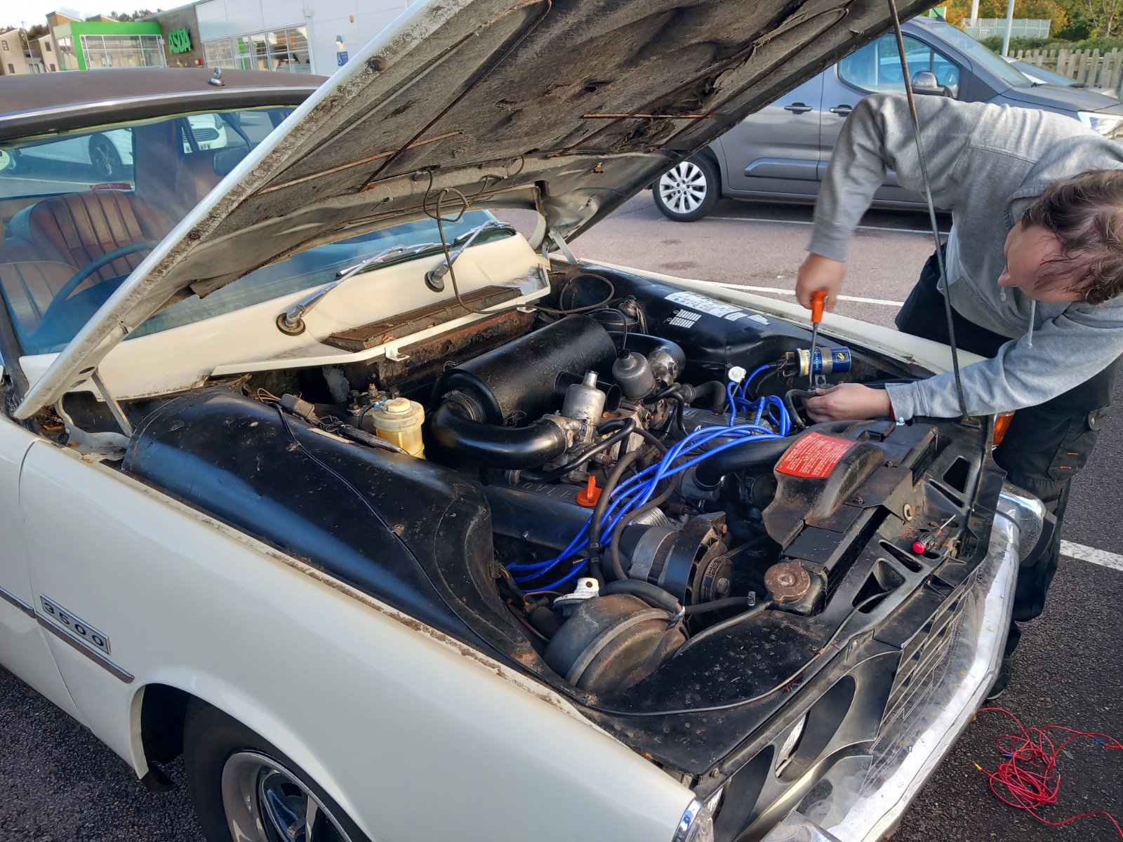

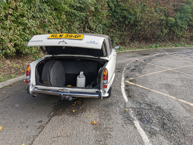

Thankfully Jim was able to bail me out, so salvation arrived in a Nissan Pixo and gave me a run back home (seriously, I was like five minutes drive away) to grab a couple of things to hopefully get me going again. Especially as recovery was estimating about two hours of a wait. Made it clear to the operator that we would be trying to get the car going in the meantime, and would call them up to cancel recovery if we were successful. I also asked for them to get the recovery agent to give us a call for an update before actually dispatching.
After we pushed the car out of the bus stop and into an adjacent car park to hopefully avoid me getting a parking ticket. Jim of course is sickeningly fit and didn't even look vaguely winded, it damned near killed me! We did however definitely prove that the brakes aren't binding as she rolls astonishingly easily once moving.

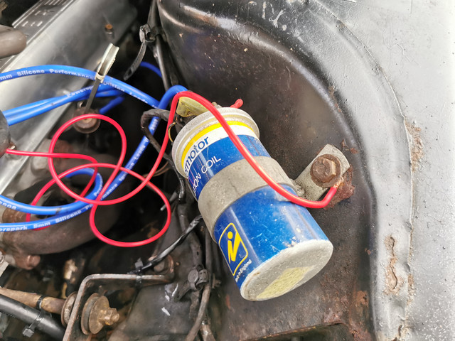

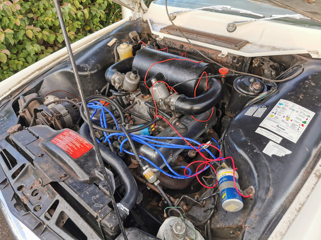

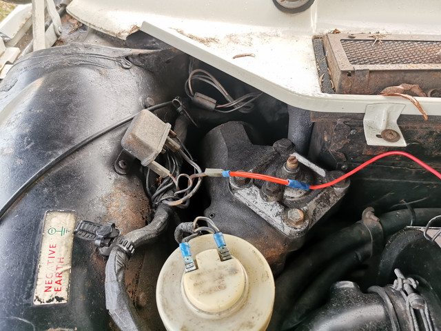

Grabbed all of the testing setup from a couple of days ago - which thankfully I hadn't reattached to TPA yet. One very quick and dirty get-me-home bodge was thrown together.
Power stolen from the starter solenoid supply (run pump to fill the carb bowls, disconnect, reconnect starter, start engine, disconnect starter, reconnect pump).
Ground sourced by loosening the coil mounting bracket bolt and squashing a wire under it.
The pump for all it looks precarious was actually pretty well wedged between the fuel lines themselves and the breather pipework so wasn't going anywhere - especially bearing in mind this was purely intended to last for the drive home which is all of five minutes. This is very much what you'd call a trail fix.
Horribly janky mess, especially using an unfused line from the starter solenoid, but it did get me home, the car not missing a beat the rest of the way.

May use that opportunity to drop the radiator off to be recored, will see how time goes. Or I may tidy this setup a bit more. Main thing I need to do is to get an ignition switched wire into somewhere accessible in the engine bay. There is actually surprisingly little wiring in the P6 engine bay, and very few accessible connections. As I mentioned in a previous post I really need to get a non-ballasted supply to the coil as well, so I may well end up running two new (fused) feeds for this purpose from the fuse box.
