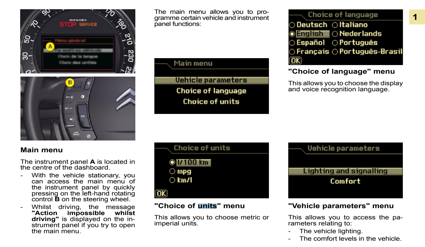

You obviously can't change the instrument cluster dials, but you can change the units on the associated panels for mileage / distance / economy etc.
You must ensure the car is at a standstill, then press down on the left had steering wheel scroll switch.
This activates the LCD menu and from there you can select the relevant option. It's all in your vehicle manual, but here is the relevant page:
Click to Zoom Image
