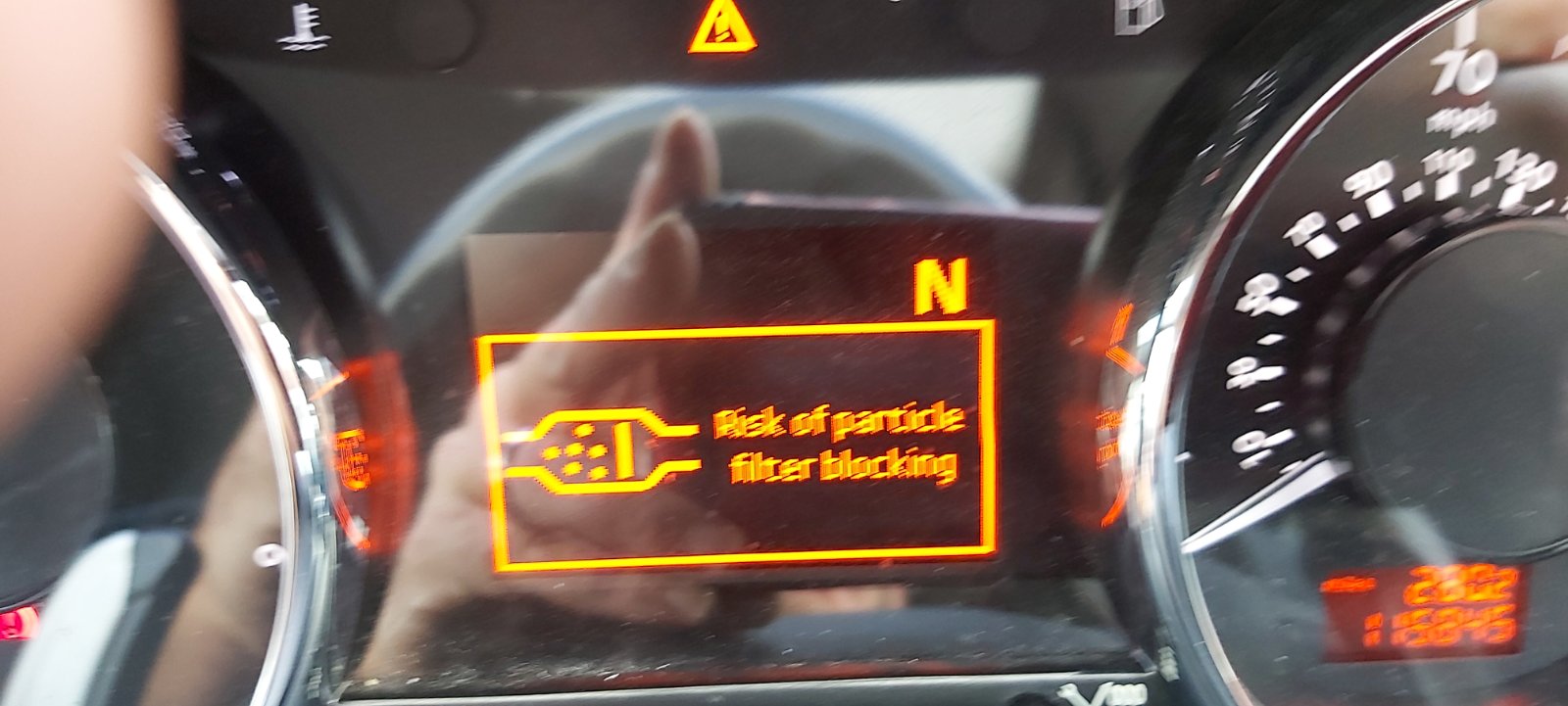

Quick question, my mum's peugeot 3008 1.6hdi (60 plate) has just popped up the risk of filter clogging message. I suspect the fluid is empty as it has 115,000 on the clock and has only done short runs since July. I took it for a run down the motorway for about 30 miles at roughly 70mph, didn't see any smoke out of the rear so I assume it's not got any dpf fluid left. Attached are pics of the warnings. Message pops up briefly (still shows when pressing spanner button on dash) and the triangle stays on all the time (did go out at first but not now).
If fluid has run out, is it worth adding redex dpf cleaner to the tank till I can get it to my mechanic
I don't have the computer gear to do it myself
Thanks

Hi, no, this is not the additive warning message - which you will get if the fluid is low and there is insufficient fluid remaining to cover the mileage to your next due service interval as per your maintenance indicator.
This means that the particle filter is at risk of blocking. The system uses passive regeneration (when travelling at motorway speeds) or when the exhaust gasses reach 550°C where regeneration of the particle filter will naturally burn of the particulate matter. At lower speeds where it does not reach such temperatures and starts to clog, the assisted regeneration is initiated by the engine ECU that means the exhaust gas temperature only has to reach 450°C to regenerate the filter.
That being said, where journeys are of particularly low mileage and of short duration, the engine barely has tome to warm up, so even assisted regeneration may be impossible - especially if the process does start but gets interrupted when the engine is switched off.
Although the engine ECU has strategies to deal with this, sometimes it is just not possible if the process is constantly interrupted, at which point the warning you have is displayed.
The recommendation is to go at least 40 mph (and try to stick in a lower gear for a while) to aid the engine getting to temperature for an uninterrupted journey of about 15-20 minutes to allow the engine ECU a chance to regenerate the filter.
Be warned that if left too long and the filter gets any where at 70% full or more that regeneration may fail as the filter will be too blocked, which will necessitate removal and cleaning.
I would not add any DPF cleaners or other additives (Citroen actually state this) to the fuel tank.
The additive level would normally be checked at the dealer's servicing schedules at certain mileages (usually about 70k miles, but depends on engine and vehicle), so if it has not already been topped up, would be worth getting them to check. Of course if you don't have it dealer-maintained it would likely never be checked unless specified.

Re: Risk Of Particle Filter Clogging
Sound thanks Marc.
I will take her car out for a good run on the motorway again.
Am I to expect smoke out of the exhaust if it is regenerating the filter, or will the light just go out once the car is happy

You shouldn't really see anything coming out of the back except possibly a slight haze. What you might notice is the heated rear window and heated door mirrors in operation as this puts extra load on the engine to encourage regeneration. Some people have fitted a small LED across the heated element in the door mirror casing which then glows whenever regeneration is taking place.

My guess at those miles is that the ECU has decided the filter is end of life (full of ash). It almost certainly isn't however, and as long as the pressure is OK, then you can just tell it it has been replaced and it will be happy. Needs Diagbox or other decent scanner however... Where are you?
