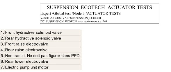

When I said comms errors, I do not mean Vehicle to Laptop, I mean then errors I running the diagnostic session, for example, yesterday I have a suspension fault, cleared the faults I run all the actuator tests perfect, then another global test, not a suspension fault but the ESP/ABS text was in red, saying communication error, so I run another Global test, without doing anything, and all fine!!
Just another question why did I see this "Non traduit. Ne doit pas figurer dans PPD" which translates to "Untranslated should not be in PPD" Glitch!?
