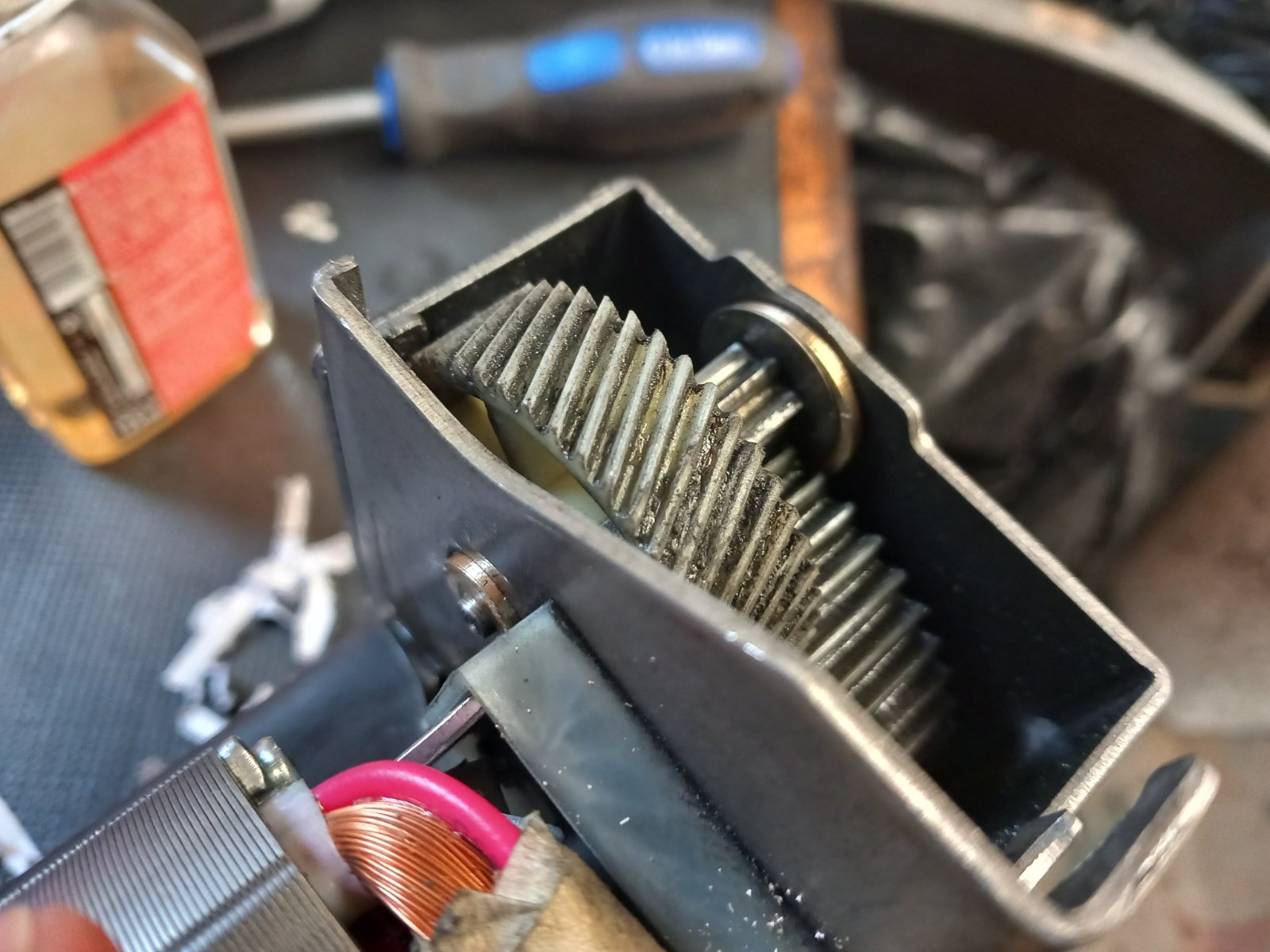

Briefly, Mick procured three shredders very cheaply and all had badly worn nylon bearings in the gearbox which caused the gears to jump right out of mesh. I turned up a pair of new bearings, one made of bronze and one of aluminium, on my lathe... All details are upthread if you care to look...
Anyway, the bronze bearing was OK but the aluminium one - only a test one - failed after a few bags of shredding... Looking at it, the bearing had worn a little but it had really chewed up the axle... Because aluminium oxide, which would have formed, is very hard and abrasive... A real schoolboy error to make a bearing out of aluminium!

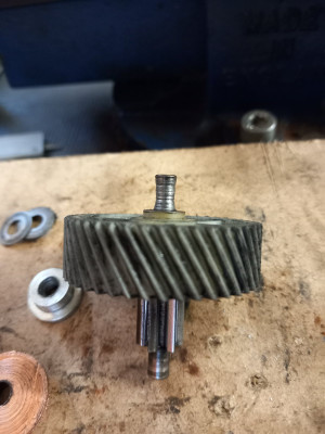

This was the axle damage:

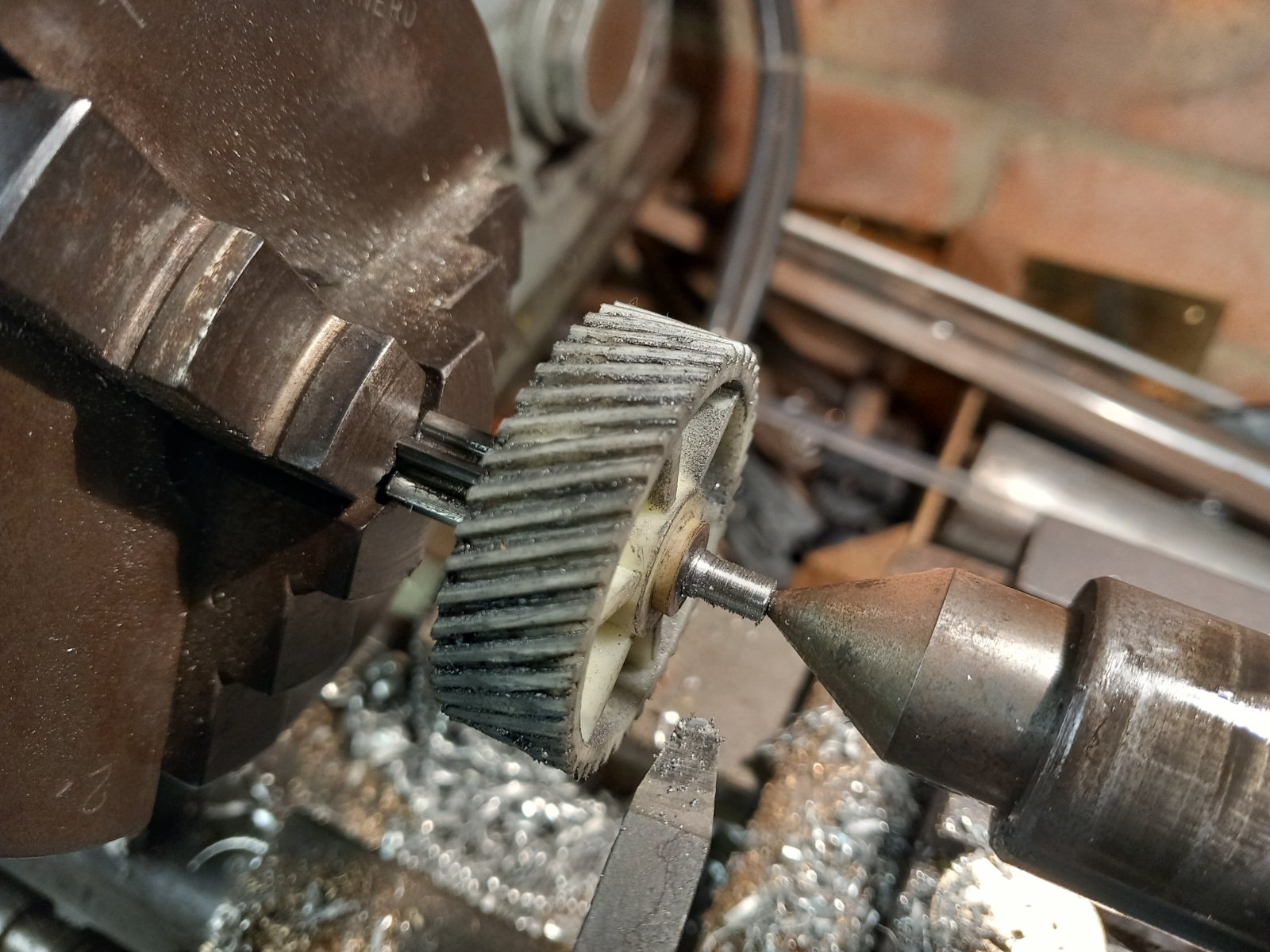

I trued the worn axle up on the lathe and reduced its diameter from 5mm to 4mm

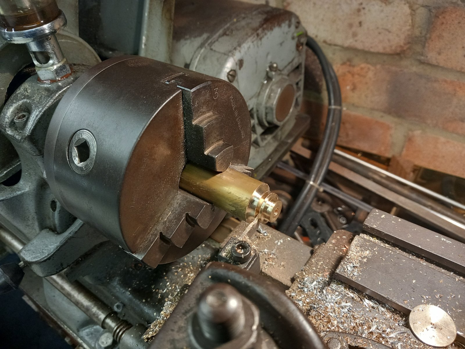

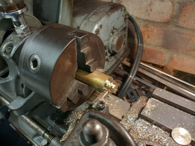

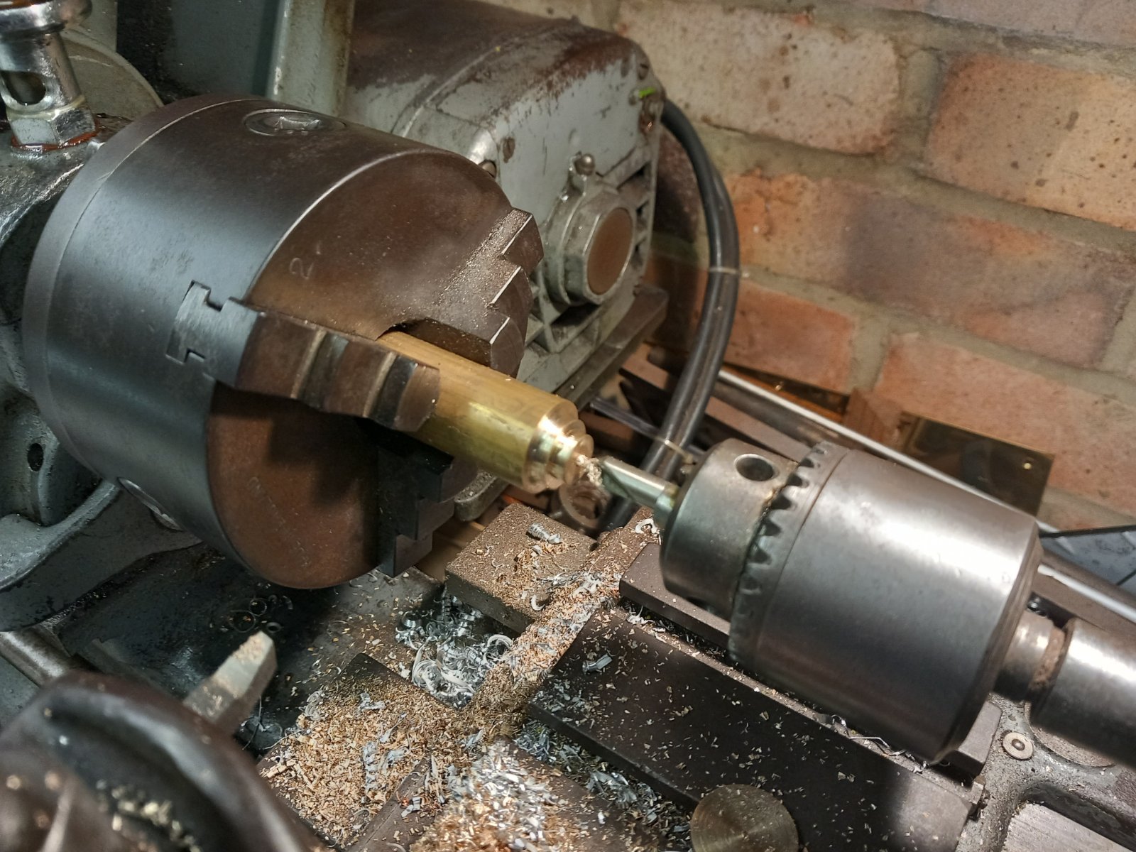

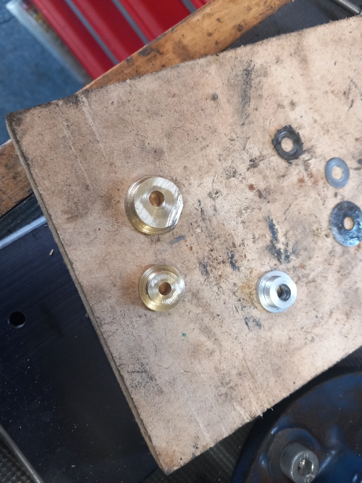

I made two new bearings out of brass. I know brass is OK for bearings as my clocks have steel axles running in brass and they've lasted over 300 years!
Testing the fit of the trued up axle...
The new bearings and the old aluminium one...

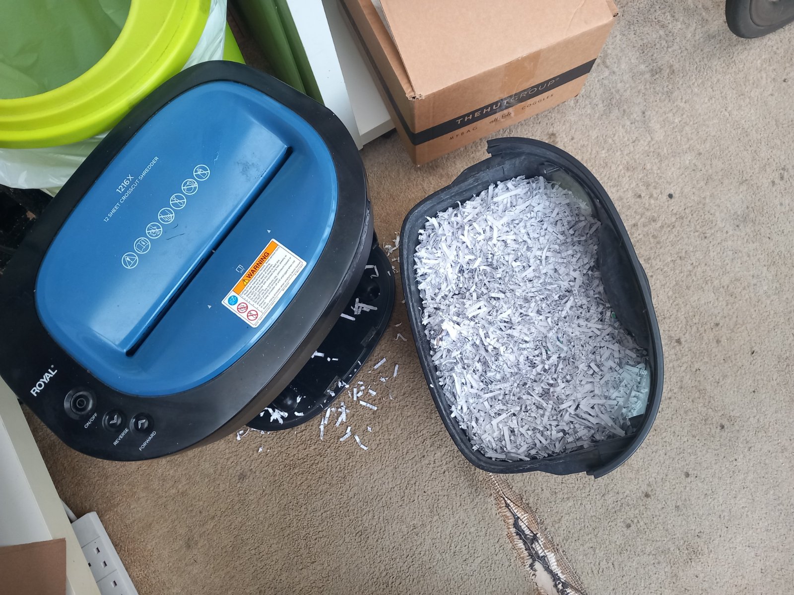

And the result of some testing
I have now shredded enough to fill a large sack and so far, all looks good

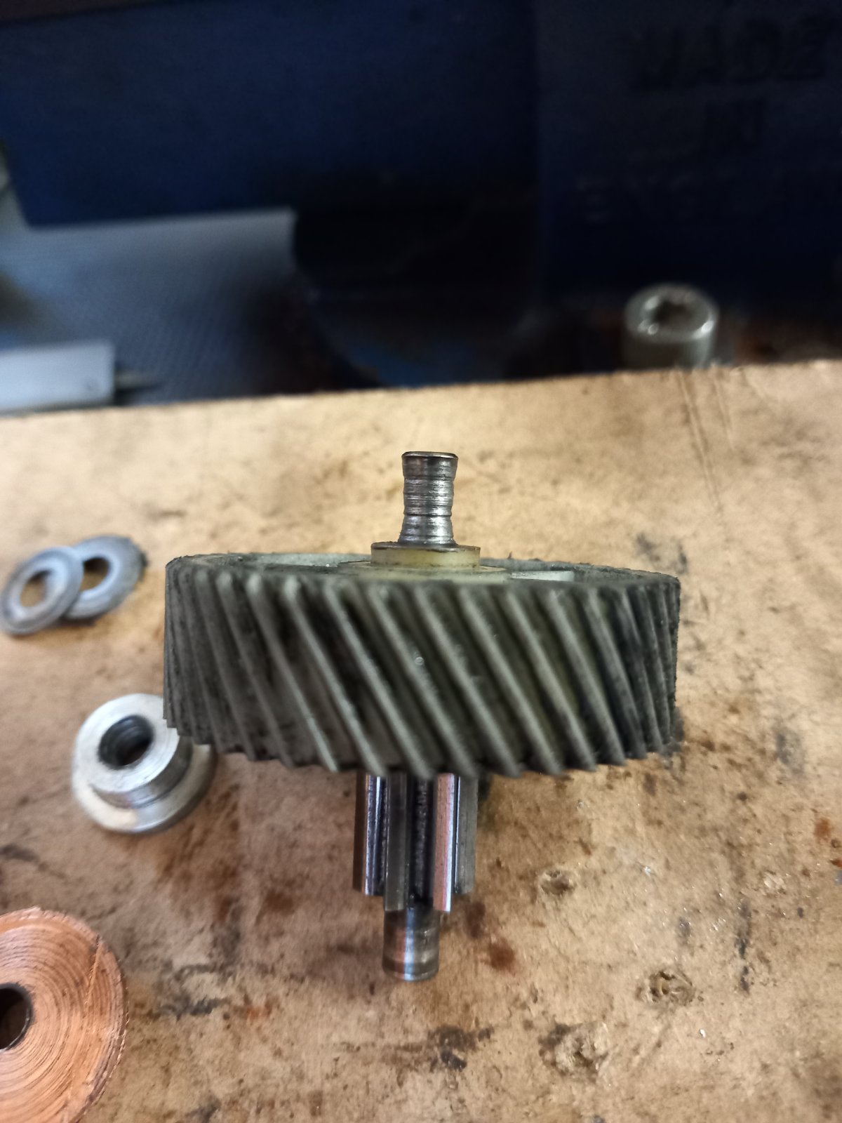

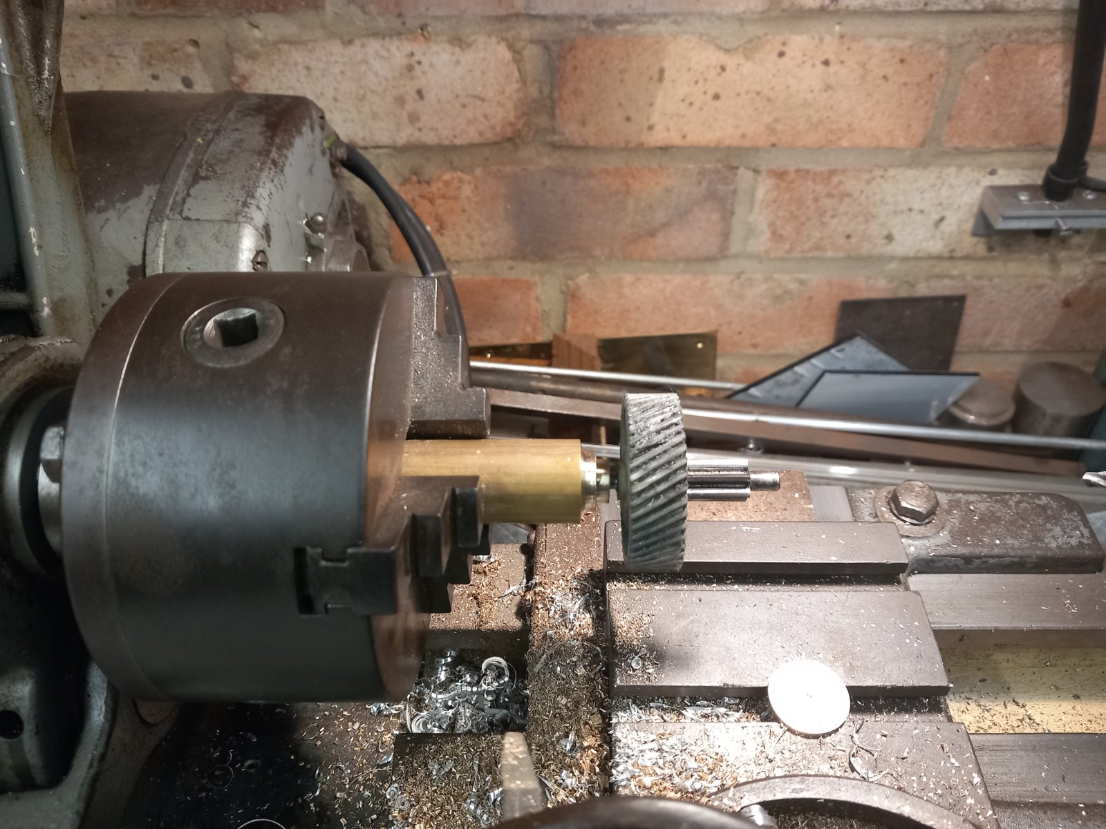

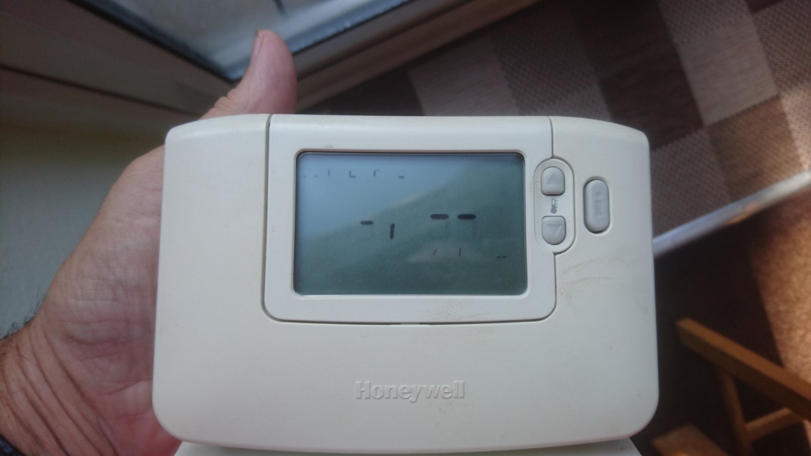

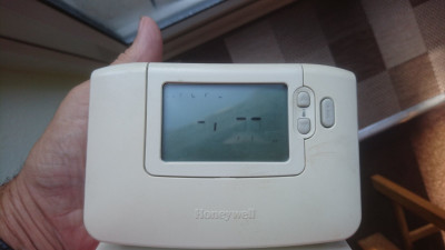

I came downstairs this morning and decided it was definitely on the chilly side so the annual switch on day has arrived. I went to the heating controller to be greeted with this:
Hmmm!! not good!

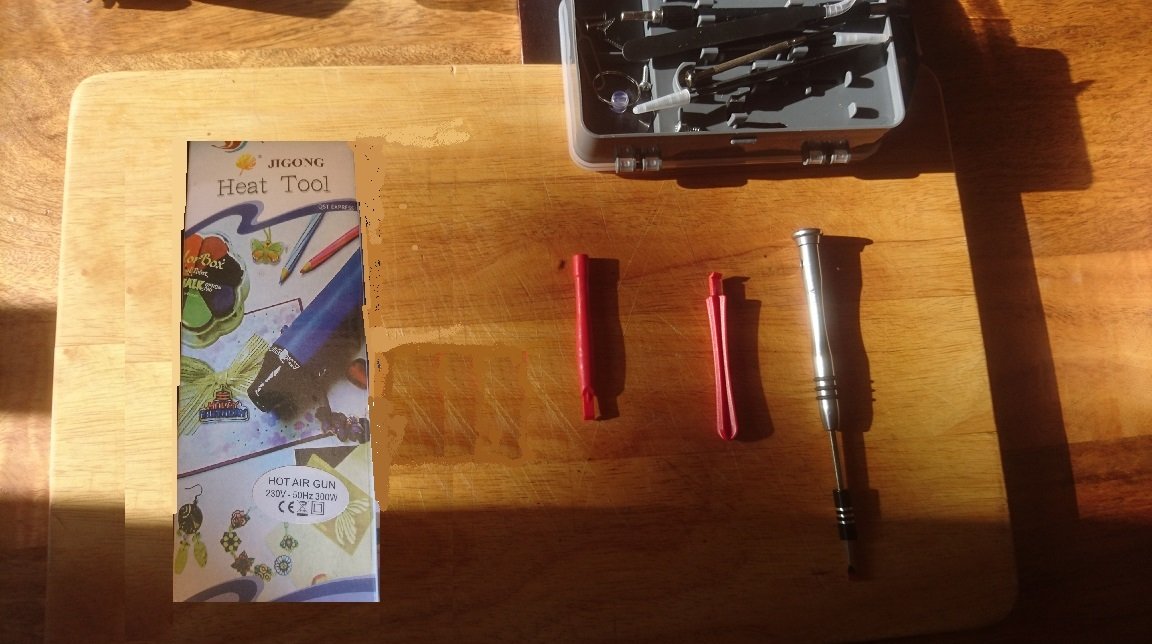

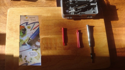

As it is made by Honeywell I wondered if it suffered the same poor quality assembly methods as I have found on other Honeywell LCD displays in the past. The LCD module ribbon cable is often connected using adhesive rather than solder/pins etc, presumably for cost saving reasons so I assembled the necessary tools to rectify it:
At this point you can moan at me for forgetting to take pictures during the process. However what was involved is fairly simple on most Honeywell controllers. You remove the outer casing by releasing clips, no screws involved, and then remove the circuit board, more clips and the 8 pin plug to the display. Then you have to extract the display from its clear plastic case by releasing another plastic clip and gently lifting the display out. At this point you can open the display from its backplate with the ribbon connector being the hinge. It is then a matter of heating the ribbon adhesive connection to the display and pressing it home, I do that two or three times usually using the edge of the glass case to press the full length of the connection evenly. Finally reassembly is a simple reverse of the dismantling with each part clipping back into its place with nice crisp clicks!!

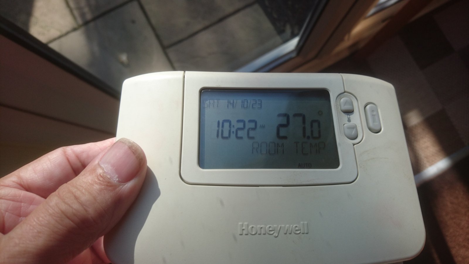

Et voila:
Easy job and much better than replacing with a new one costing £99

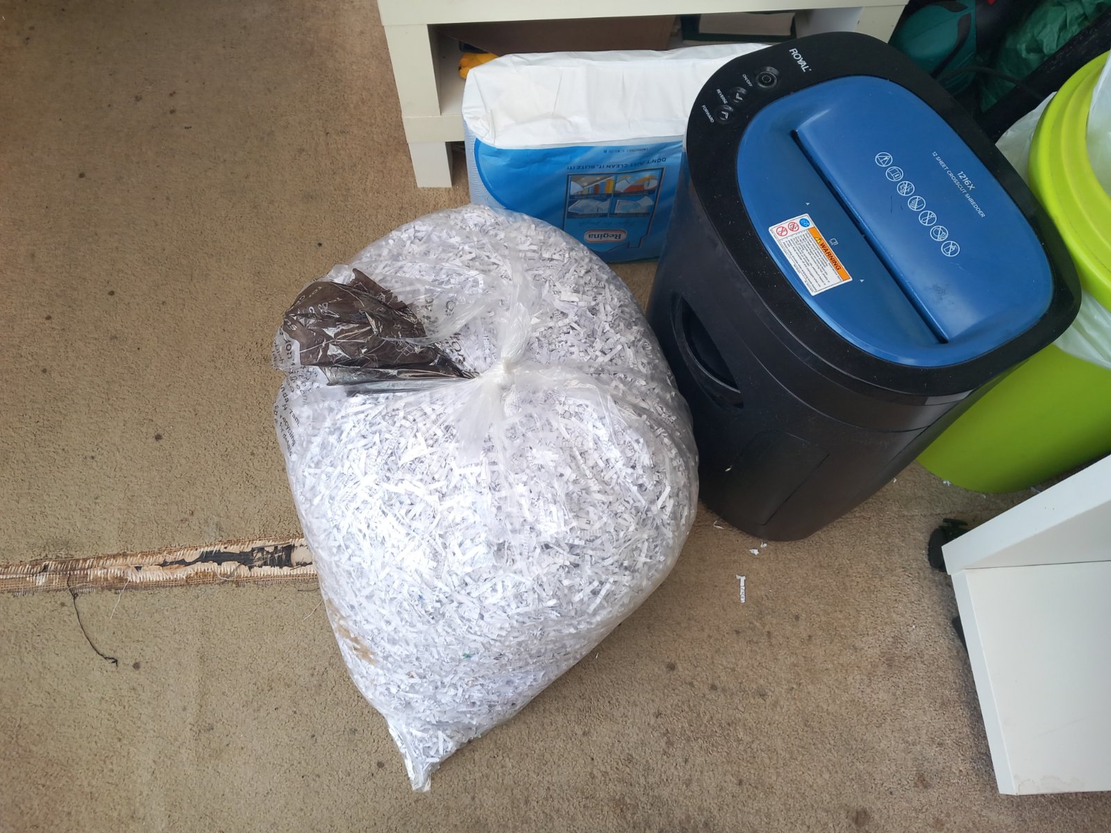

And the shredder continues good... This is the remains of a massive pile of old bank statements
