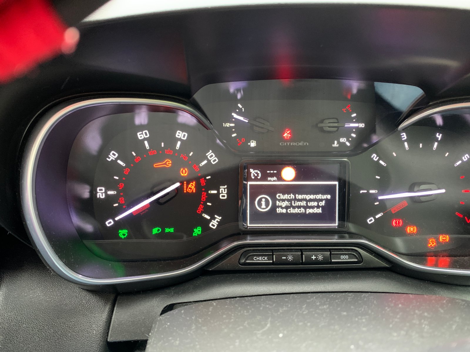

As it happens, today was taking a friend to the surgery and on the way back the Aircross went ballistic! All ESP functions disabled, multiple messages and then clutch overheating message came on - telling me to decrease use of the clutch pedal! Then I thought I had an issue with the screen, as that went from CarPlay to navigation - which I thought oh no, another issue, then realised it was trying to navigate me to the dealer!
Rang them up and earliest they can book it in is 2nd October!, but have booked me a car for 4 days. I think the clutch issue is a software update according to the tech and I confirmed after the TSB for that, but likely an ABS rear wheel sensor has become contaminated / damaged for the ESP issues - we shall see.
- x 6945
Re: Marc's X7, C3 Aircross, Rants, Raves & Everything Else
Yes indeed Jim, but the funny thing is that the dealer couldn't book me in for 2 weeks, so that would of been a bit daft - apparently nobody told the Sat Nav that the dealers are chockers everywhere at present.CitroJim wrote: 20 Sep 2023, 05:35 Good luck both on resolving your issues... So, let me get this right... If a fault develops the navigation system take over and directs you to the nearest dealer?
I like that!
I went out yesterday 2 times to start the car to check on the errors (car had not been started since we got back after the initial journey) and sure enough the same errors including the overheating clutch warning still kicking in and the engine fan on full blast.
So that being the case, it would suggest that whatever sensor is monitoring the clutch temperature must be faulty, as well as needing a software update on the engine ECU. Thankfully (and hopefully) extended warranty will cover it and whatever is causing the ESP system faults. We have to go out for supplies today, seeing as the oven was delivered yesterday (which did not fit properly) so we can start cooking again.

Pretty sure there is no clutch temp sensor - my guess is that checks the engine speed vs the road speed and if there is discrepancy between what it is seeing and what it is expecting it assumes the clutch is slipping and will overheat. Since you have an ESP fault, you will Probably find that one of the wheel sensors has gone gaga and is reporting the car going fast and the clutch speed doesn't match.GiveMeABreak wrote: 21 Sep 2023, 10:20

Good point there - they told me it's a known issue (and a TSB for it confirms) and needs a software update for the clutch temp warning. I've been flat out yesterday so haven't even had time to investigate the system yet, so will spend a little time looking at it this morning. Good luck with the Pic!

Yes, you're right there Richard, seems it's all estimated:RichardW wrote: 21 Sep 2023, 10:26 Pretty sure there is no clutch temp sensor - my guess is that checks the engine speed vs the road speed and if there is discrepancy between what it is seeing and what it is expecting it assumes the clutch is slipping and will overheat. Since you have an ESP fault, you will Probably find that one of the wheel sensors has gone gaga and is reporting the car going fast and the clutch speed doesn't match.
Engine management ECU operating strategy that calculates the temperature of the clutch friction plate:
Estimated temperature of the clutch at 350°C: Activation of the cooling fans at 50%
Estimated temperature of the clutch at 370°C: Activation of the cooling fans at 100%
Estimated temperature of the clutch at 400°C: Display of the message
So probably all related to the ESP issue. Hopefully a quick fix in that case if a wheel speed sensor. The issue I have at present it that my diagnostic laptop is a little too old so doesn't support virtualisation, so I can't run the VMware version of Diagbox V9.** presently, so can't diagnose it myself or see what the ESP fault is!

So update on my car's issue:
Initial problem started on a journey:
So for those interested:
Because the ESP system now doesn't know the speed of the vehicle (moving), against the engine speed, it thinks the clutch is slipping and therefore (as Richard mentioned there is no actual clutch temperature sensor) it puts the engine fan on high speed to cool it down. So I now sound like I'm arriving everywhere in a private jet.
Obviously any fault in the ESP system and all cruise control and ESP functions are disabled.
But because the engine fan is permanently on high speed, the A/C switches off, which it does when it thinks the cooling system temperature is too high.
Because of the ESP issue, the Auto Parking system can't determine if I'm going backwards or forwards and what the speed I'm doing is, so can't manoeuvre and disables that system.
Ditto for the Tyre pre Pressure Monitoring - as it can't measure and monitor each wheel speed and compare when one sensor is out, so disables monitoring of tyre pressures.
Lastly, because of all the faults, the Sat Nav automatically switches on and sets a route to my nearest dealer! Shame it doesn't know that they couldn't book me in for a week though!
So I wanted to show an example of how one simple sensor can cause so many other things to malfunction.
Off to pick my car up now and return the new C4 (C41)e with EAT8 gearbox that I have to admit wafts along the road with as near as good a ride as my X7 had and soaks up all the bumps! Incredible system without all the hydraulics.
- ESP Fault
- No Hill Start Assist, no Descent Control and no ESP functions at all
- No TPMS
- Clutch Temperature too high warning, resulting in engine fan on high speed constantly and permanent beeps and warnings to limit use of the clutch pedal.
- No Air Conditioning
- No Cruise Control
- No Self-Parking Assistance
- Sat Nav wanting to take me to the nearest dealership (!)
