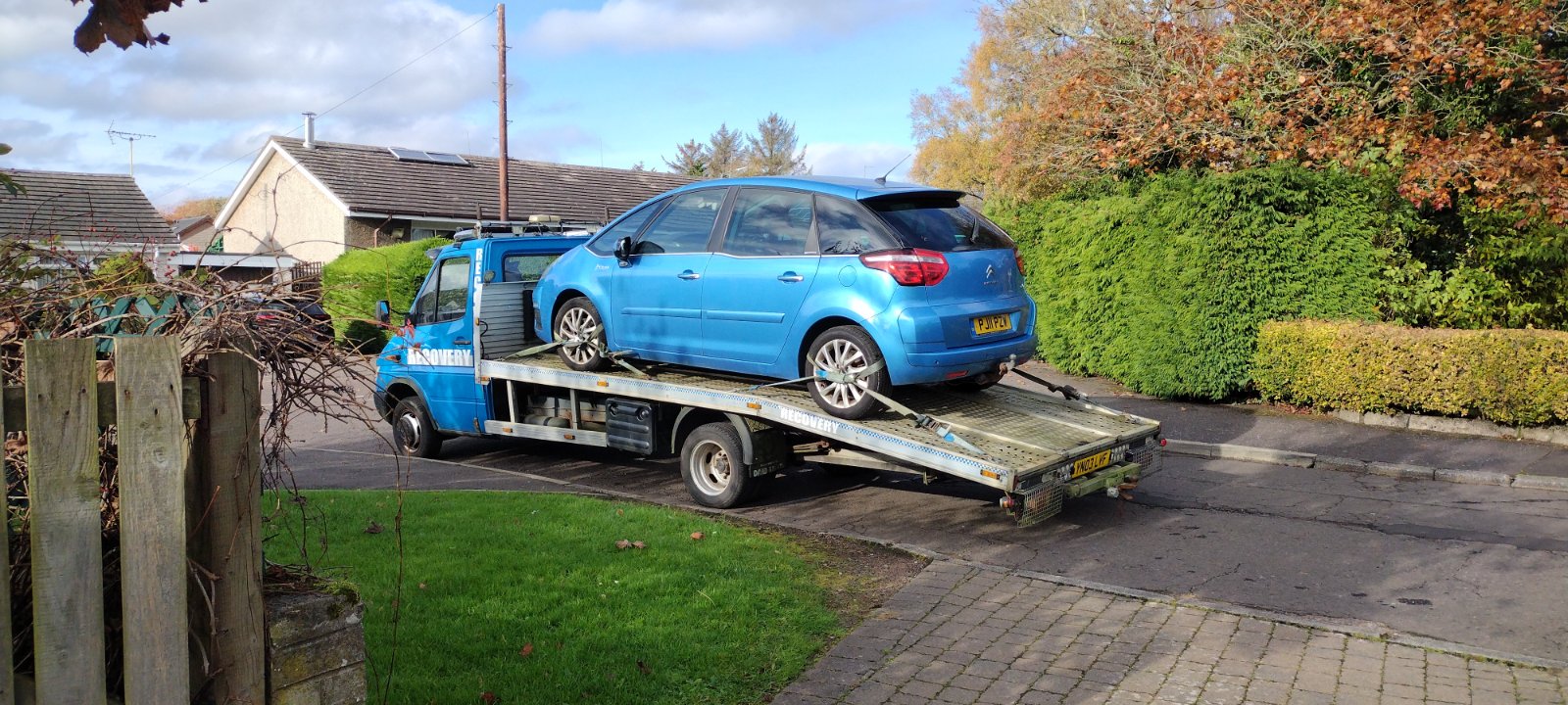

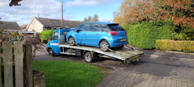

My Sister's 2011 1.6 DV6C EGS. 'Box has thrown a wobbly, was failing to engage gears and then dropping out of gear. Now it won't do anything (i.e. start!), and is stuck in reverse. Diagbox reports P1755 - Clutch position fault - and it's permanent, and came right back after I deleted it. There were reports of some mechanical noise, but not sure what. 107k miles, still on original clutch. Can't even move it as it's in reverse and the clutch is engaged. I'm wondering if I depressure the actuator if that will release it into Netural... nothing to lose I suppose. Googling the fault doesn't seem to turn up much concrete, maybe low oil level (although there is no real evidence it's leaked out, and it was reading 40bar on diagbox), or maybe poor connection on the actuator connections. However, my guess is it needs a new clutch at least, and then there is a question over the actuator - I think it might be time for bean tins.... Her son turned 17 last week, so she was thinking about changing to a manual - this may just hasten things, but has rather devalued the C4
Beached C4 Pic EGS

Beached C4 Pic EGS
Not mine, but it is outside my house!!
