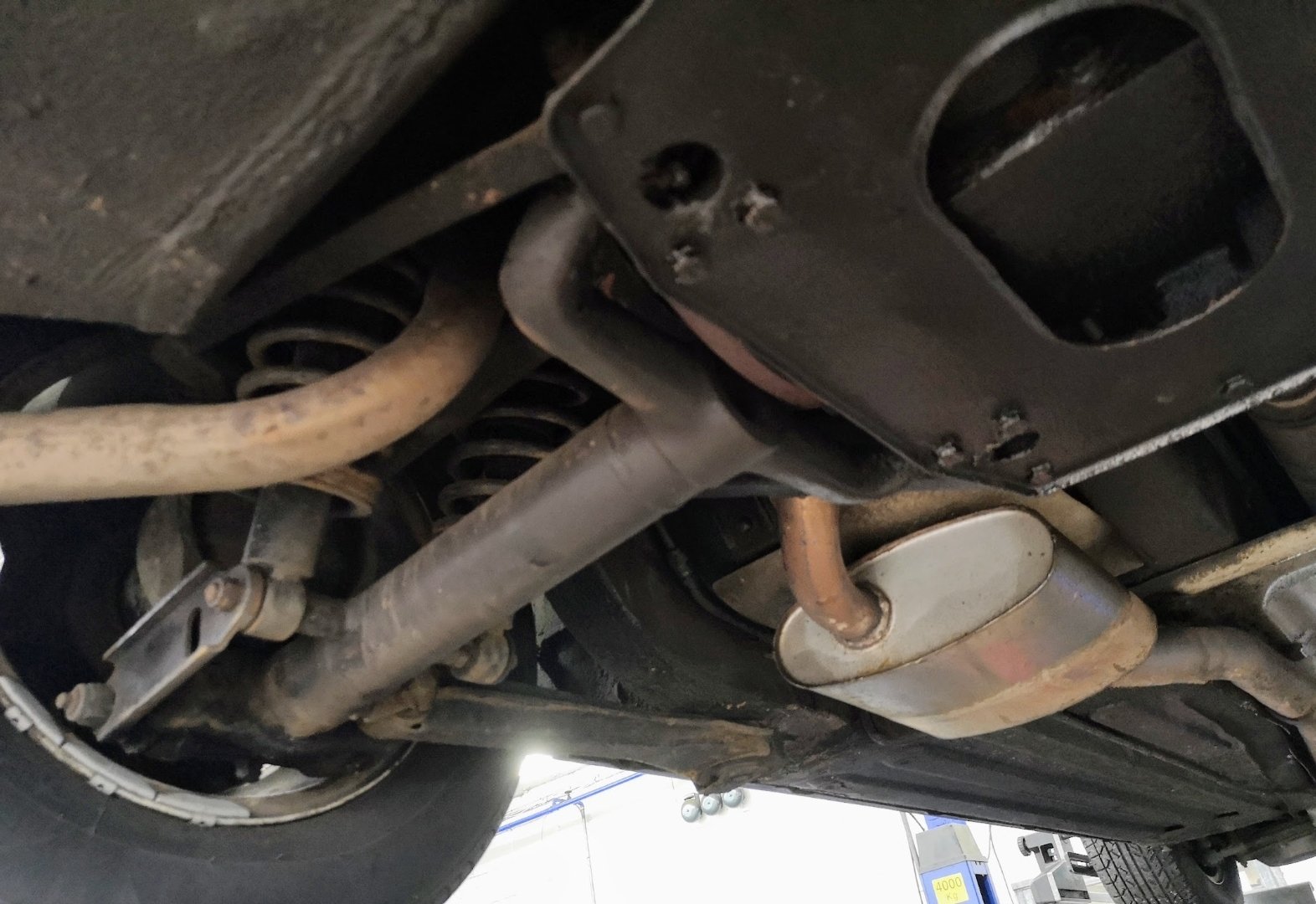

Here's what you can see of the Jag ones...with it on a lift.
See also step one when doing any job on an XJ-S - Dismantle the entire car first.
