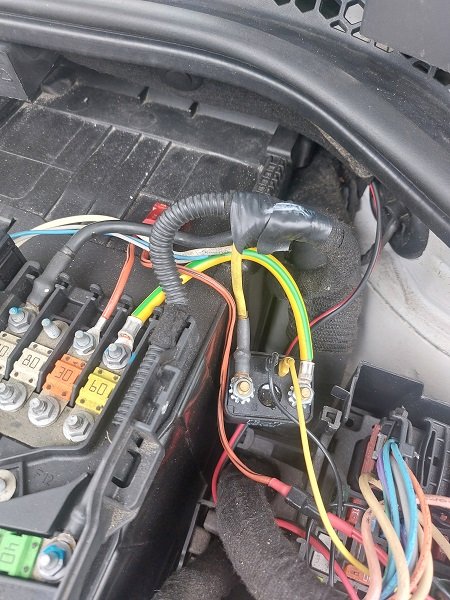

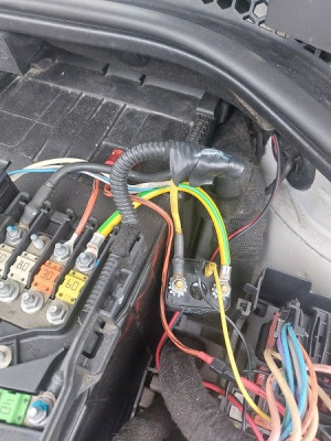

I had both. Don't kill me but, because I had the fan always on, I connected a relay with a small remote control :oops:

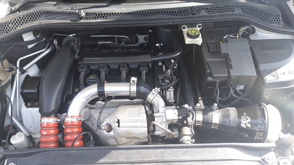

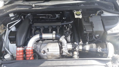

A question, the leak can only be after the MAP on the intake manifold right?
I don't have a MAF sensor after the air filter. Only one sensor on the hose after the intercooler and one on the intake manifold.

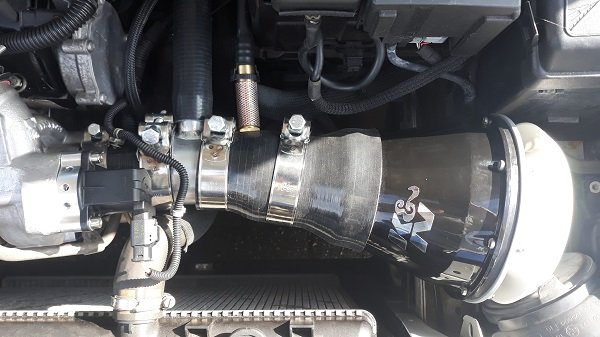

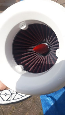

I have also a "strange filter" :lol: and a oil vapor catch cannister on the right side. Can this cause the leak error?

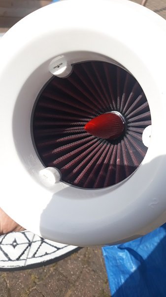

You've obviously made some 'modifications' by the looks of that aircraft jet engine attached!
I can't really help you as making any modifications like this can cause issues with the engine management system which is designed to work within set parameters. Modifications to components can result in the air/ fuel measurements being incorrect and throwing errors - like your modification to set the fan speed on high...
Not much I can help you with as these will introduce another level of issues to resolve.

The vacuum leak can be anywhere after the throttle butterfly (inclusive). If the breather pipe from the manifold to the engine cover is still present (often blanked off when a catch can is fitted), then the leak could also be in the breather system or engine cover.

Now I have the oil catch can only on the right side (rocker cover --> intake turbo). I had another one on the rear (rocker cover -->intake manifold) but I removed it 2-3 months ago so original configuration now. Still not really clear for me what is the best configuration. Read so many variations of this topic that in the end I really don't know :lol:

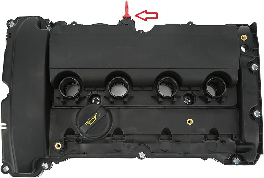

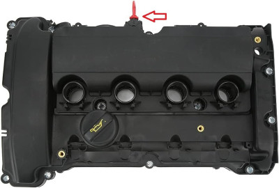

I replaced the rocker cover one year ago, the previous one was leaking oil. Question about the rear small hole: what is it? The red plug should be removed right?

Most of the oil vapour which ends up as carbon on the intake valves comes via the breather to the intake manifold, so I don't think that your current configuration is ideal. for the purpose of eliminating possible leaks, you could temporarily blank off that path. The downside to blanking it off is that the crankcase is no longer kept at negative pressure and any tiny oil leaks suddenly become obvious.

Just curious, do you know what is the small hole on the back of the rocker cover?

On a standard engine, the rear PCV path operates when manifold pressure is below atmospheric, and the front PCV path operates when manifold pressure is above atmospheric.
I am not sure where the crossover point is while driving, but I think that manifold pressure is below atmospheric when cruising at any legal speed.
There is a partial explanation of the red tab at: https://www.ecstuning.com/b-bremmen-par ... 46555~brp/

I checked the old rocker cover that I replaced and the small hole on the back is open. How is it on your 308CC?
Posts: 10864
Joined: 09 Nov 2005, 22:03
x 1415
Re: PSA electronic thermostat operation
Unread post by xantia_v6 »
I think that it is also open, but I can't check now because I am in a different country than the car.
