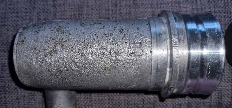

Is there any markings on this that would tell me wich side it is for? Seller doesnt know

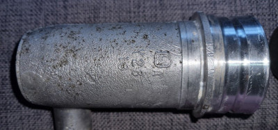

Just checked, mine (Left rear) says Y28 16 his says Y28 18. does this mean it's the wrong side and therefore won't fit ?

Re: Leaky suspension ram C5 mk1
Right and left spring cylinders are basically identical.
Only the mounting flange has to be turned and the spring clip moved so that the connections for the hydraulics and the mounting fit.
The only difference is the diameter of the LDS connection and on older vehicles there are 37mm pistons - otherwise 40mm pistons.
If everything else fits, an incorrect piston diameter is the lesser evil.

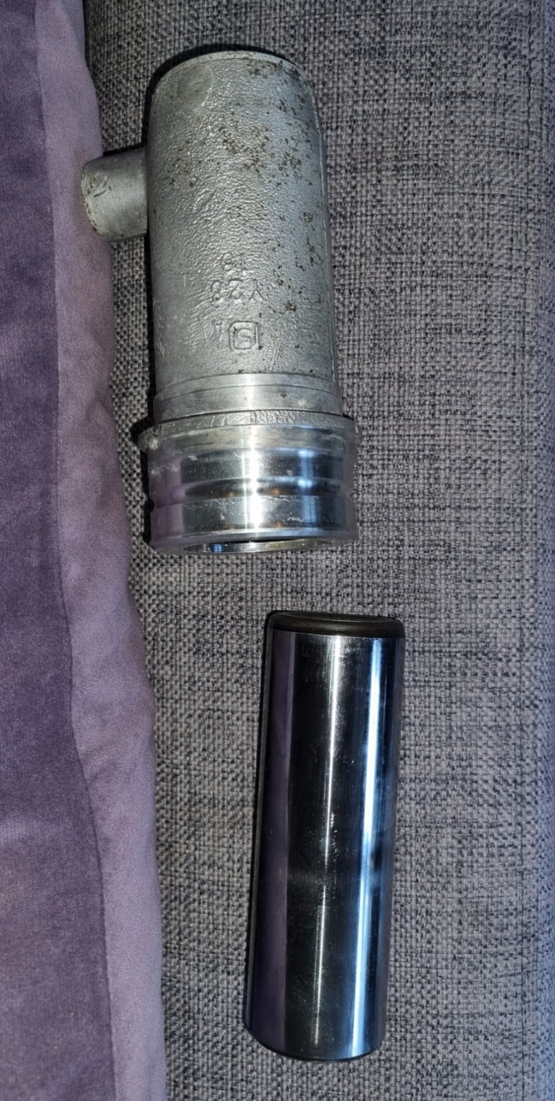

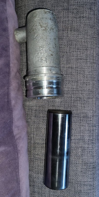

So i got the Cylinder replaced now, the "hole" was actually not a hole but a pit in the cylinder, i suspect the leak came from the fact the boot had slipped forward a tiny amount.
