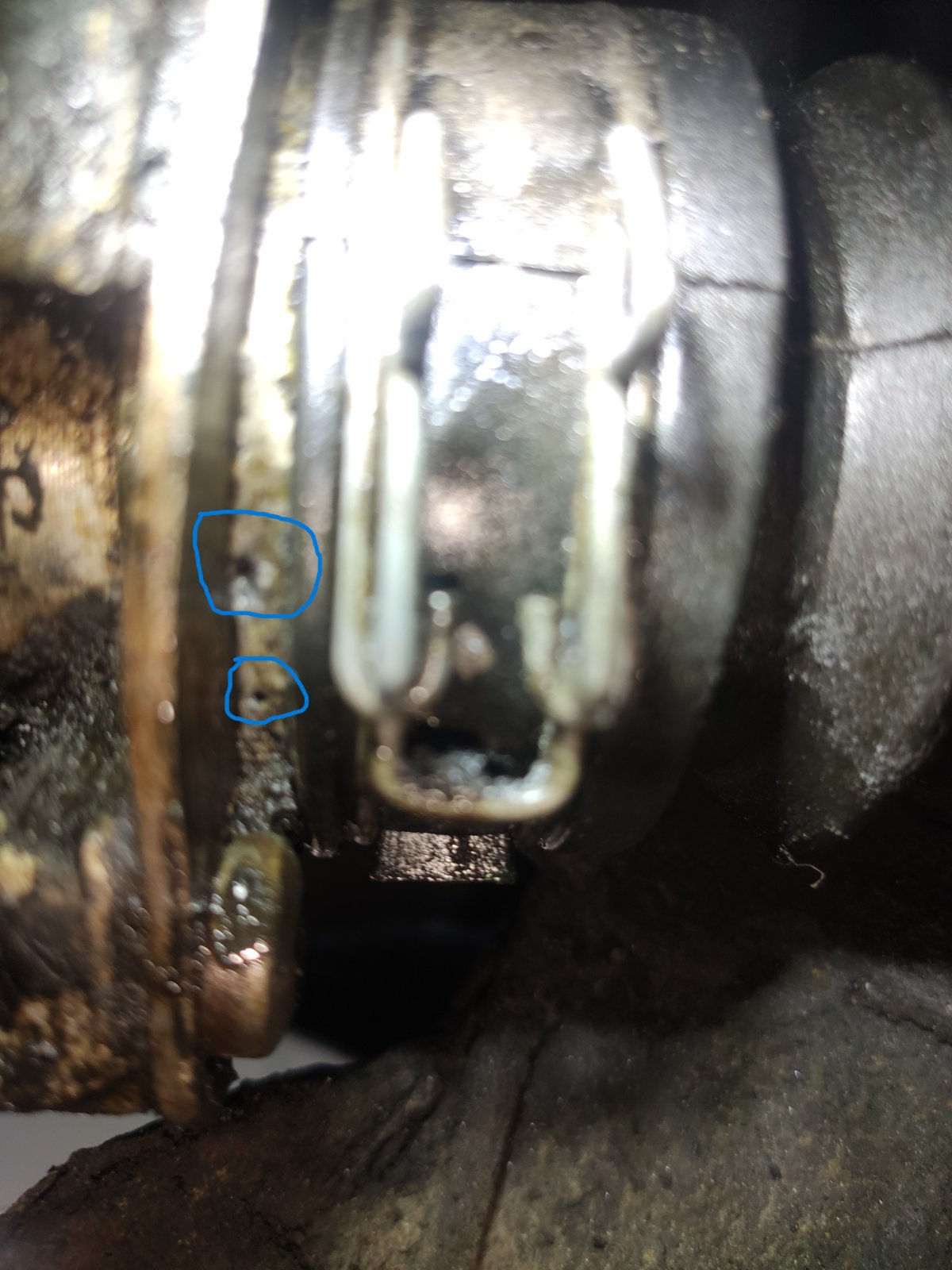

so recently I started noticing that one of my rear suspension rams/cylinders was starting to drip LDS fluid on the ground. looking around previous posts I figured this was probably a leaky boot.
got the car jacked up today and cleaned up the boot but found no tears, however... I found that where the boot is clamped to the cylinder there has been enough corrosion to where there are small pin holes in the bottom of the cylinder, safe to say this is the culprit...
has anyone successfully welded these or am I just making it harder to replace the thing when it eventually starts leaking again?
seems like these cylinders aren't that easy to come by, not new at least.
i have temporarily patched it with some two-part "chemical metal" , but don't expect this to last

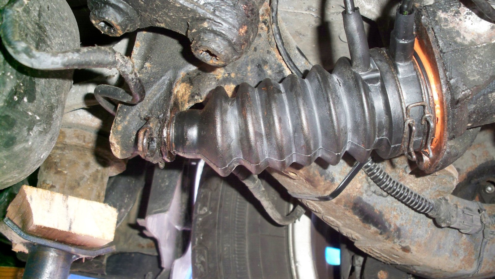

Yup, had that! No point in trying to obtain a new ram. I achieved a fix using a fuel resistant sealant (I used Loctite 5920 copper silicone gasket), making sure the fluid groove is not blocked. The LDS inside the boot is low pressure so the sealant should hold. I did mine last year for an MOT and it has lasted without a sign of a leak. Indeed, many years ago i did the same on both front struts when they started weeping.
I have produced an illustrated "how to" pdf. PM me if you want it.. I produce such guides every time I do a repair and would publish them on the website as pdfs if permitted.
