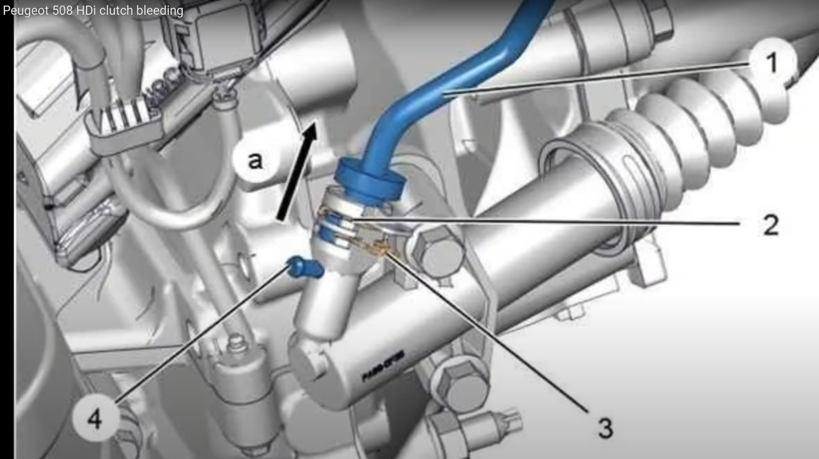

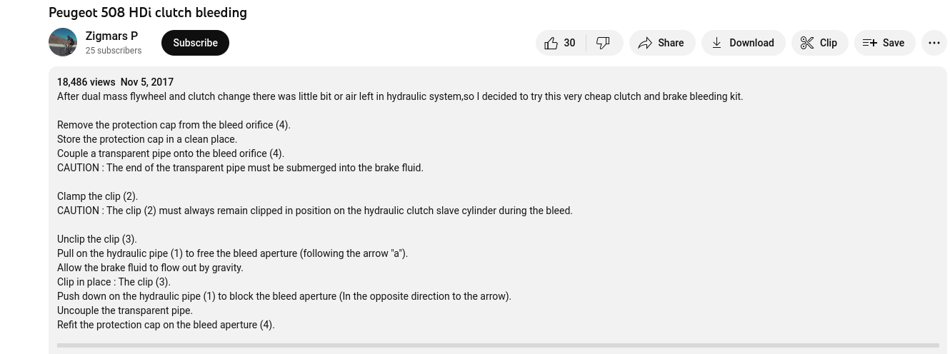

On returning from holiday, the biting point had dropped a couple of cm, almost to the floor, so I set about bleeding the clutch (a few years overdue!)
Following the attached guidance and using an EasyBleed connected to 15psi, I have bled the filthy fluid from the line, but the biting point remains almost at the floor.

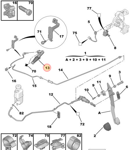

In case you want the official Clutch Slave Cylinder Part, see below. I only supply official part numbers, not aftermarket compatibility / cross referencing, but you can use the official part number to source an aftermarket part from this should you wish.
(13) Clutch Slave Cylinder, part: 2182J5, £79.49
