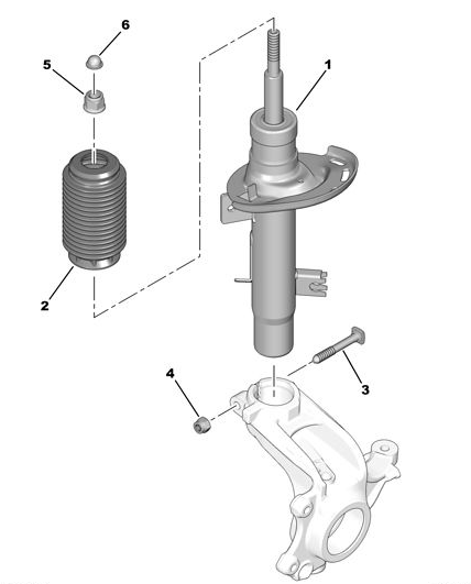

Need the service assembly manual with the tightening torque value of the front shock. More specifically the shock absorber assembly and direction.

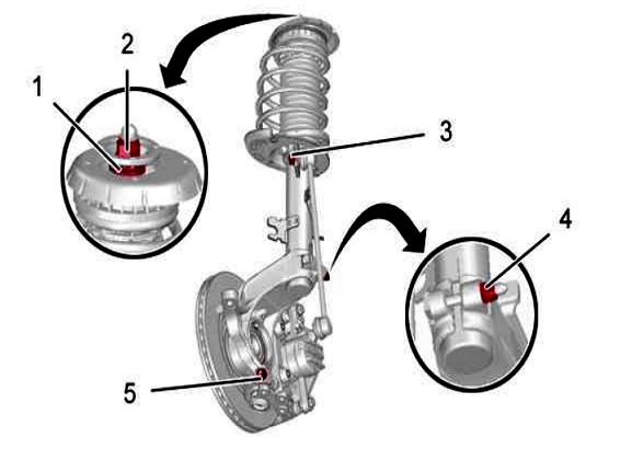

We don't supply manuals, but here is the front strut diagram and the tightening torques:
Tightening Torques:
(*) Always to be replaced whenever removed
CAUTION: The "Low Friction" bolts (or nuts) (1), (2), (3) are only for single use and must always be replaced. All re-use is prohibited (risk of breakage). The bolts (or nuts) removed must be thrown away.
Tightening Torques:
| Reference | Description | Tightening torque |
| (1) | nut (Damper upper cup) (*) | 7,5 da.Nm |
| (2) | nut (Suspension strut / Body) (*) | 7,5 da.Nm |
| (3) | nut (Anti-roll bar rod / Damper ) (*) | 4,3 da.Nm |
| (4) | Bolt-nut assembly (Suspension strut / Pivot) (*) | 5,5 da.Nm |
| (5) | Bolt-nut assembly (Front pivot lower ball-joint / Pivot) (*) | 4 da.Nm |
