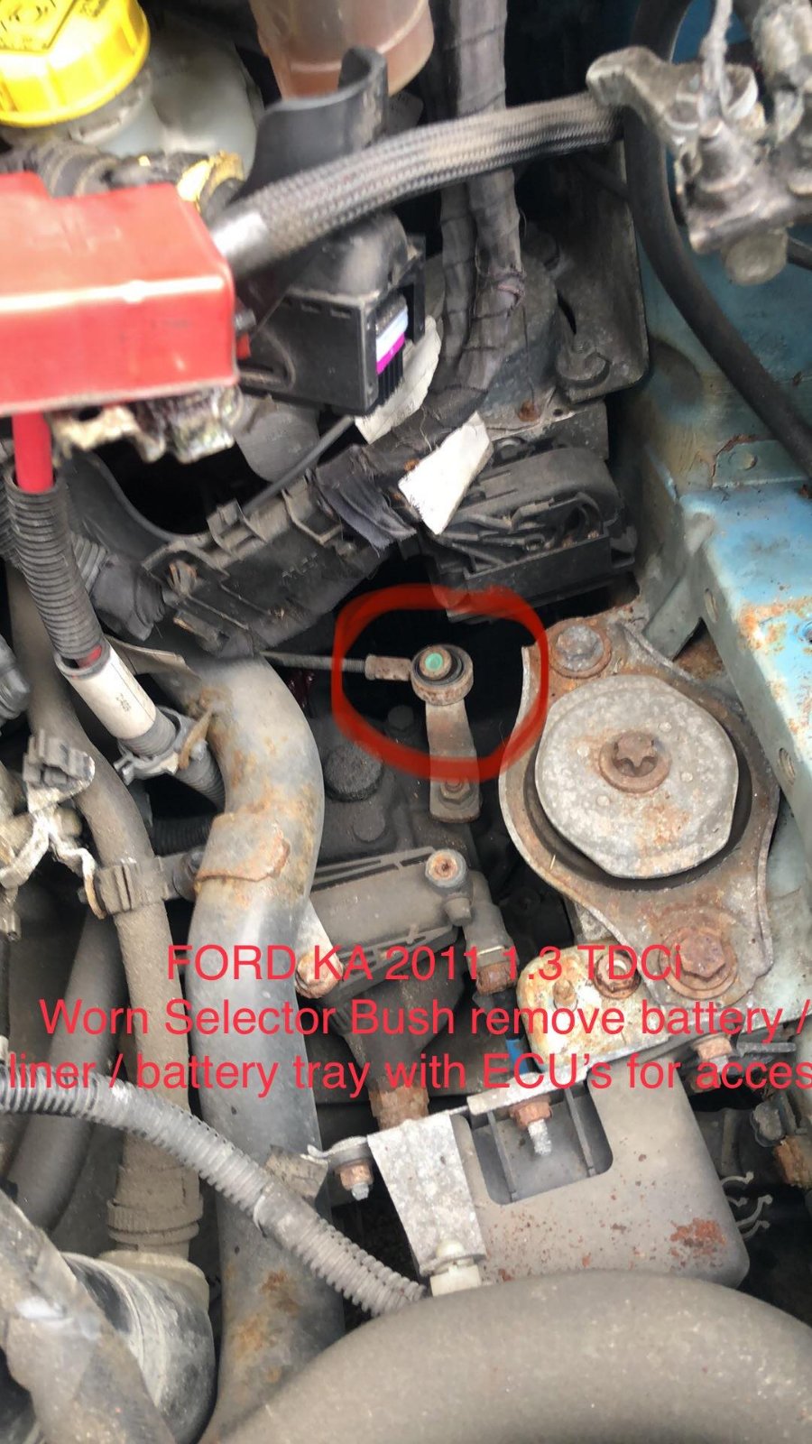

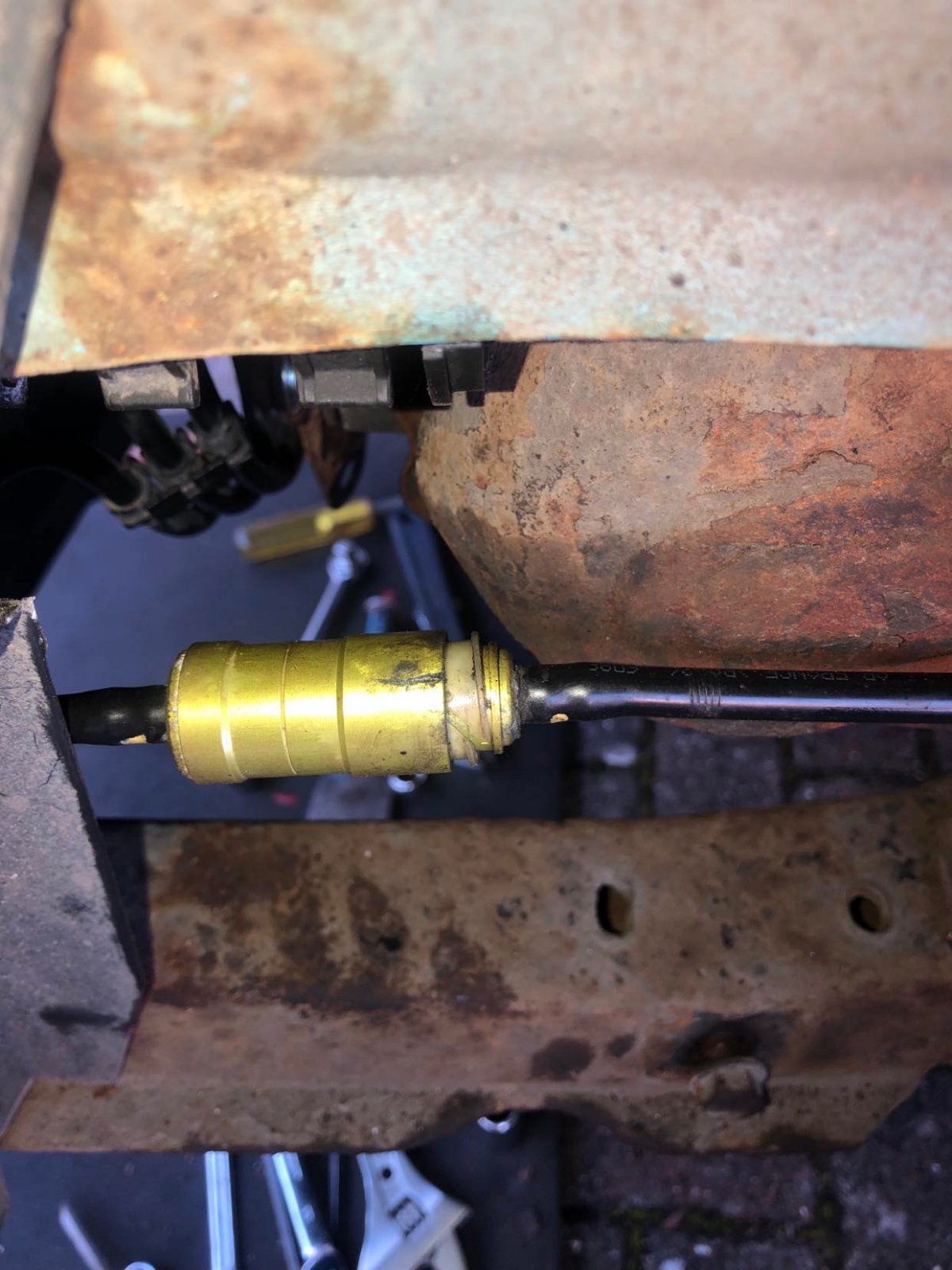

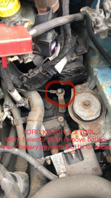

There is no fluid leak on the hydraulic clutch that I can see (common fault on similar Fiat 500's) and reservoir level is full, clutch slave rod has good range movement, clutch doesn't slip even when provoked with her new rear brakes and drums (last MoT), Whilst investigating I thought I'd found the issue after stripping out the battery/tray/ECU I found a worn gear linkage bush, Ford wanted to sell the full cable set-up for £330, but I managed to find some cheap cable ends for the gearbox ends (£30) hopeful that this was the problem.
Skull's Bush!
Skull's Bush!
Once fitted, It didn't seem to improve the gear change, so whilst I was away for a week, I got a FREE Halfords Clutch Assesment done - "Renew the clutch assembly" was the Recommended Solution £517.72 :shock:

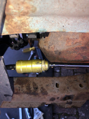

I'm now preparing for the job but wondered if anyone has any other ideas to try before I get stuck in ....Gearbox oil is £30 a Ltr from Ford (sealed for life box :roll: ) but I've got some ordered for £21 a Ltr (1.65 Ltr required) clutch is also a 2 part hydraulic hose (slave has a rusty grub screw for bleeding but I daren't try that as it looks like it will crumble - visible just below the bush in the photo on top of the slave cylinder)

As a 'no cost' check, have a look at the gear lever bushings and mechanism underneath the gear stick. It's not that likely to be that, but it'd be good to rule out the easy stuff first. Failing that - clutch release bearing worn out and/or the clutch fork is worn or damaged ?

bobins wrote: 08 Aug 2023, 18:15 As a 'no cost' check, have a look at the gear lever bushings and mechanism underneath the gear stick.
Good point bobins, as the smaller one on the gearbox end was well worn, that's the trouble with not getting a decent time to investigate, when she's never here for long these days :wink:
Next time I see the car I will have a look there.....

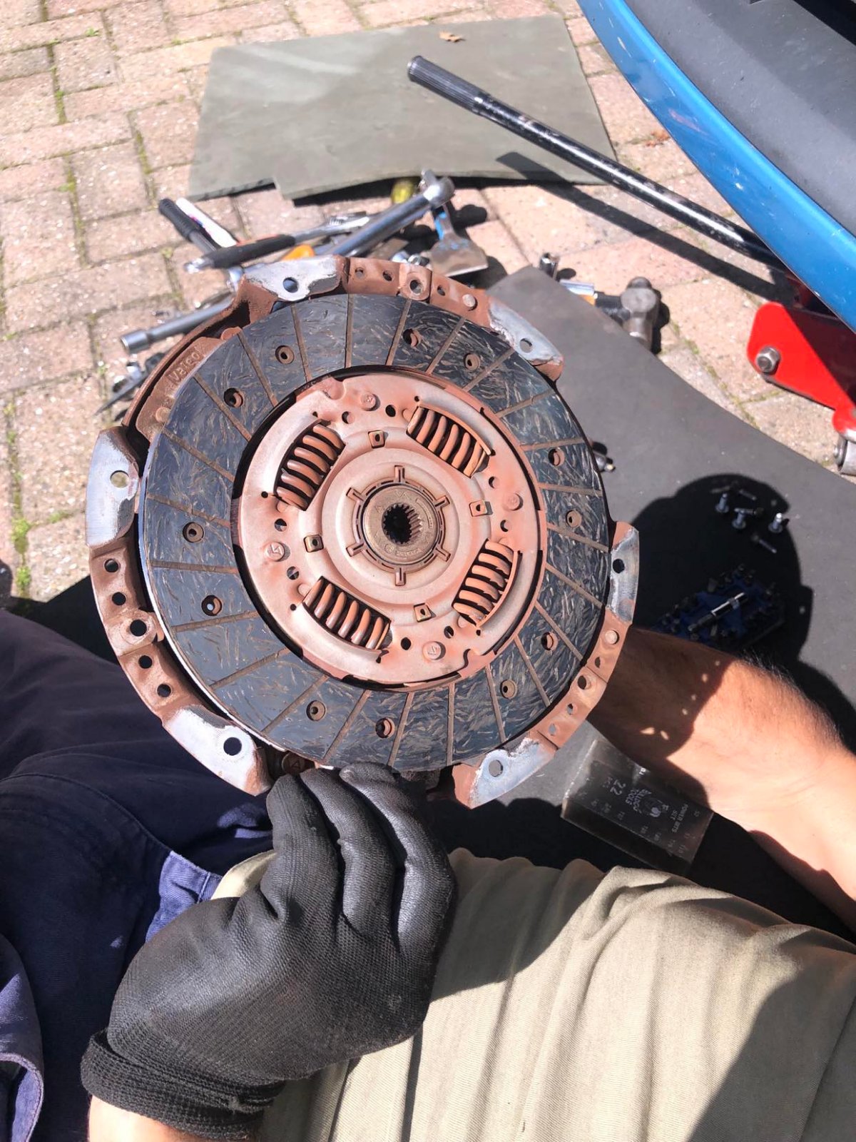

9m0s Engine Side Through Bolt - isn't a bolt! Nut needs either another nut locking on to allow the thread to be extracted from bell housing OR
I cut a slot with a small disc on an angle grinder, for a flat head screwdriver, which failed but managed to loosen it with a combination of impacting the edge of the slot to undo and then undone the nut which caught enough on the flat head flange to undo the thread bar (I was lucky here [-o< ) (I tried an extractor socket as per video but only had a 18v drill which didn't have the torque required) A bolt would have been easier FORD :roll:
18m23s 10mm Nut on coolant pipe bracket leaves a short thread that needs lowering / retracting through the slot before the gearbox can slide off (a FORD bolt here would have been SO MUCH easier :evil: )

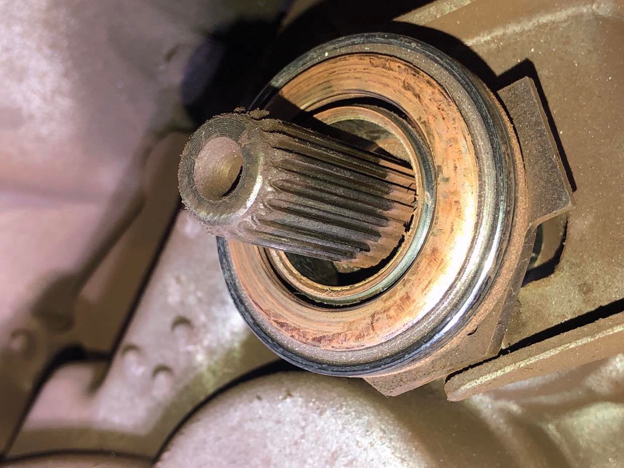

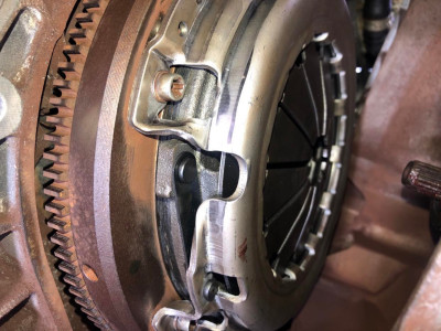

19m20s Clutch Pipe Connector - Had a small fracture (not leaking) badly fitted at manufacture? Release sleeve also fractured but managed to leave it attached.
Skull's = Fractured Connector
21m12s E20 Female Star Socket Required (Gearbox Mount)
24m20s Gearbox is heavier than Kevin makes it look :oops: I used a jack
Reassembly went well ....well ....the 2nd attempt did as I (Mrs Skull denies all responsibility) hadn't noticed the cluch slave rod slip out of it's ball socket when we mated the gearbox back onto the engine (I used a tie wrap the 2nd time)
I educated my Daughter when she popped around wondering how I was getting on and why she couldn't have her car back ... "Yeah I rest my foot on that clutch pedal" she said #-o

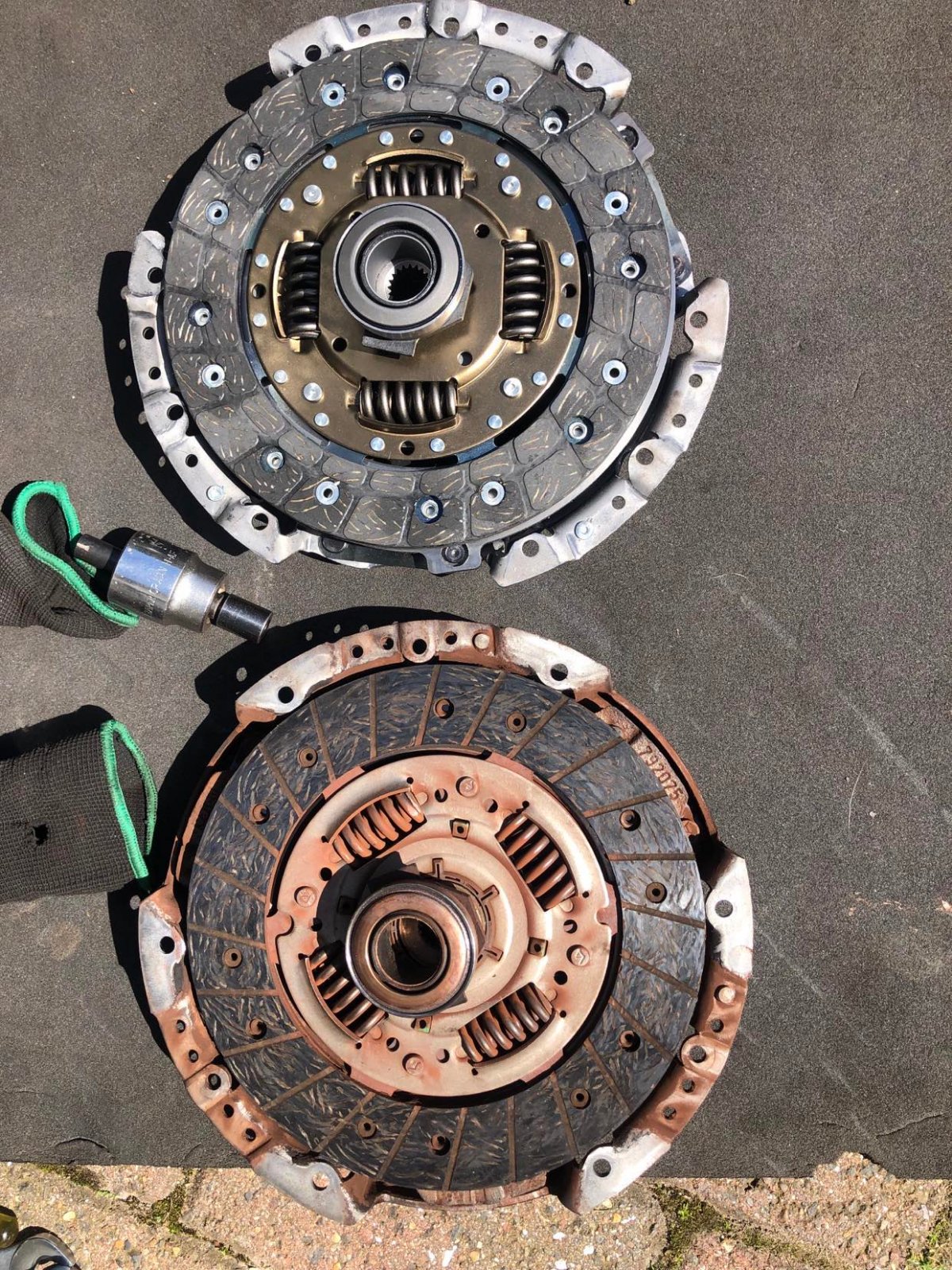

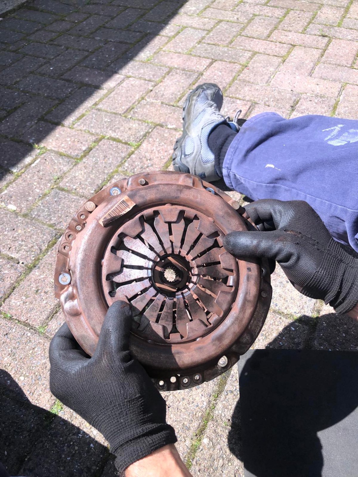

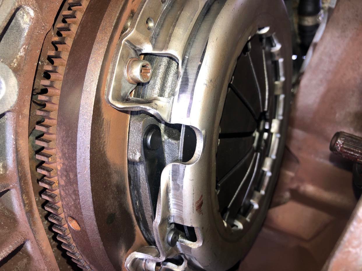

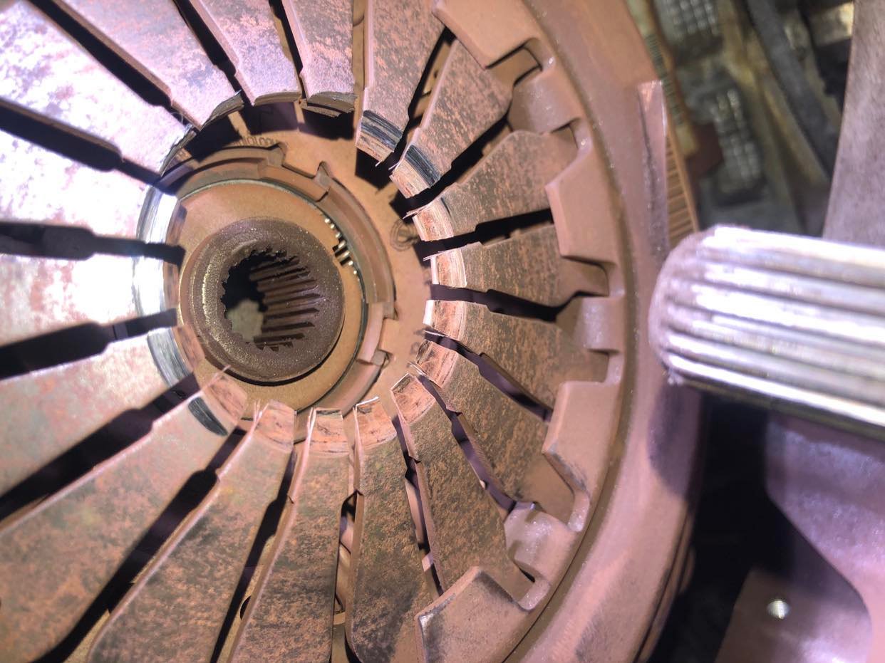

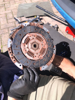

Skull's = If you ride the clutch

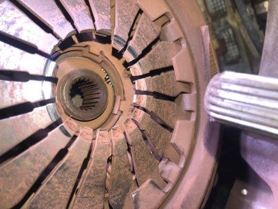

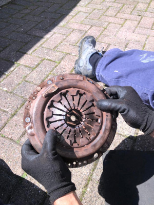

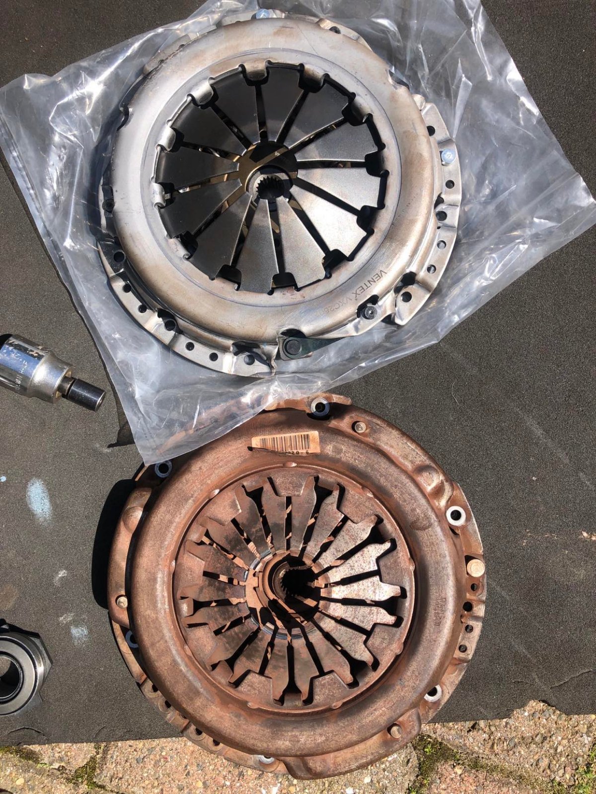

Skull's = Pressure Plate Worn Out (Me Too)

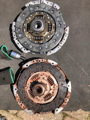

Skull's = Lots left On Clutch Disc
Skull's = OK
Skull's = OK
Skull's = Modified Short Alignment Tool Worked First Attempt
Skull's = Before And After
[attachment=0]
Skull's = Refitted Day 2
