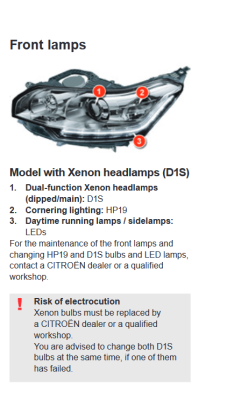

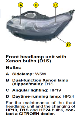

In manual for facelifted models there's nothing marked on location of previous sidelamp. Guy in video has been messing with his?
facelift: pre-facelift:

Yes he has been messing with it.
Also whether you have xenons or not makes a difference to the lighting as they have different bulbs and layouts.
Pre facelift models had a Halogen HP24W for the DRLs. The DRLs have one brightness and come on when the engine is started. I replaced mine with LEDs to match the Xenon main beams:
https://www.frenchcarforum.co.uk/forum/ ... 87#p464087
I later also replaced the bend lighting with the same LEDs.
