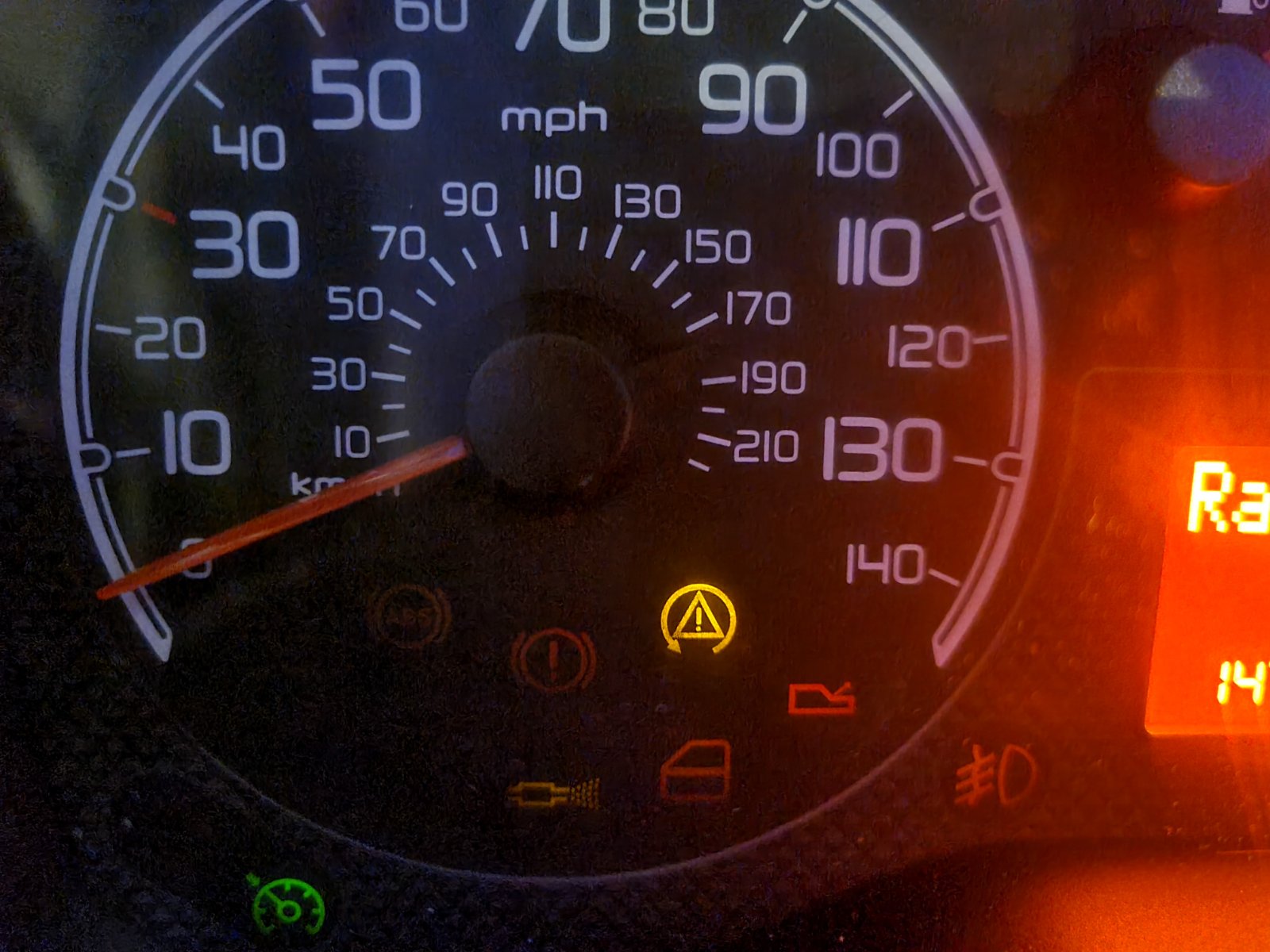

I seem.to be having problems with the cluster ( dials ) - the lights seem to be on " very faint " & I've changed the cluster 3 times, it happens on all them
I have l.e.d interior bulbs which are turned off fully , as they remain dim when there ( on when car doors open ) - I think because it still gets small voltage .
I also have l.e.d indicators, which is why I'm wondering why you asked about the l.e.d
Thanks =)

Because fitting LED bulbs into circuits that were not designed for having them can cause issues even so called ‘ CAN bus’ compatible ones. They have different resistances to the original bulbs so can cause issues on blown bulb detection systems & as you have seen can cause the LEDs to be on dimly even when not switched on. If you have any lighting issues i would always go back to all original bulbs just to rule them out.
As for your issue with the dim on dash lights, i have actually noticed the same thing on quite a few Nemo/Bipper/Doblo’s i have worked on however its not something i have gone on to investigate.
