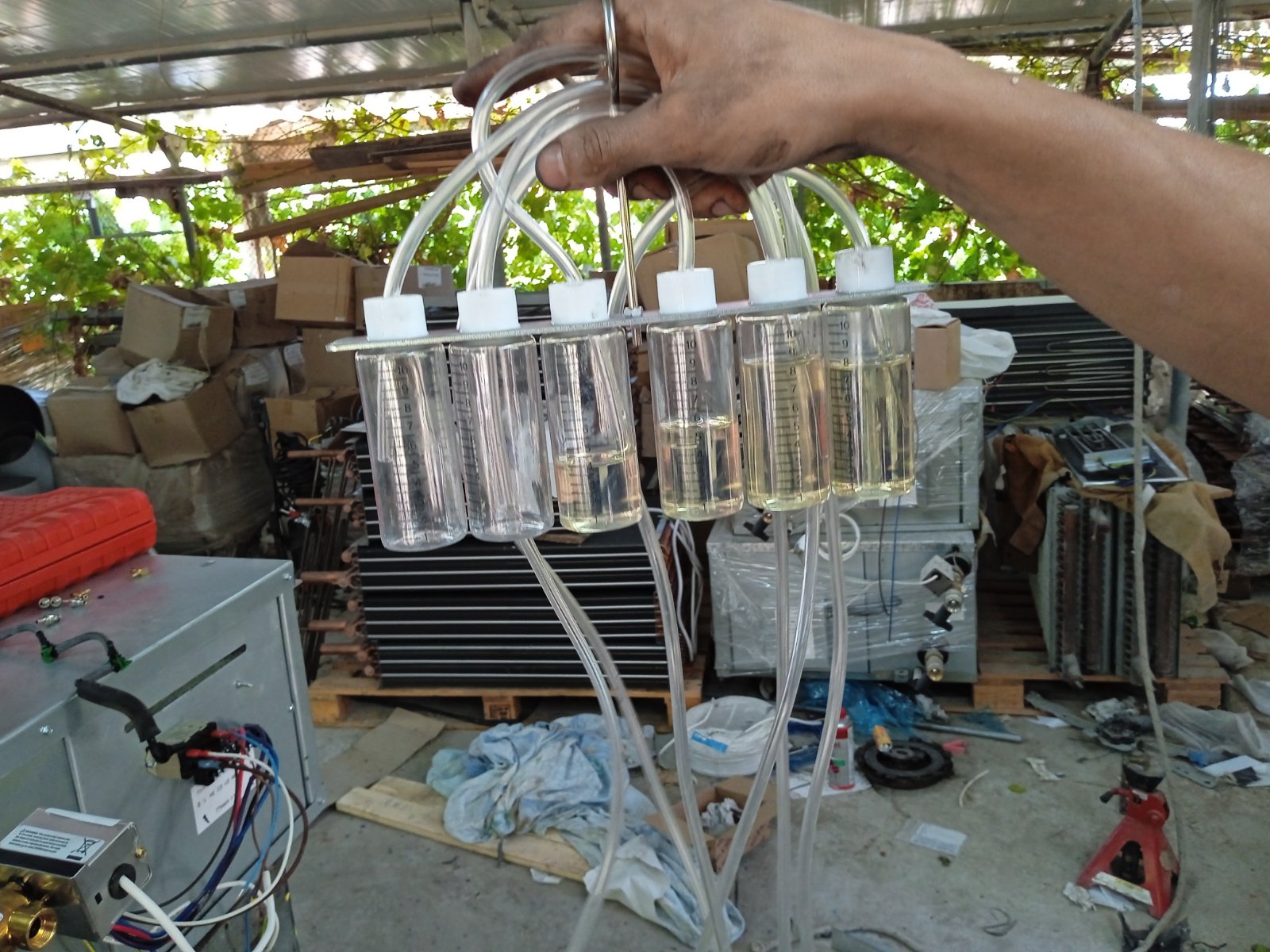

Those injectors are fubar. You'll need to replace all of them or send them to be refurbished. If it was me I'd probably source a known good second hand set to confirm a fix and then have the old ones refurbished.piki wrote: 26 Jul 2023, 12:21 update , so i managed to do the leak off test , i removed the end with the o ring part, i took just the hose , and it was sitting good inside the return hole.
the bottles filled so fast , in like 20 sec it reach 80 ml on the right 2 injectors

i order 2 injectors , will do a test after the installation, will see how it goes.

Your injectors are are starving the engine of fuel. It needs new or replacement injectors, those leak offs are pretty high. The diagbox is fine it's not given a good sine wave because the injectors are constantly over compensating for the sticking injectors. Your injectors are sticking which is restricting fuel flow.
