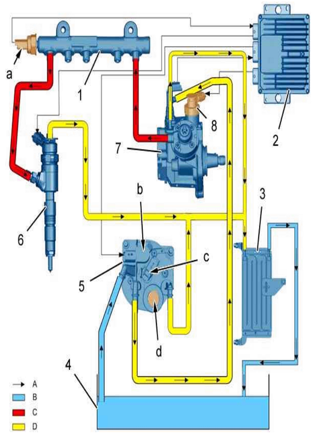

Here's the fuel circuit diagram so you can see how everything comes together on this system It may help you with checks....
Click Image to Magnify Key:
"A" Electrical links
"B" Low pressure fuel circuit
"C" High pressure fuel circuit
"D" Heated low pressure fuel circuit
| Reference | Designation | Electrical diagram correspondence |
| (1) | Fuel high pressure common injection rail | - |
| (2) | Engine ECU | 1320 |
| (3) | Fuel cooler | - |
| (4) | Fuel tank | - |
| (5) | Fuel filter | - |
| (6) | Diesel injector (1) ; (2) ; (3) ; (4) | (1331, 1332, 1333, 1334) |
| (7) | high pressure fuel pump | 1208 |
| (8) | Fuel flow regulator | 1208 |
| "a" | Fuel high pressure sensor | 1321 |
| "b" | Integral diesel fuel heater | 1276 |
| "c" (*) | Water in fuel sensor | 4050 |
| "d" | Manual fuel primer pump | - |
