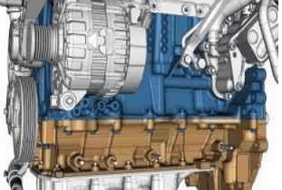

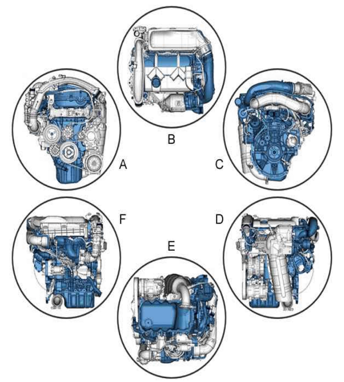

First you need to get an idea of where the oil is leaking from using the following - each has its own fault finding procedures. Let me know which (A-F) is the most likely place and we can take it from there:
Click Image to Zoom
Zone "A" Timing face
Zone "B" Upper face
Zone "C" Coupling face
Zone "D" Exhaust face
Zone "E" Lower panel
Zone "F" Inlet face

Hi, so if I could have A and D that would be awesome - it's possibly at the corner where the two of those join. Its been really hard to pinpoint and we've tried lots but it doesn't leak wilst stationary, only whilst the car is being driven - has gone through two auxiliary belts so far...
Many thanks!!
x 6963
Re: Oil Leak
Ok, there are specific procedure for narrowing this down, so I'll get the onward instructions for zones A and D shortly.

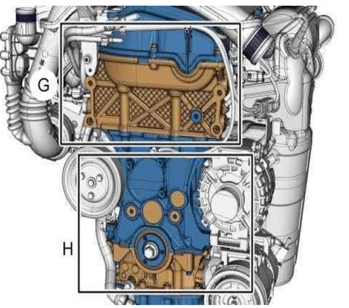

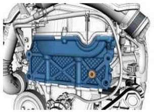

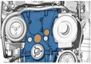

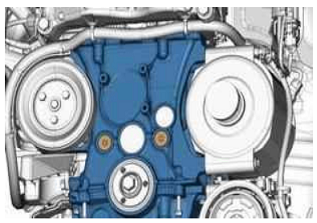

Ok, so Here's Zone 'A' for now. I'll put up the Zone 'D' tomorrow morning.

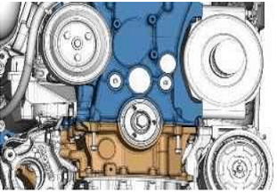

Timing Face
Preliminary operations:
  • Place the vehicle on a lift
  • Remove the engine style cover
ZoneProbabilityComponent to be checked firstLocating the leak
"G"LowCylinder head cover on cylinder headTiming face - Stage G1
"H"LowsumpTiming face - Stage H

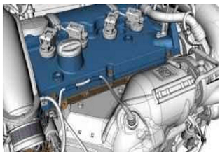

Step G1 - Cylinder head cover on cylinder head
Sealing
- Detachable seal
- 12 bolts
Probability: Low
Possible causes:
- Incorrect tightening of the fixing bolts
- Defective seal
- No seal
Access: Easy
Repair: Replace the seal
Step G2 - timing chain guide upper fixing bolts
Sealing: Flat seal removed
Probability: Low
Possible causes
- Defective seal
- No seal
Access: Difficult
Repair: Replace the seal and the bolt
N.B.: Do not oil the seal.
Step G3 - Cylinder head on cylinder block
Sealing:
- Detachable seal
- 13 bolts
Probability: Average
Possible causes
- Faulty cylinder head gasket
Access: Difficult
Repair: Replace the cylinder head gasket

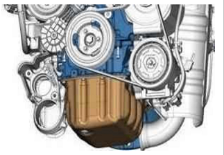

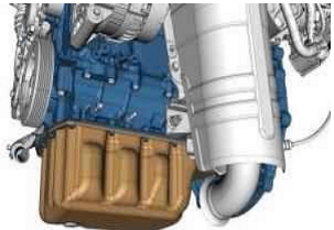

Step H1 - sump
Sealing:
- Seal applied of silicon type
- 16 bolts
Probability: Low
Possible causes
- Discontinuity of the sealing bead
Access: Easy
Repair: Repair of the sealing of the area using an approved product
Step H2 - Lower fixing bolts of the timing chain guides
Sealing: Detachable O-ring seal
Probability: Low
Possible causes
- Incorrect tightening of the plug
- Absence of seal
- Defective seal
Access: Difficult
Repair: Replace the bolt (Including the seal)
Step H3 - Oil core cap
Sealing: Force-fitted cap and sealing paste
Probability: Low
Possible causes
- Cap shape fault
- Absence of sealing paste
Access: Difficult
Repair: Replace the cylinder block
Step H4 - Crankshaft main bearing casing on cylinder block
Sealing: Seal applied of silicon type
Probability: Low
Possible causes
- Discontinuity of the bead of silicon
Access: Difficult
Repair:
- Check the tightening torques
- Redo the sealing of the crankshaft main bearing casing on the cylinder block, using an approved product
Step H5 - Crankshaft
Sealing: Dynamic seal
Probability: Low
Possible causes
- Seal damaged
- Lip turned over
- Routing of the seal
Access: Difficult
Repair: Replace the dynamic seal
N.B.: Check whether the dynamic seal has been coated, if not, coat the seal when refitting.

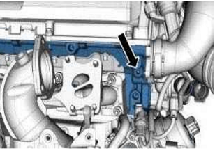

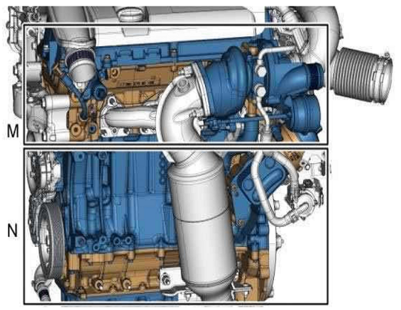

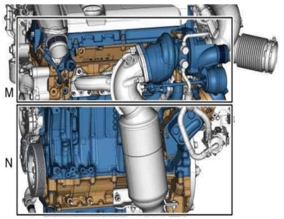

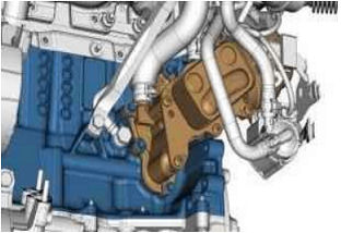

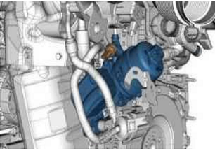

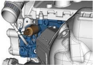

Zone D - Exhaust Face
"M"LowTurbocharger lubrication pipe on turbochargerExhaust face - Stage M1
"N"LowsumpExhaust face - Stage N1

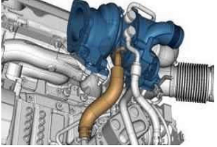

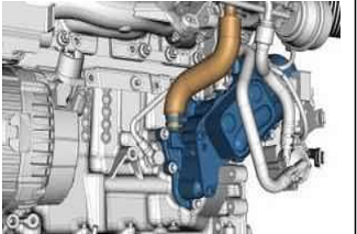

Step M1 - Turbocharger lubrication pipe on turbocharger
Sealing:
- Banjo type
- 2 washers
- 1 bolts
Probability: Low
Possible causes
- Fault with the washer sealing
- Absence of sealing washer
- Fault with the sealing of the union
Access: Easy
Repair: Replace the union bolt and the seals
Step M2 - Cylinder head cover on cylinder head
Sealing:
- Detachable seal
- 12 bolts
Probability: Low
Possible causes
- Defective seal
- No seal
Access: Easy

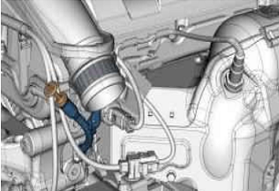

Step M3 - dipstick
Probability: Low
Possible causes
- Defective seal
- Absence of seal
Access: Easy
Repair: Replace the dipstick
Step M4 - Oil gauge guide on cylinder head
Sealing: Detachable seal
Probability: Low
Possible causes
- Defective seal
- Absence of seal
Access: Average
Repair: Replace the oil gauge guide
Step M5 - Exhaust camshaft dephaser solenoid valve
Sealing:
- Detachable O-ring seal
- 1 bolts
Probability: Low
Possible causes
- Defective seal
- Absence of seal
Access: Average
Repair: Replace the electrovalve
Step M6 - Oil non-return pipe on cylinder head
Probability: Low
Possible causes
- Incorrect tightening of the valve
- Defective seal
- Absence of seal
Access: Average
Step M7 - Oil gallery balls on cylinder head
Sealing: Balls force-fitted
Probability: Low
Possible causes: Ball shape fault
Access: Average

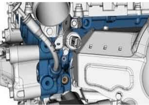

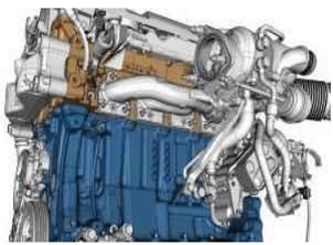

Step M8 - Cylinder head on cylinder block
Sealing:
- Detachable seal
- 13 bolts
Possible causes
Access: Difficult
Step N1 - sump
Sealing:
- 16 bolts
Probability: Low
Possible causes
Access: Easy
Step N2 - Crankshaft main bearing casing on cylinder block
Sealing:
- 18 bolts
Probability: Low
Possible causes

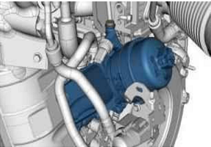

Access: Difficult
Repair

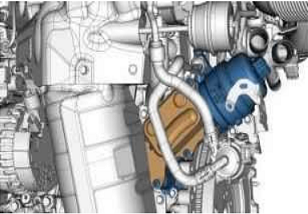

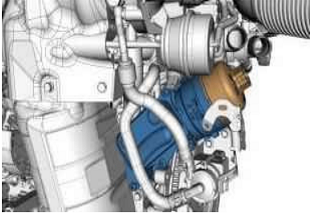

Step N3 - Oil filter cover
Probability: Low
Possible causes
- Incorrect tightening of the cover
- Defective seal
- Absence of seal
Access: Average
Repair: Replace the oil filter cover
Step N4 - Oil pressure sensor
Probability: Low
Possible causes
- Defective seal
- Absence of seal
Access: Average
Step N5 - Oil channel cap
Sealing: Cap mounted and tightened on the support
Probability: Low
Possible causes
- Fault in the shape of the working surfaces
Access: Average
Repair: Replace the oil filter support
Step N6 - Exchanger cover on oil filter support
Sealing:
- 4 separate seals
- 5 bolts
Probability: Low
Possible causes
- Seals defective
- Absence of seals
Access: Difficult
N7 - Oil filter support on cylinder block
Sealing:
- 2 separate seals
- 4 bolts
Probability: Low
Possible causes
- Defective seal
- Absence of seal
Access: Difficult
Repair: Replace the seal (Set of seals)
Step N8 - Turbocharger lubrication return pipe on oil filter support
Sealing:
- Pipe force-fitted
- Clamping collars
Probability: Low
Possible causes
- Incorrect tightening of the clip
- Crimping fault
- Incorrect fitting of the pipe
Access: Difficult
Repair: Replace the turbocharger lubrication return pip
Step N9 - Turbocharger lubrication return pipe on turbocharger
Sealing:
- Detachable flat seal
- 1 bolts
Probability: Low
Possible causes
- Defective seal
- No seal
Access: Difficult
Repair: Replace the turbocharger lubrication return pipe O-ring seal

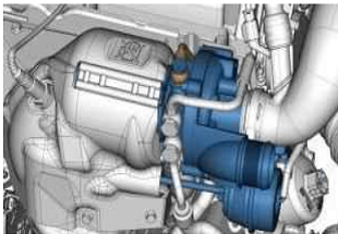

Step N10 - Turbocharger lubrication pipe on cylinder block
Sealing:
- Banjo type union
- 2 flat washers
- 1 bolts
Probability: Low
Possible causes
- Bolt head fault
- Washer absent or incorrectly positioned
- Fault with the banjo union
Access: Difficult
