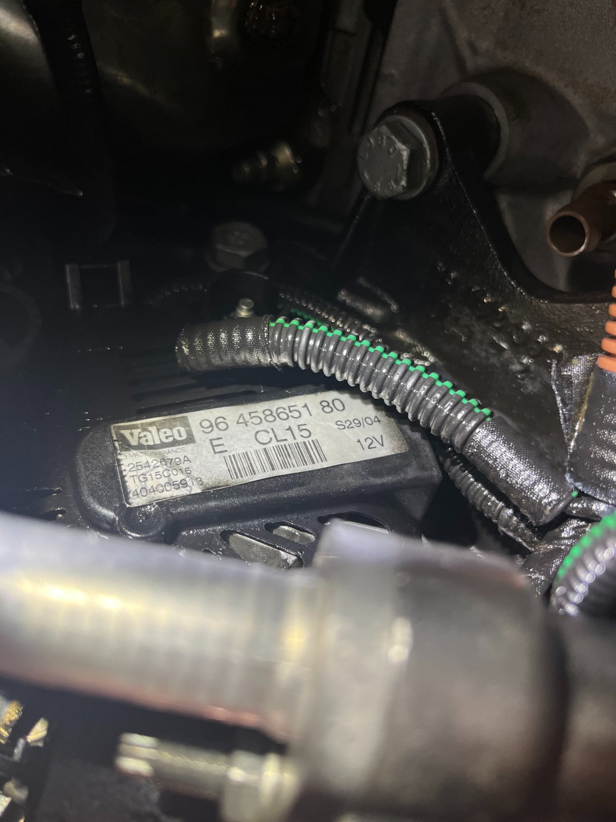

An interesting end to this story some 14 months later.
During that time the low battery warning light came on and off a few times
Last week on a 46 C day, it came on, went off and then stayed on.
I managed to drive home 50kms trying not to use any electrical power (eg air cond)

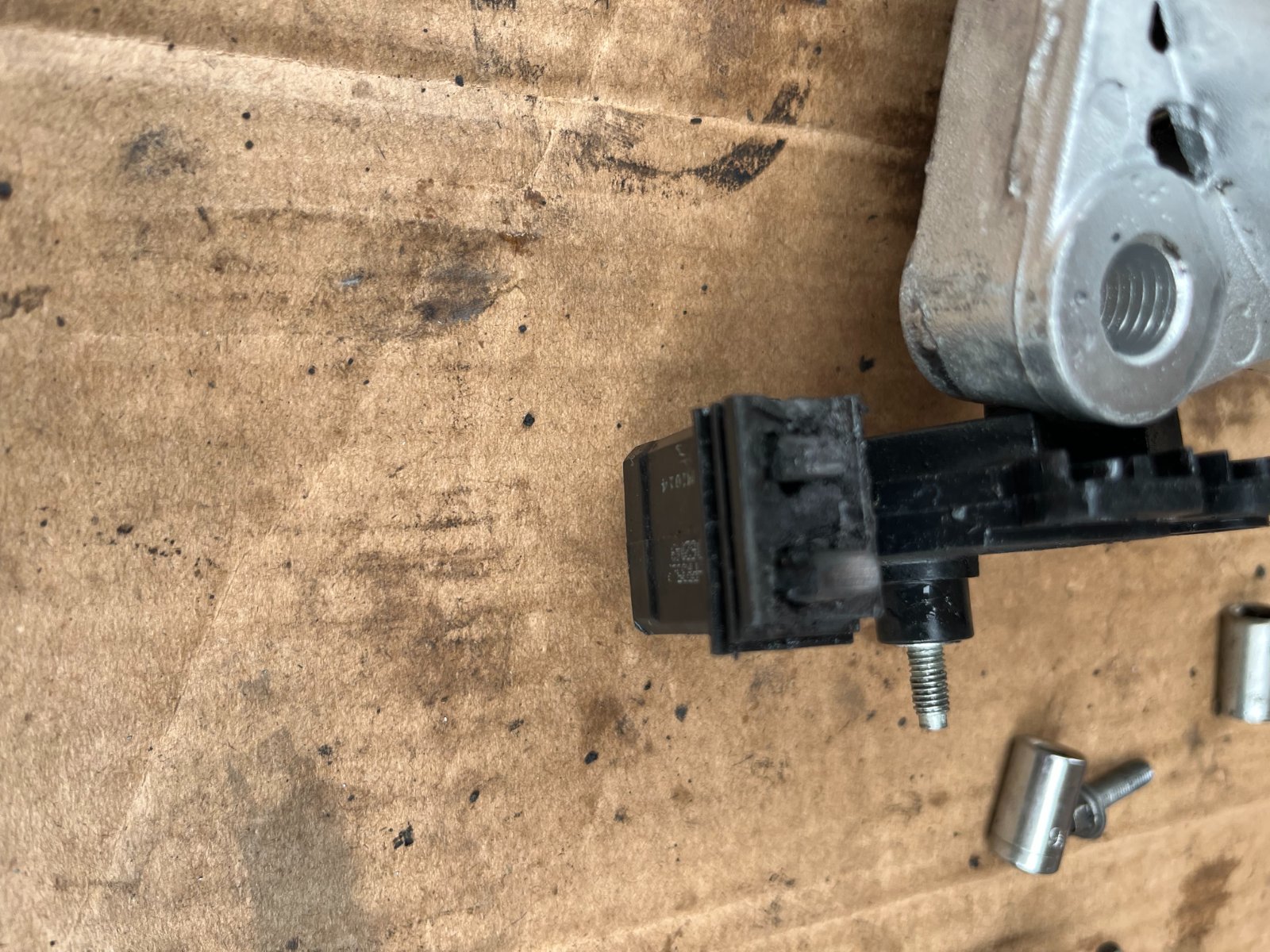

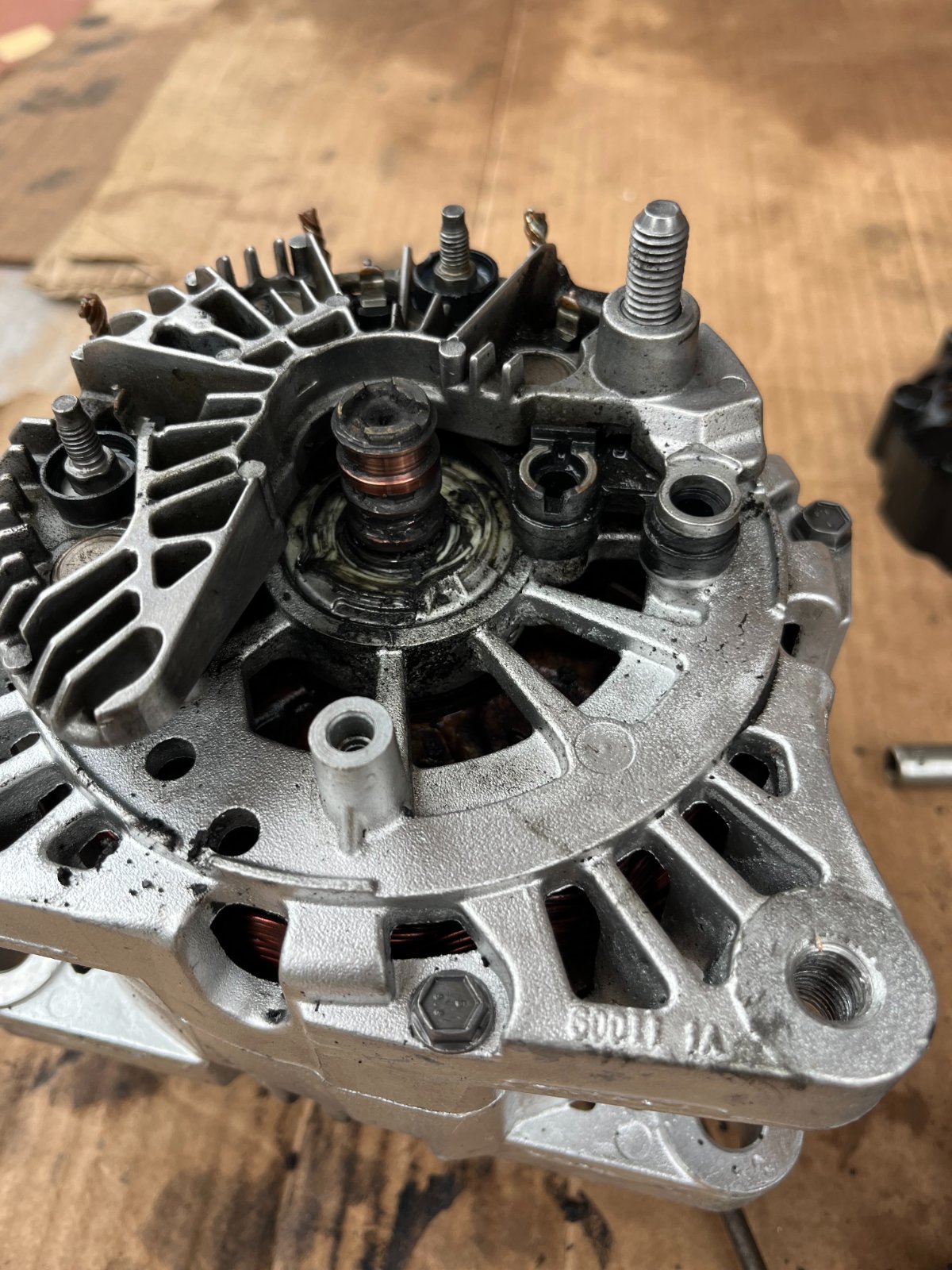

Pulled the alternator off and found the slip rings / brushes caked with crud.
Also the lower slip ring as pretty worn and the lower brush was short so suspect they gave up contact.
Cleaned it up, unsoldered the lower brush to extend it a bit and refitted. Now have 14.2 volts
The worst part of this job is that you need to undo the airconditioner compressor and let it hang as the alternator is fitted above it.
I had this alternator "rebuilt" some 3 years ago but now suspect they just cleaned it up, painted it and handed it back, no new parts at all. I've only travelled some 30,000 kms since that so would not expect that much wear or crud in new components, esp as the warning light has been coming on for some time

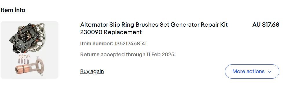

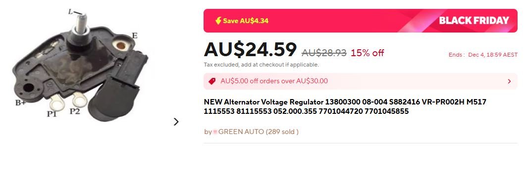

Once summer is over, I'll rebuild it with new components which I found as per pics
