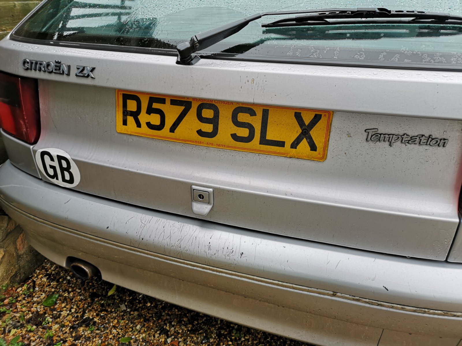

I peeled the GB sticker off the tailgate and found a hole that had been smashed through the GRP... I put the GB sticker back on! This explains the crack running down the tailgate...

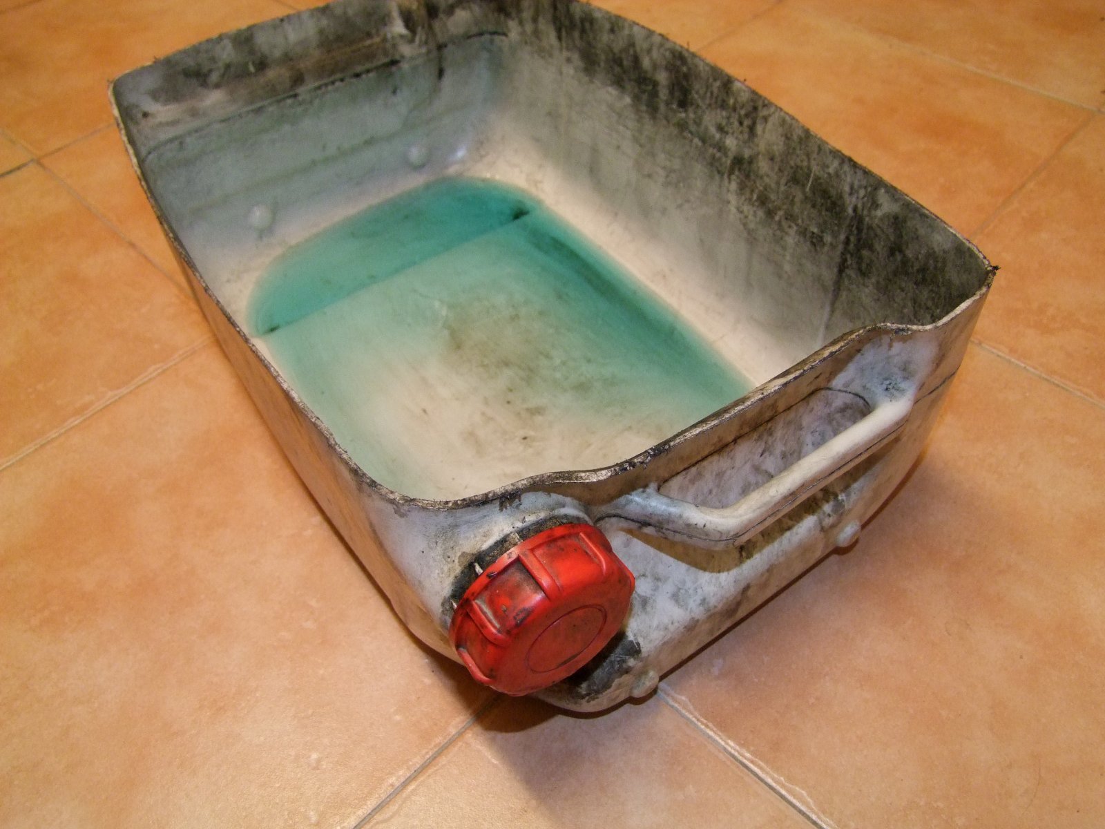

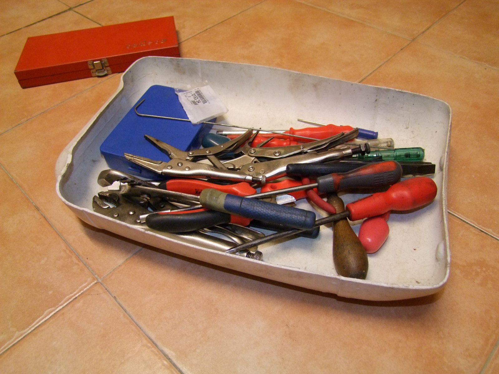

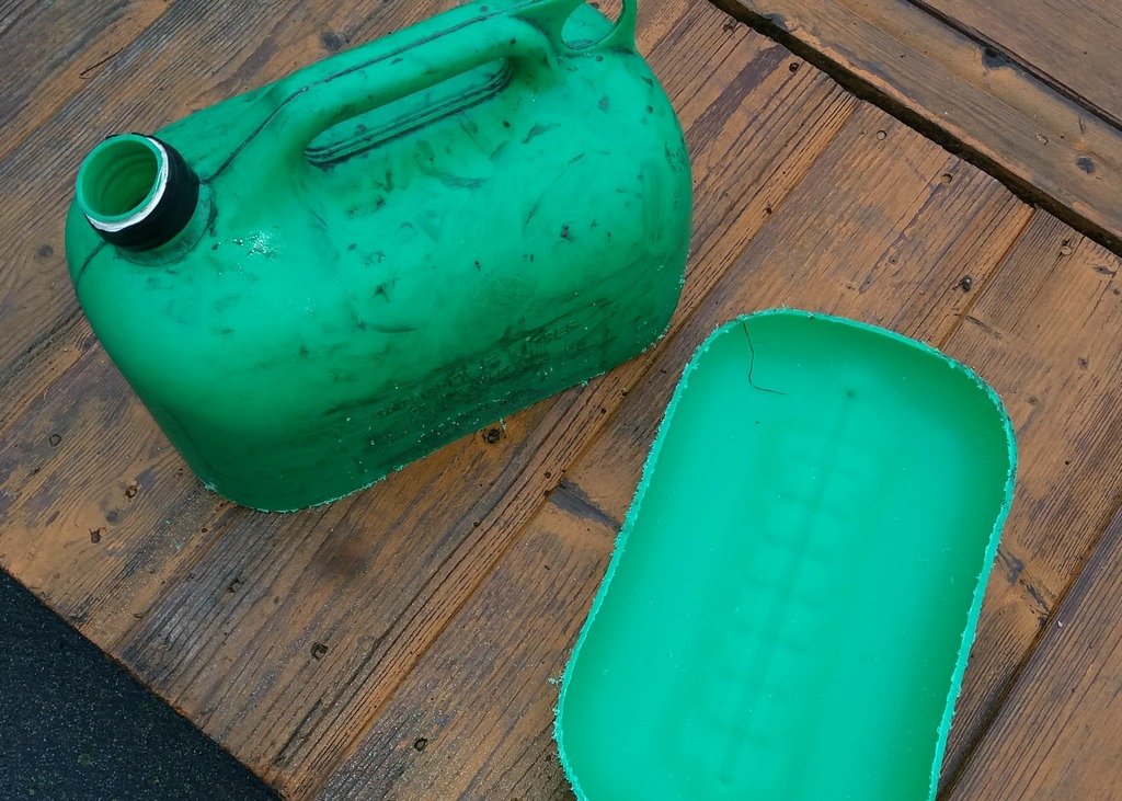

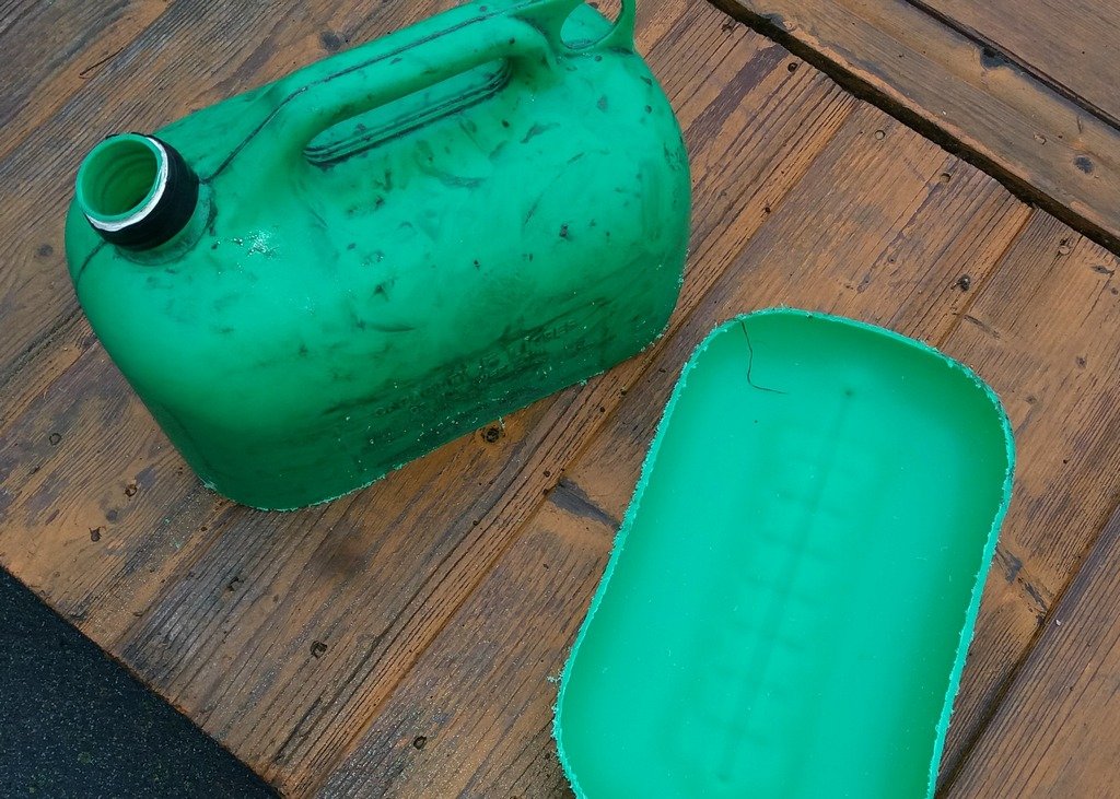

Reminds me of something done a good while ago...
20-litre container, one horizontal (jigsaw) cut: Makes one draining container, with emptying cap and grab-handle And one tool/bits tray

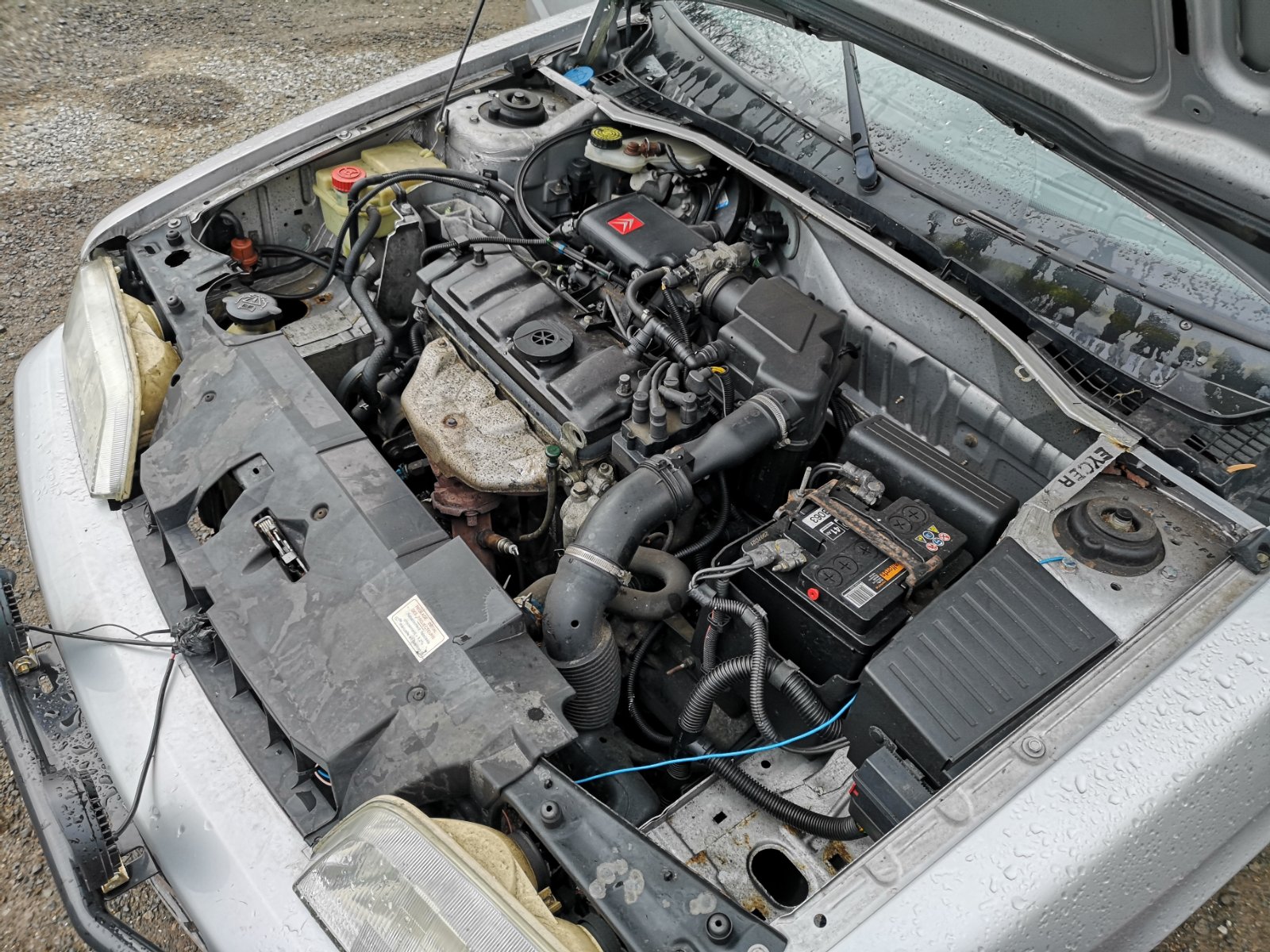

So, enter the 3rd ZX! a 1997 1.4i Temptation! Bought from Derby on Monday, a guy from another forum I know was delivering a car to Newcastle on Tuesday, so I bunged him £50 and he got the train from Newcastle to Derby, drove to mine in Oxon, then I drove him home to Basingstoke and back again!
What did I buy (sight unseen)?
It's fairly tidy. No idea how many owners it's had yet as I don't have the V5 (The guy I bought it from only recieved it this morning, got to change the ownership tonight) but it has 57k on the clock and a very clean MOT history
The engine is lovely, as in there's space to work on it!
The guy I bought it from had fitted a lightbar using cheap LED ebay parts, and initially I asked him to remove it, but then changed my mind and I'm so glad I did! It looks awful frankly but driving home last night, having come off the m40 onto the B roads to home it made the night into day! It's wired into the full beam, so woe betide any full beam idiots coming my way now... (All the wiring needs tidying, it's all crimped on atm so I'll see to that)

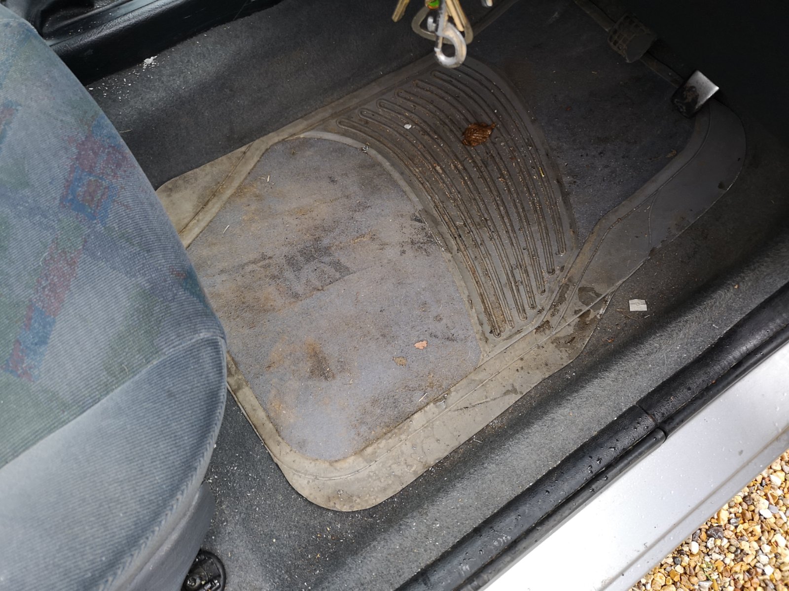

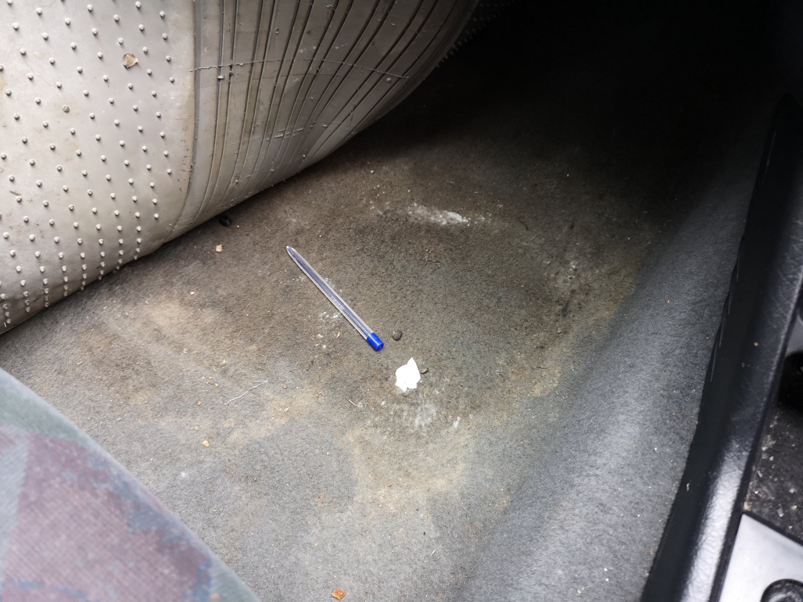

Downsides, well... the interior is perhaps not as fresh as it could be
it utterly STINKS! Must have the carpet shampooed/removed and jetwashed before it becomes warm! Not the person I bought it from's fault, he only had it 3 weeks (couldn't fit his mobility scooter in it) but it seems to be wearing all of it's 57k in it's carpet!

The engine runs sweet at idle but under load or at speed it makes a tapping/clacking type noise which increases in speed with the speed of the car. It's been doing this in the 2500 miles I've done in it so I'm perplexed as to what it is. Any ideas? The car doesn't seem to go as fast as it should (I know it's a slow car but it feels even slower than usual). 80mph on the motorway is a bit of a struggle and the car becomes tiresome to drive quite quickly.
Also, the accelerator pedal is quite hard to press. I've tried without success to lubricate it and adjusting the cable at the throttle end has maybe improved it slightly.

The tapping noise may be incorrect valve clearances... They're easy enough to check and it's well worth doing them to eliminate that as a cause. I'm assuming it has the 8 valve engine...
If it's not that, I have some other thoughts...
If it has the old Bosch single-point fuel injection it will be a bit sluggish. I have the same on my Saxo and it's never going to set the world alight!
Heavy throttle is almost invariably the cable... Check it's not kinked somewhere along its length...
