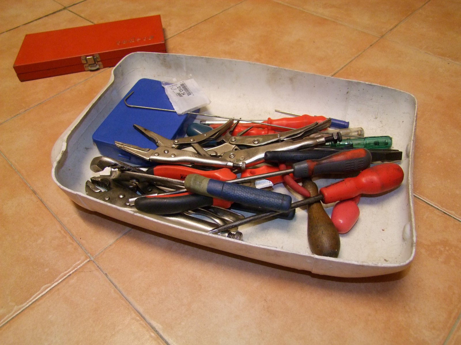

Reminds me of something done a good while ago...
20-litre container, one horizontal (jigsaw) cut: Makes one draining container, with emptying cap and grab-handle And one tool/bits tray
