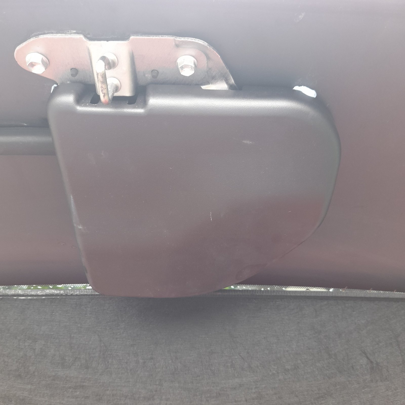

Hello all, question for you: I get this steady vibrating noise from the boot of my C1 whenever I'm above 10mph. I don't notice on the open road, probably because of the engine noise. Anyway, there's next to nothing in the boot, just a couple of folded-up shopping bags and a first aid kit. The plastic thing on the boot door is loose (see pic). You can see I've used my engineering expertise to stop the wobbling with Blu-tack. How can I reattach the plastic thing? And what's the name for that bit, anyway?

That doesn't look like anything factory-fitted - seems to be some 'thing' somebody else has fitted, so can't help you there.

Weird. Maybe it was an optional extra
- x 6957
Re: Vibrating noise in boot of Citroen C1
I doubt it, as accessories are usually a bit more 'polished' than plain nuts and bolts drilled into the trim - it looks like somebody has made their own contraption to secure something they once had....

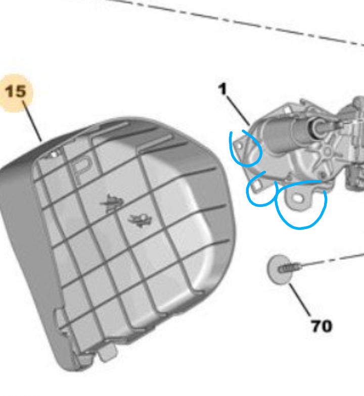

Looks like the rear wiper motor cover to me, There is an updated part number for it too suggesting it may be modified

That metal thing doesn't bear any resemblance to me - look at the steel ring - I can't see that on the above??

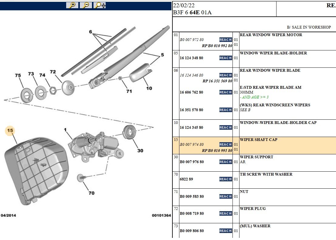

The metal part steel ring is the lock striker, this is shown in the diagram for the tailgate lock rather than the rear wiper motor diagram.
I'm 100% confident that the plastic part shown is the rear wiper motor cover above part no B001099580.

A quick google of the part no brings up this
https://citroendirectparts.co.uk/produc ... tor-cover/

Or if wanting to make a little job into a bigger task (as I invariably do!) Then perhaps these holes, which appear redundant on the pictures: Might be good candidates to add a rivet nut and a (roofing bolt or something like https://www.ebay.co.uk/itm/266135476941?) are nice and flush, available in long lengths, small diameter (M5 or M6 plenty for this job)
