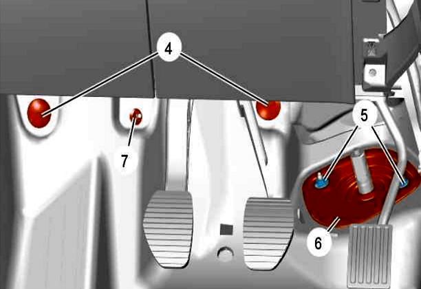

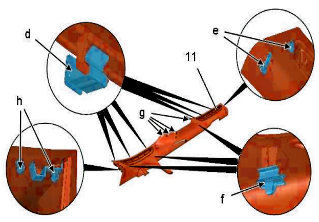

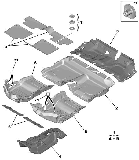

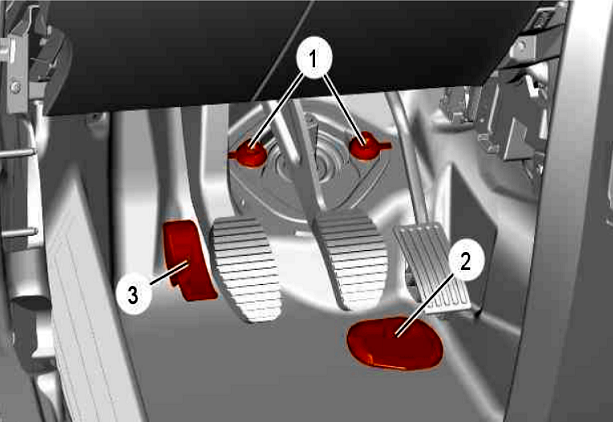

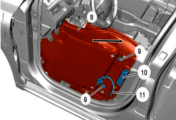

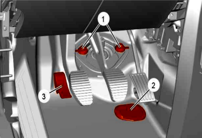

So the seat needs coming out (beware airbags in seats / electrical connections), so disconnect the battery following the BSI Reset / Battery Disconnect / Reconnect Procedure. I won't put the central console / seat removal here as you've seen that on other posts.
Diagram of the Carpet Sections
First remove the door sill trim ('g'):
(Tip the rear set cushion).
N.B. : Release the door opening seal (at "d").
Unclip the door sill trim (11) (at "d", "e", "f", "g", "h") using trim removal tools.
Remove the door sill trim (11).
Carpet
Pictures show left hand drive, but should be the same:
Unclip the covers (1) using trim removal tools.
Remove:
Remove the mountings (9).
Detach:
Carpet
Remove:
- The stop (2)
- The stop (3)
- The mountings (4)
- The nuts (5)
- Seal (6)
- The nut (7)
Detach:
- The floor carpet (8) (In the direction of the arrow )
- The air vent (10)
- The electrical harness (11)
- Remove the floor carpet (8).
