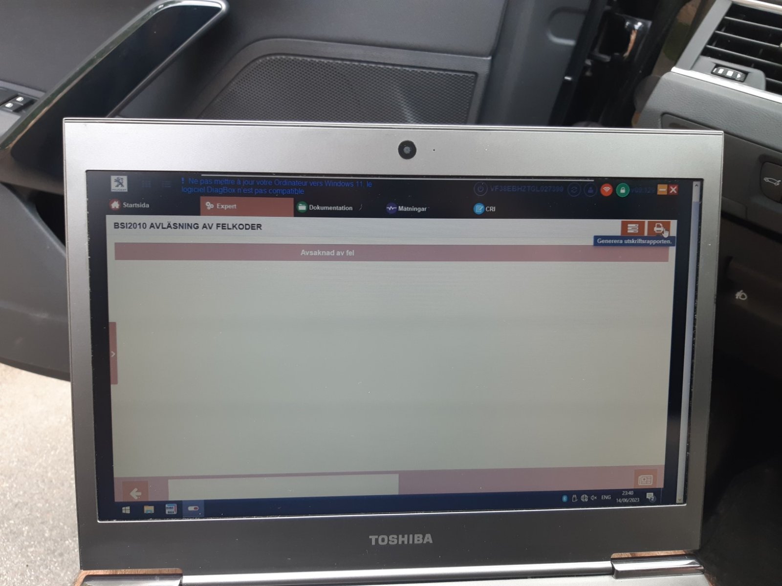

Hi,
I got a replacement fuse box BSM with relais-set built in by my independent workshop in the end of `22.
Job has fixed missing action of the washer pump for windows, although different from before, as the front switch now serves front and back wiper at the same time, with halv pressure obviously. :)
Did not use AC all winter after this job and established now that neither AC or low-speed fan are working at the moment. Tried to run an actuator test with diagbox 9.129 and started to wonder if installation of the (used) fuse box can have gone wrong. VIN-nr är VF3**************[VIN obfuscated, can be read by forum staff]
New fusebox is Delphi BSM-Z06-01.
BSM 2010 is found, but telecoded som "missing".
Same seems to apply for drivers door and Voltage stabilisator.
Besides is noted "communication failure" for unit "additional heating" (water).
But no active errors are stored in diagnosis section.
I am attaching some pics of the diagnosis session and with the result of test action of compressor clutch, I suppose. Sorry that messages are displayed in Swedish, next time I´ll choose english language.
After studying various posts on this and other forums and doing some multimeter readings I have now ordered an exchange resistor for the cooling fan, as it might be broken anyway.
Highly appreciate the knowledge spread in the forum and
would be very glad to get some advice on the diagbox findings and errors B1003-00 anyway!
/Marian

Hi, thanks for reply!
I did not understand that for sure by the time that I left the car to the garage.
Now I have some more understanding but unfortunately not enough to help myself, left alone that version 9.129 does not seem to support telecoding.
Still the only errors that are consistently noticeable are failure of the AC compressor clutch and the slow speed fan.
From that point of view I have the impression that the configuration of the fusebox is at least copied from the previous unit.
I borrowed the diagnosis equipment from a tool-sharing site, in the first place for to understand if there are actually parts of the car that are excluded from the cars communication by wrong coding or configuration. That because I would certainly like to know if the job of the garage turned out to be useless in the end.
Next I would clearly need some advice about how to restore a fully functioning setup.
If I get you right you are suggesting (from the results of the diagbox) that the fusebox probably has to be coded from scratch/ replaced with a new part and configured step by step by using access to a PSA server. Meaning that I would need to book the Peugeot doctor for lets say at least a day?
Greetings,
/Marian
