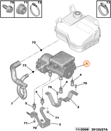

Thanks for your Forum donation Dave.dbrowne wrote: 19 Jun 2023, 16:22 Thanks Marc.
I have upgraded my membership so would appreciate if you could look up what the OEM is.
Dave
(1) BHI
Brand New Citroen Original (To be Configured), part: 5277N8, £1,860.77
