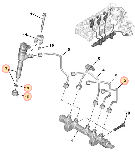

Fault Code:
Note I've included seals and mort importantly the supply pipe for Cyl 1, as these must be replaced when changing an injector, owing to deformity of connection when removed.
(7)
OEM New Bosch Injector, part: 9802776680, £563.92 *
Bosch Exchange Injector, part: 1610578480, £426.73 *
* Deposit surcharge on injectors of £120 refundable on return of old part.
(2) Injector Supply Pipe (Cyl 1), part: 1570P9, £15.49
(8) Injector Protector, part: 1982G6, £3.43
(9) Injector Seal, part: 9804220580, £3.86

If you are doing it by the book you are also meant to replace the injector return pipes/seals too. In the real world though i have reused more of these injector supply pipes (on various types of HDi’s) than i could count & never had any issues.GiveMeABreak wrote: 02 Jun 2023, 11:42
Seals 8 & 9 in my opinion are super important to be replaced. Even more important than that i would say making sure that the seat in the cylinder head is spotless before replacing an HDi injector. There are proper seat cleaning tools for doing this. If the injector seal is not properly cleaned its not usually too long before you start getting blow by.
