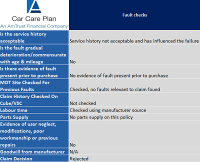

---Findings from warranty company –
The vehicle had been recovered to the dealership with a report of a non-start and the wheels locked up.
Inspection found the timing chain between the two camshafts had broken. The timing belt between the crank and the inlet camshaft was intact and ok.
As a result of the inlet/exhaust camshaft timing chain breaking, further catastrophic damage has occurred.
The last service, which was due during the present owner’s ownership, was found to be some 9 months and 4150 miles overdue, reference the 25000 mile/24 months service schedule.
Given that the tensioner is oil fed with the timing chain assembly lubrication related, there is a direct link to the present failure.
