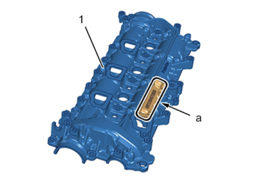

The engines should have been modified with the 8mm chain from RP no 15758 but i believe there have been cases after this.
Check the number at B You may need to remove some bits & use a mirror.
If the number is 98 126 472 80 then the engine was factory fitted with a 7mm chain
If the number is 98 305 804 80 then the engine was factory fitted with a 8mm chain

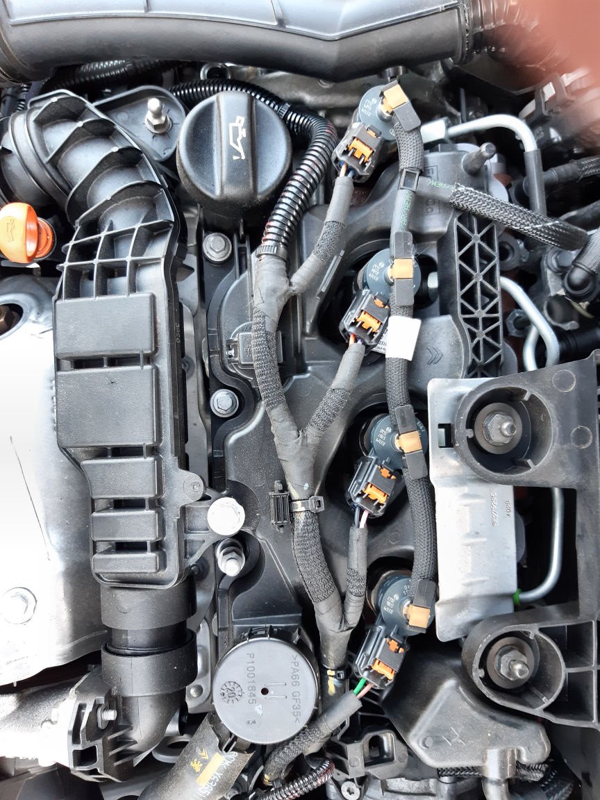

Does this problem apply only to the current series of the 1.5 diesels? I have one of the last of the previous 1.5 engines. The RP is 15800, which is 11 Feb 2020. Here is the view on the top of the engine, and the aluminium tag is numbered 98 279 295, and the further number is 4020. The car is a Peugeot 308 SW, and I really hope it is free of this particular problem!!

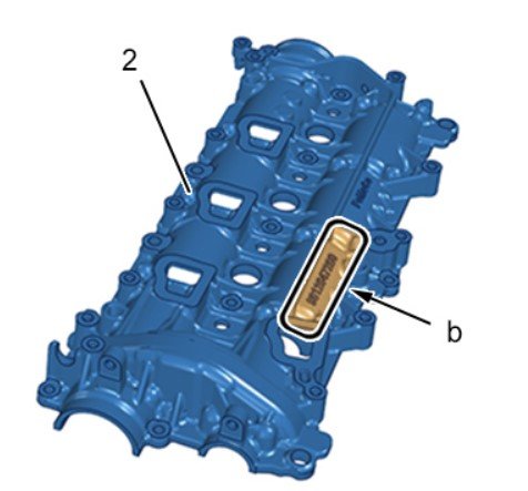

You need to look here on the cam cover shown at 'b' for the part number.
That number is not the place nor a valid part in your picture.

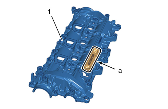

Ok so I've updated the picture for my Aircross with this engine (it's 'a' in this picture): It says use a mirror...
Locate and note the part number engraved on the camshaft carrier (1) (at "a") using a mirror.
If the part number is 98 126 472 80 : The internal combustion engine is fitted with a 7 mm camshaft drive chain: Carry out repair .
If the part number is 98 305 804 80 : The internal combustion engine is fitted with a 8 mm camshaft drive chain: The internal combustion engine has been modernised

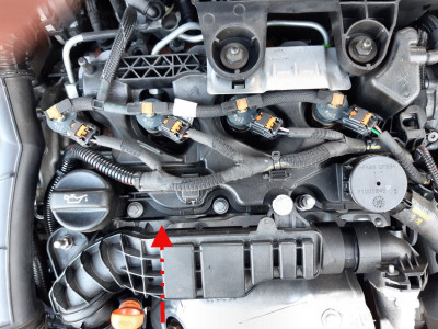

Unfortunately it turns out I have the 7mm chain despite the RP date being well after the supposed change to 8mm.
The difficulty was knowing exactly where and how to find the ident number. This was possible without removing anything, but much helped by using a 2”x 4" rectangular mirror under the turbo input pipe. See the red arrow for direction, the number is cast onto the cam cover aluminium, and very high up.
