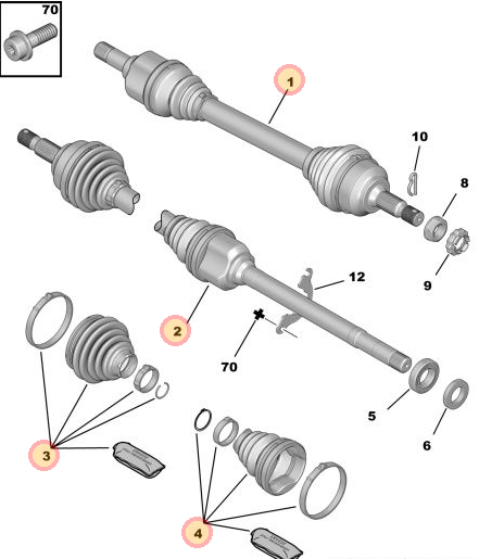

Can anyone tell me what Drive shaft and cv joint i need Citroen c5 1.6 hdi vtr salon , diesel , front near side please keep getting conflicting answers please
2009 plate
1.6 vtr hdi
salon
diesel
4 door
vin number VF7**************[VIN obfuscated, can be read by forum staff]
- x 6953

Driveshafts
(1) New OEM Citroen Driveshaft (Left), part: 9801611980, £597.73
(2) New OEM Citroen Driveshaft (Right), part: 9801618880, £597.73
(Note, if available, I usually list the exchange offerings from Citroen, but in this case they are no longer available for the driveshafts, so these are OEM originals).
(3) Driveshaft Gaiter Kit (Wheel Side), part: 329331, £40.92
(4) Driveshaft Gaiter Kit (Final Drive Side), part: 3287A9, £45.02
All VAT inclusive direct from Citroen.
Driveshafts

Note that some C5s were fitted with shafts with non removable joints, but the database doesn't record which (and it may only have been Mk3...)!
