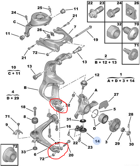

Ok so that rules out the wishbone bush where I've highlighted in Red, which is the problem I had.

Yeah, this car's been through 3 or 4 wishbones at this point, I'm well familiar with how it feel when it fails / starts to fail. Thanks as always for your help. Is there any more light troublshooting I could do to narrow the list down before taking it to a garage? I don't really have the tools to teardown any of the suspension beyond removing the wheel.

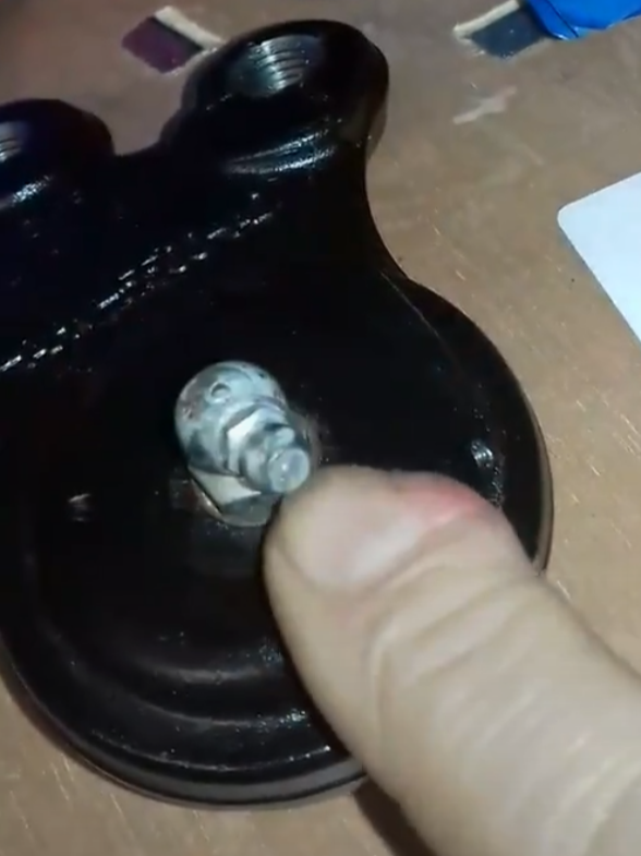

I'm going to order a pair of 90° grease nipples and new FRIP. Various cheap ones starting around £10 per bearing - are they terrible or worth trying if my greasing plan cures / greatly delays the main failure mode?
Some good info on replacement of the FRIP here:
https://www.frenchcarforum.co.uk/forum/ ... 94#p439194
Also here, from about the post this links to onwards:
viewtopic.php?p=559774#p559774
Also a good bit if info on grease nipple fitment here on the video linked in of the above threads: From here:

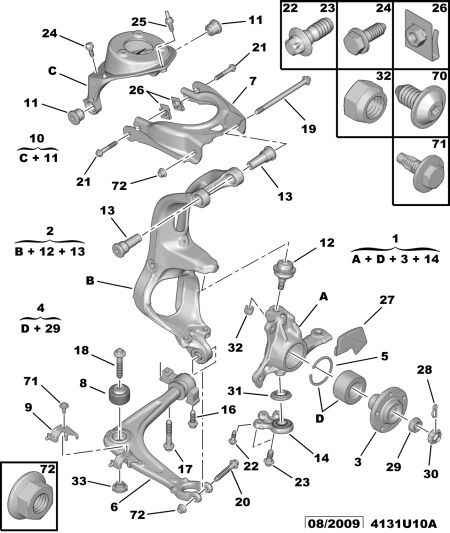

I know above Marc has ruled them out based on what symptoms fed back, but I have also had a read here:
viewtopic.php?p=644727#p644727
Had a quick look online based on part number 3656.04 (which I believe is actually the whole carrier ?? as Citroen don't list the bush on its own) and am tempted to try a cheap pair of them (£12 for two, delivered! https://www.ebay.co.uk/itm/143959886710 )
Seems sensible whilst I am "in the area" changing the FRIP bearing(s = both sides together, if sufficient enthusiasm prevails!)
