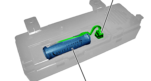

- x 6957
Re: Diagbox BSI Access to this function not enabled
Usually Independent Telematic units have a built-in backup battery for emergencies as I mentioned and can look like this:
