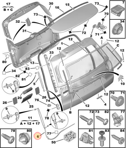

As per your PM, here are the parts for the motorised Struts:
(6) Motorised Tailgate Strut (Left), part: 8731R5, £214.27
(6) Motorised Tailgate Strut (Right), part: 8731R4, £214.27
Direct from Citroen inc. VAT.
