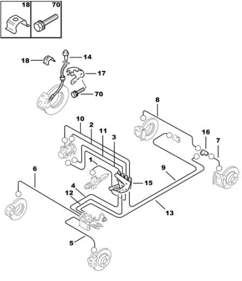

GiveMeABreak wrote: 27 Mar 2023, 16:31
Brake Piping
Return Piping
Brake Piping
Item 4 -
Item 5 - 488671
Item 6 - 488670
Item 7 -
Item 8 - 96106389
Item 9 -
Item 12 -
Item 13 -
Item 15 - 4 x 2 way union
I appreciate this is a big ask so please do whatever is necessary to make your life easier.

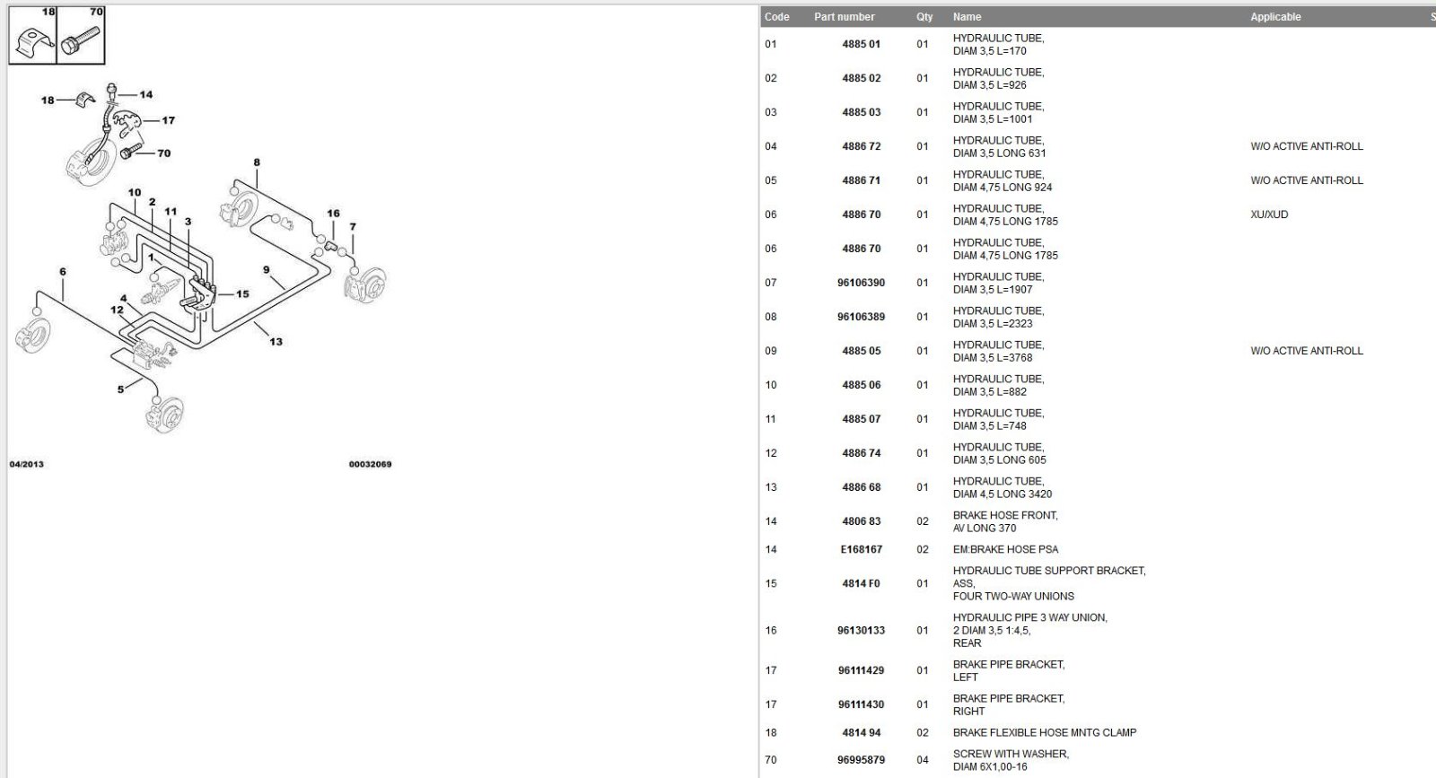

Stickyfinger wrote: 07 Apr 2023, 07:22 Image
This may save you a lot of time
https://catalogs.ssg.asia/citroen/?lang ... 1GQ1QwMDAx
Thanks Alasdair.
Now I know exactly how much cunifer I need for the whole braking system. That’s that done in one fell swoop.
Interesting, or strange rather, how Items 5 and 6 are shown as 4.75mm diameter. Wonder if it’s a typo and should be 4.5mm?

If you can have a cursory glance at the fiche SF provided about and if the official Citroen Fiche shows Items 5 and 6 at 4.75mm. diameter then I do not need that fiche it is matches the Official one.
However, if you look back at the last post on page 6 (along with the first post on Page 7), there are links to the other fiches you previously provided. It should become clear what I am doing.
Can you not simply screenshot the fiche info as Alasdair did in that one from the hooky site or does the breach copyright in some way?
And besides that link is for an HDi 90... :?
