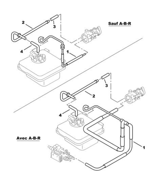

That Part 8 length was bob-on Marc. Really strange routing so thanks for that. Rear pipe now done.

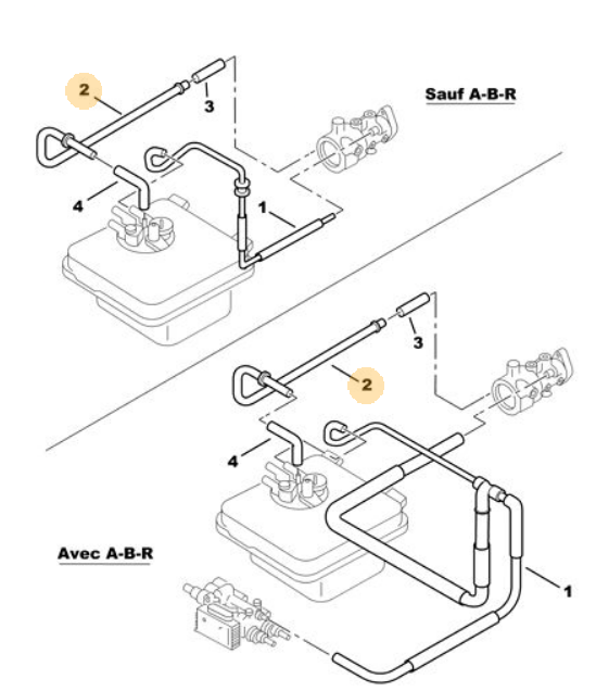

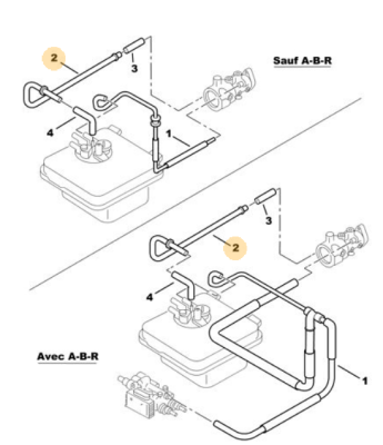

OK. I know it’s NFP but please can I have part number for Item 2 on Brake Return Piping Avec ABR and any other information it gives please.
Ended up cutting the other return and despite me hearing a hissing noise when I pressurised the relevant pipe, that pipe after having cut been is 100% pressure secure so it can only be that hard plastic pipe that has failed.
Fingers crossed it is and I don’t end up trashing another good pipe.
Trying to avoid replacing all the 5 metals pipes if I can help it.
Thanks in advance.
x 6945
Re: Hydraulic Leak 2.0HDi Xantia - STUPID QUESTION
Item (2), part: 5270Y4 (same for vehicles with / without ABS), DIAM 4,5X6. (NFP).

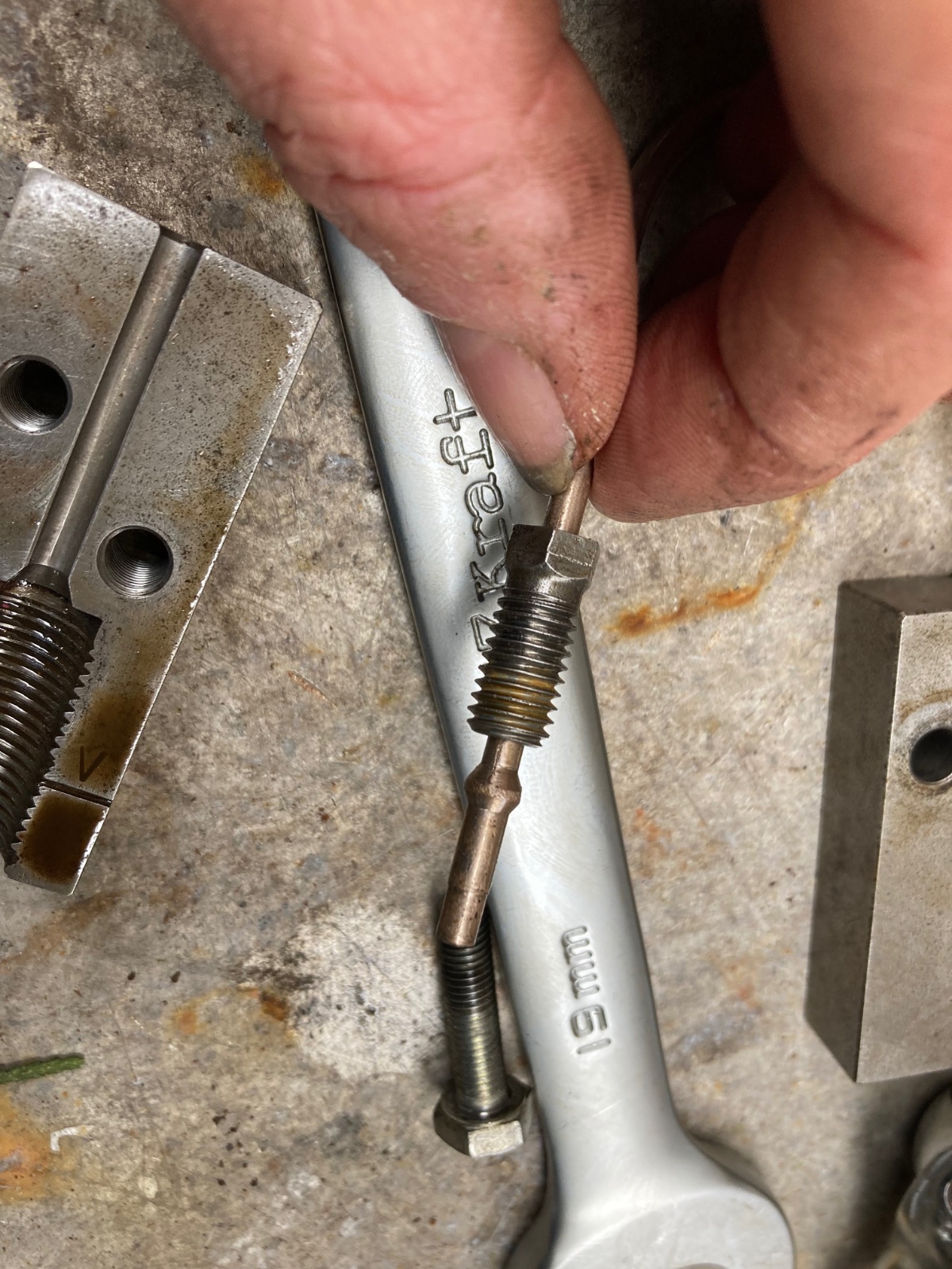

Jay’s tool does a nice little job of forming the flare. This was a test flare using the position marked on the die. In the end, I moved the pipe past the mark to get a wider flare at 5mm. However, the marked V position gives about 4.25mm diameter which is sufficient to get enough purchase from the nut and draw the pipe into the union.

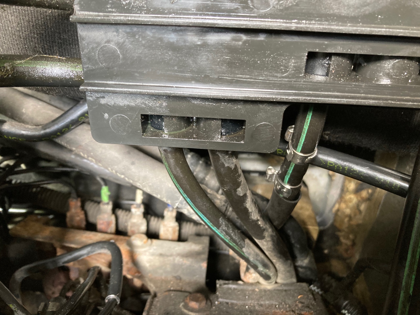

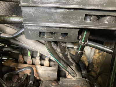

Finding the low pressure return pipe leak was a palaver. Disconnected the 5270R6 return pipe, that comes from the doseur, at the reservoir. Clamped off before the doseur and the pipe to the ABS and then pressurised the pipe.
I could clearly hear a hissing in the vicinity of the coolant preheater. Cut the pipe and then tested the cut pipe. It was pressure sound!!!! So I had just cut a perfectly original return pipe so had to make that good. Can only surmise that my mate was not clamping the other end very tightly and the pressurised air was going through the doseur and back through the hard plastic 5270Y4 pipe!

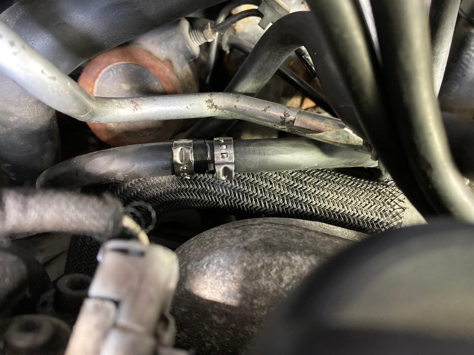

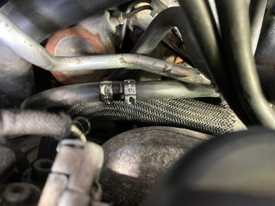

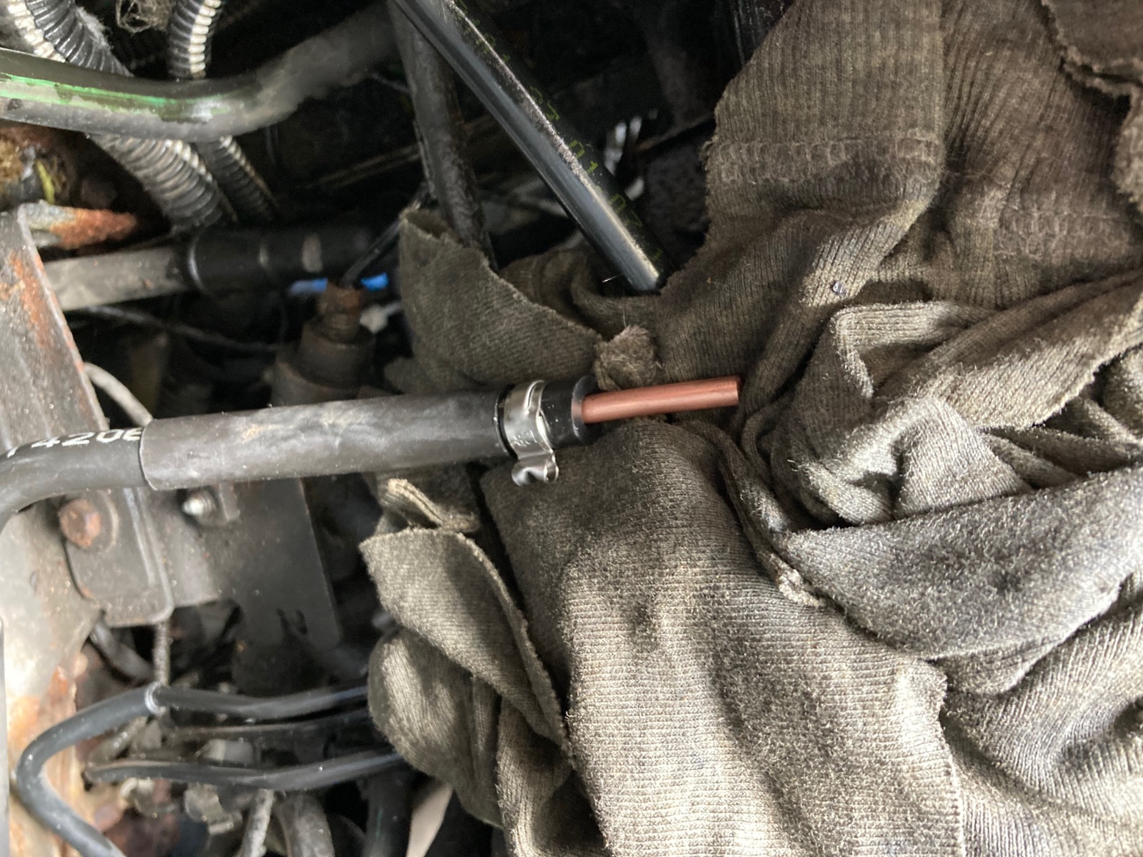

Made the rubber return good with about 7/32” copper. Needed to clamp the new clips fairly tight to seal it.
Used 6mm rubber fuel hose SAE J30R6 spec for bridging the gap created by the piece of hard thermoplastic pipe I had cut out.

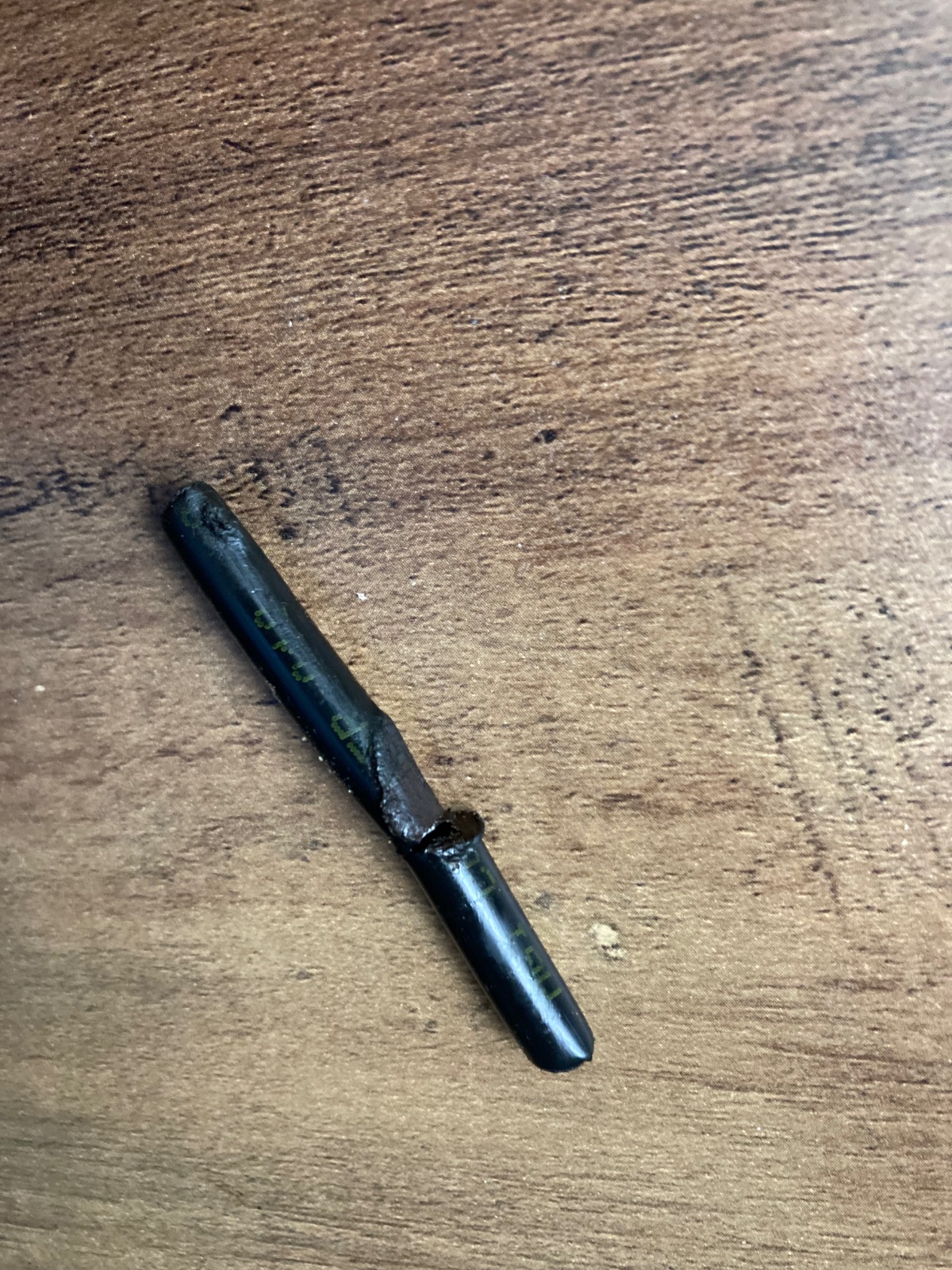

REPAIRS
You can see where this had very probably touched the coolant preheater and melted.
I have a video, some may recall, of the coolant preheater smoking last year. Interestingly, the first video I took of it was the same day as the car failed its MOT last year except it was later in the day that I took it so the issue wasn’t picked up because it didn’t happen prior to the test the second video I took was one day before the retest.
So the pipe had become damaged but I imagine the LHM leak was so slow that it didn’t have time to fill the recess on the bulkhead and then overflow the lip and down the bulkhead! WHAT ARE THE CHANCES?

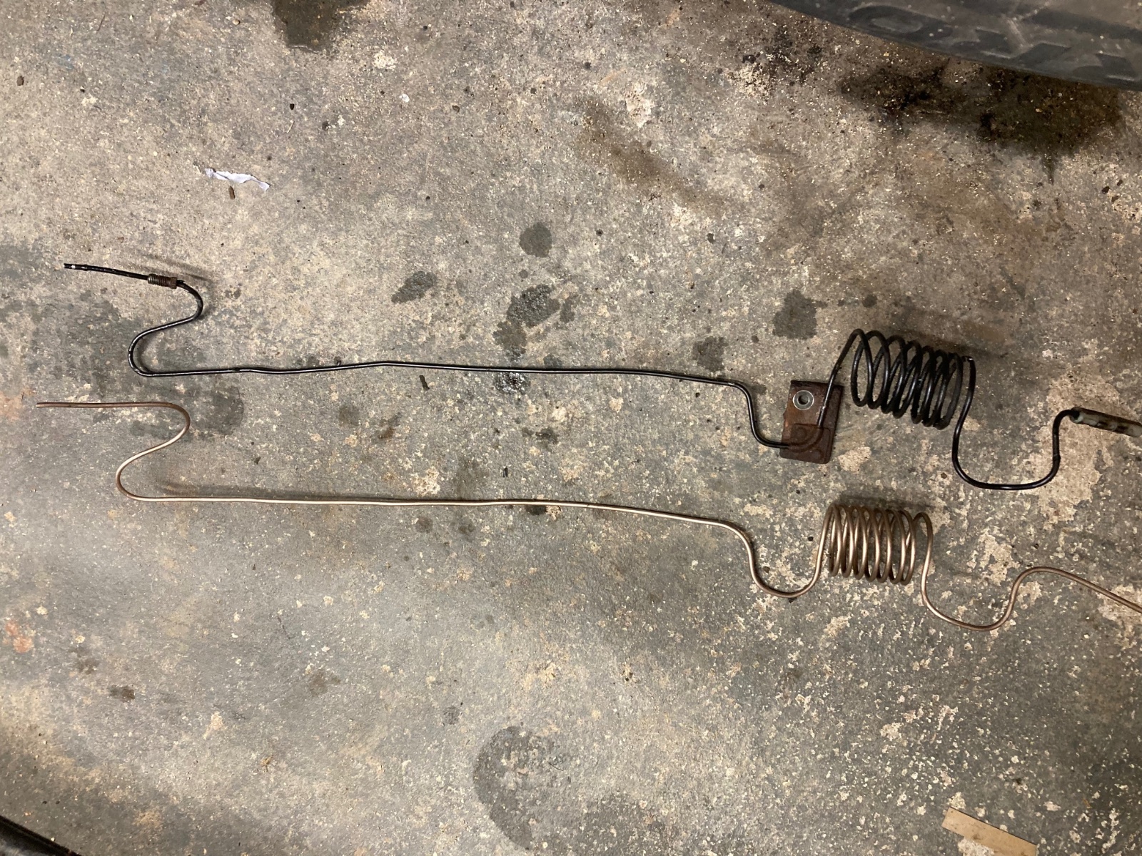

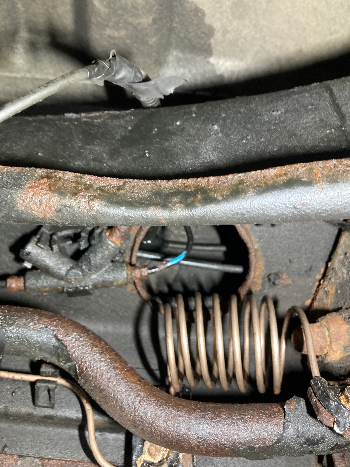

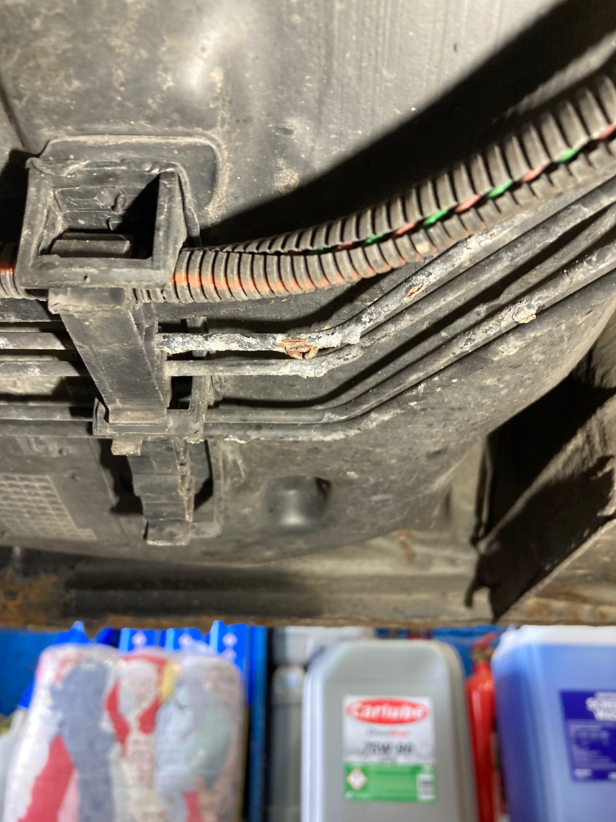

Here are some photos of some of the pipes requiring attention.

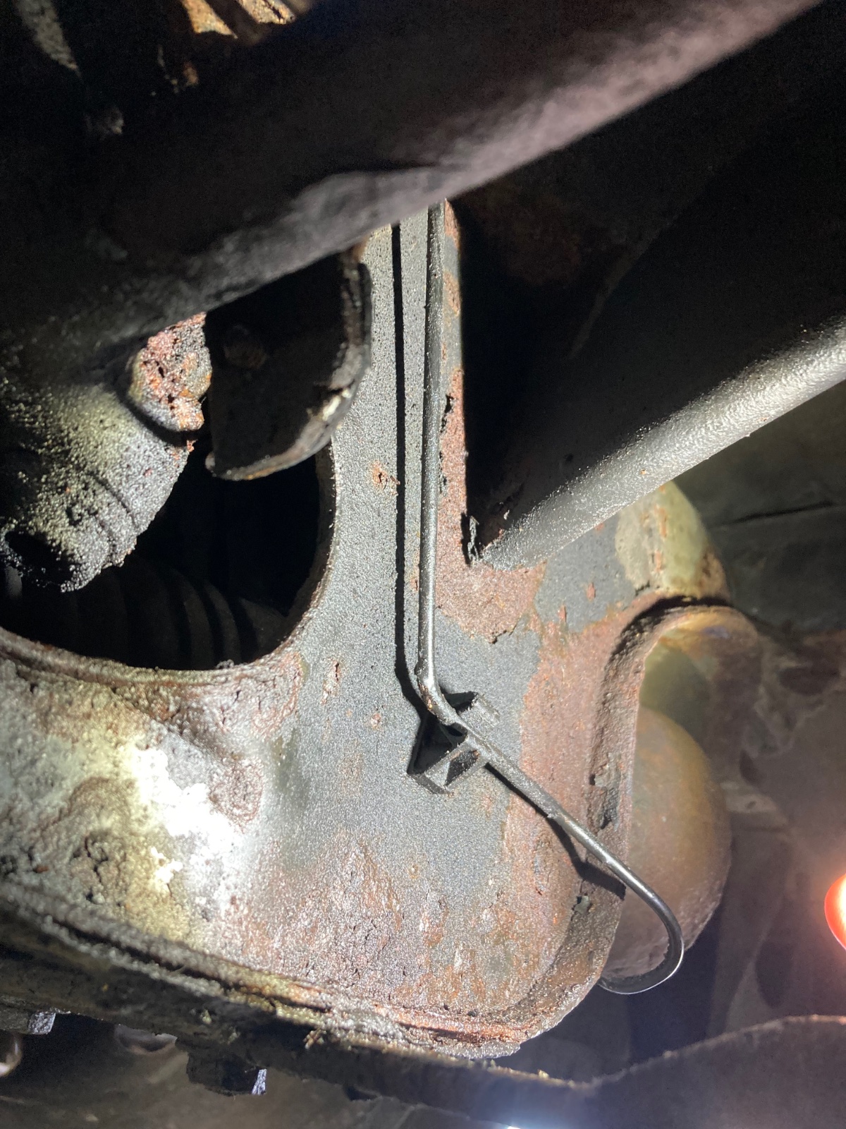

I think I will do the worst. I’ll probably really go at them with 120 sandpaper and see what gives and do those. I’ll leave anything that doesn’t give until I can drop the rear subframe.
