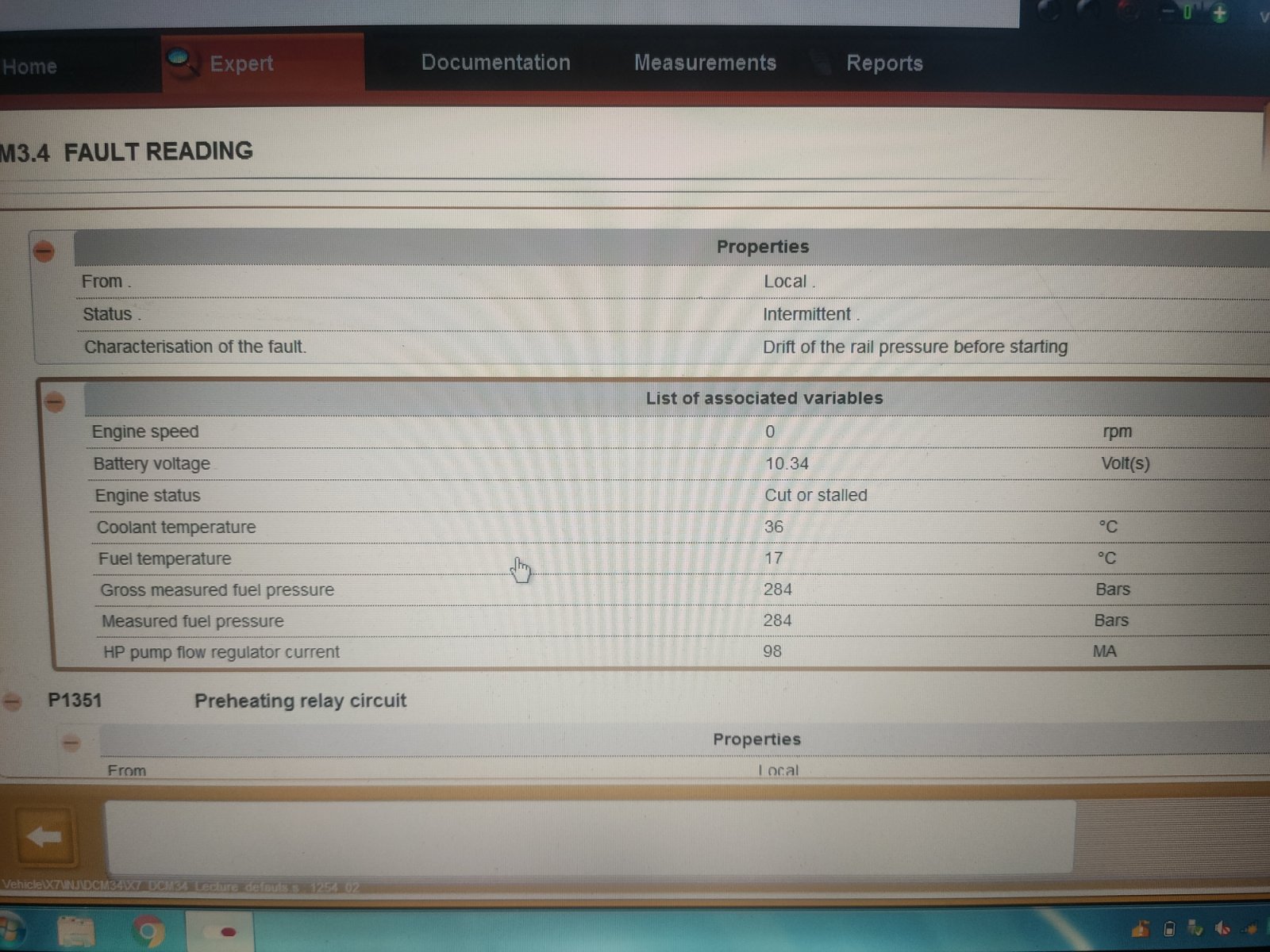

My new arrival has had a temper tantrum and thrown up the above code.
It seems it was ok first thing this morning started fine and drove less than a mile to the shop to post some parcels.
When trying to restart it nothing, no crank nothing for 2 or 3 attempts then started up with Service Light on and Anti Pollution warning.
I have done a Diag session and apart from the usual Glow Plugs (P1351) and BSI F3FF ( uncharacterised initiation ) the Code P1164
Cleared everything . Drove it for 25 mins stopped and restarted, did another Diag still got P1351 but nothing else.
Just asking if it is anything to worry about :)

10.34 volts sounds low, I know that these figures reported via Diagbox are often a fair bit below battery voltage, but wonder if 10 volts is enough for this to be just a spurious fault??

Yes i looked at that but it was parked up for maybe 9 hrs after the issue and i managed to do a diag session with no economy mode and started as expected on the key.
Think the car had done 15 miles in the last 4 months prior to my ownership which began on Saturday so idle thought it may just be one of those things a very short journey and not up to temp but not being there when it happened i am going by what i have been told :(
I am using it for the next couple of days so will get a good 75-80 mile round trip so will see what happens but just confused about the no crank and the fault code. Pretty sure it has no priming bulb so my thoughts are maybe battery and or lift pump.
Either way it is a cracking car well looked after and just need to keep both car and wife happy :)

Someone may correct me if I am wrong, but I think that voltage value is saved data from the moment at which the fault occurred rather than a live reading?? (So could be low voltage giving spurious fault at that point in time) but sounds good news on how long it stayed out of Economy Mode Active!
But equally, that would be same for the engine room figure and that's showing zero.

Thinking more about it the fact that the good lady would have done maybe 15 miles on Monday split into 3 journeys and the short half mile from home to the shop not a surprise a lot of juice taken out of it and it decided to throw a tantrum. :-D
Will keep an eye on it but guess a new battery would be a good start regardless.

Well Battery was changed and have had no other issues since.
