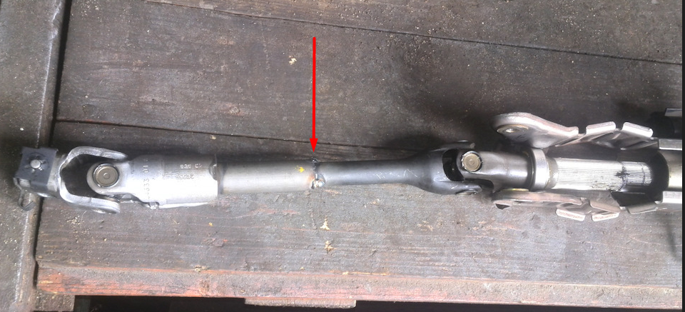

Earlier I was asking about the clanking noise from the steering. Maybe somebody will need a solution, so I'll describe it here.
It's not about the noise from the rack, underneath the car. It's about the clanking noise from the interior, somewhere above the pedals. It sounds louder when driving on a gravel road or something similar, with small imperfections.
Anyway, the steering rack also can be rebuilt if you know how to do it. But it's a different noise.
What I was asking is about the noise that comes from this part:
It can be heard louder when the wheel is adjusted to be as close as possible to the driver and can change the loudness when you push the steering wheel further.
As you can see there are 2 metal tubes with different diameters.
They are made to make the installation easier, they do not affect the steering wheel adjustment or the safety.
Initially what can be done to be sure this is the issue, just insert something there, between the tubes, drive, and see if the noise is gone.
What can be done, to get rid of that clanking noise on bad roads ( solutions I found online)
1. can adjust the position, in my case it helped, I pushed the wheel from the extremely close to the driver position.
2. make some longitudinal cuts, and tighten with some straps
3. I sow that someone welded them (check closer my first image above)
4. on the thinner tube put a rubber tube/pipe so that both tubes have the same diameter. Put a long metal tube with the inner diameter=outer diameter of the thicker tube, so it covers a few cm of both tubes and tightens them with a few straps.

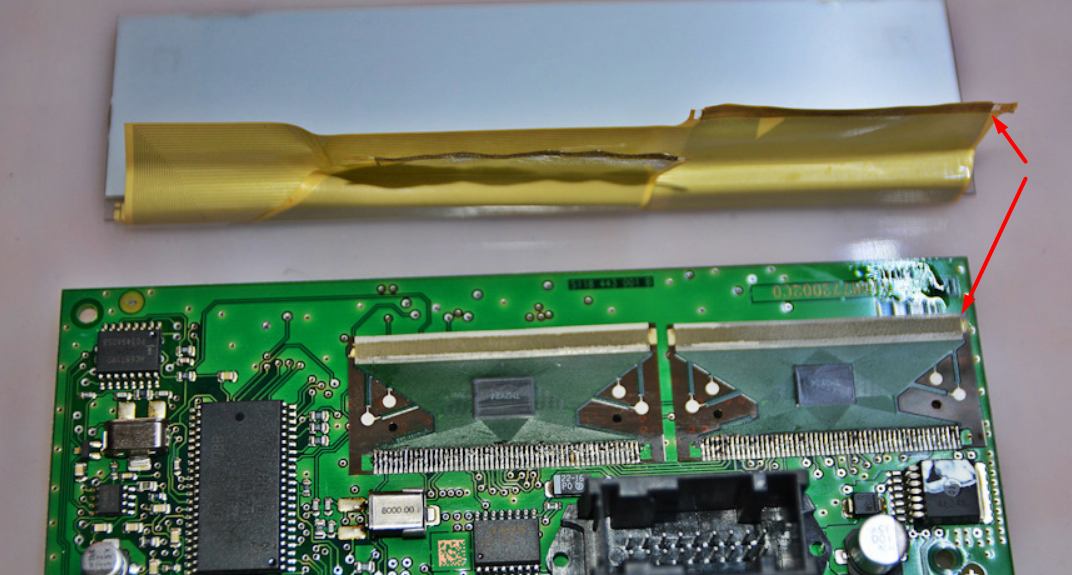

I mentioned that I have a few lines missing on my display.
It's the monochrome one.
Took it off, and found that the issues could be with these:
1. the contacts must be welded back carefully 2. these contacts must be cleaned from the old glue and glued back

Re: Just bought it, C5 '05, few questions
Aneesh84, that's another workable solution.
I couldn't figure out how to take off quickly the knee airbag.
What I heard from people that used this one, is that over time the nails can come off their place, so they just zipped them if they are long enough or put a zip around the tube above those nails.
Another super- quick solution that I just did, just put some super-glue in the gap between two tubes over the night, made a dumping isolation between them.
Super efficient, all noises are gone, will see for how long
aneesh84
- Posts: 370
- Joined: 31 Jul 2011, 22:29
- x 29
Yes alternatively a hose clamp over the nails should also keep it secure and tight.OlegR wrote: 03 Apr 2023, 06:47Aneesh84, that's another workable solution.
Super efficient, all noises are gone, will see for how long![]()
You can try them if your glue wears off!

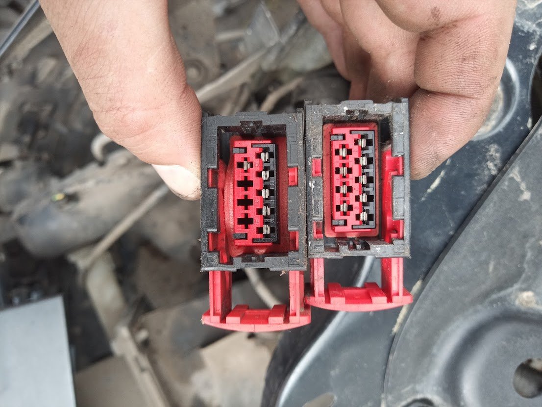

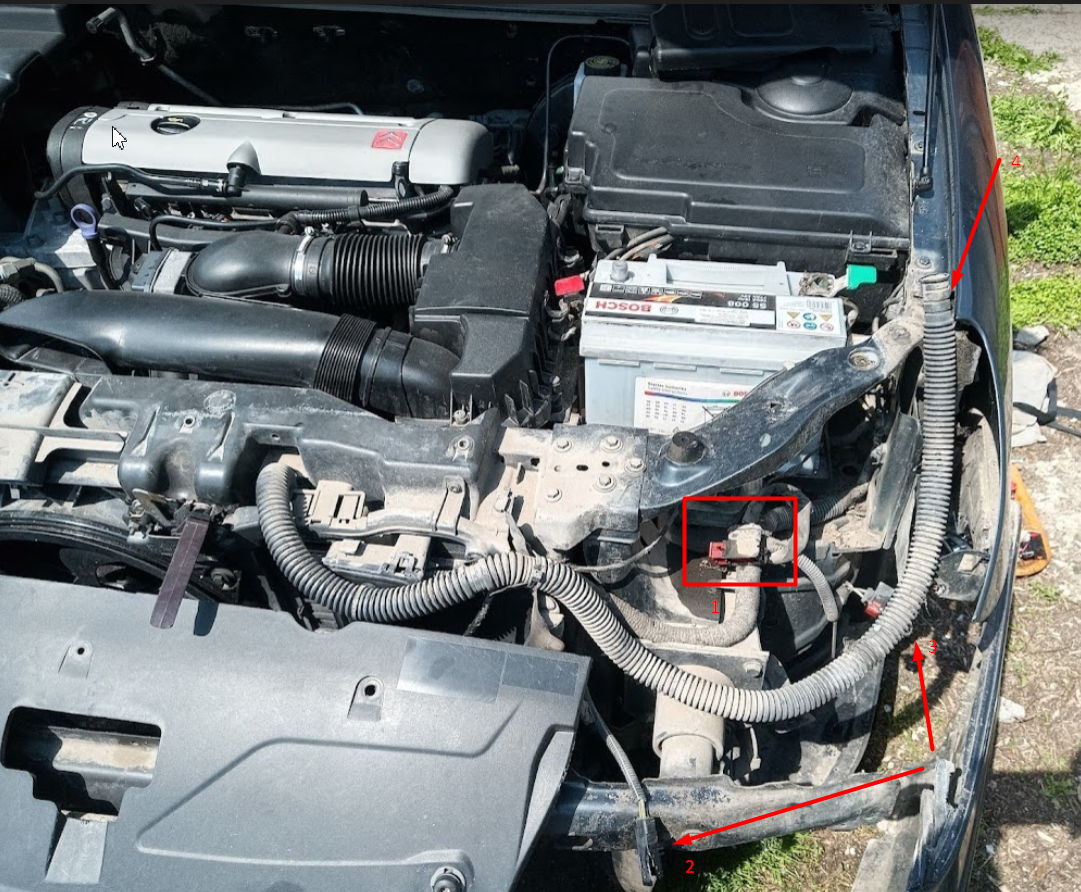

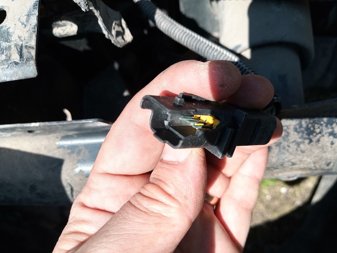

Finally a sunny weekend, so took off the front bumper.
The previous owner had a light front accident so wanted to check everything.
Questions:
What are these connectors:
#1. is from the headlamp
#2 the small one/ black, with 3 pins, another one similar can be found on the other side as well ??? so it can be only related to headlamps or... ? see bellow
#3 the one in the right 4 pins bit different from xenon motor and the wires are short ???
#4 the hose, I found where it should be connected by the end. #2, with 3 pins on both sides of the car That hose goes to the fuse/ecu box for cooling What are these for, I couldn't find what was there clipped?
I found a cheap pair of xenon headlamps, installed them (mine was halogen) and everything worked fine in terms of lightning, just plugged.
I didn't test the auto-leveling, and of cause it's not moving right-left.
The difference between the connectors, the xenon one has 3 more pins, not yet sure what are their for :
Questions:
Be aware that some of the connectors MAY be for optional extras that were not specified when your vehicle was made, so you may (if you are not careful) end up chasing a few red herrings.

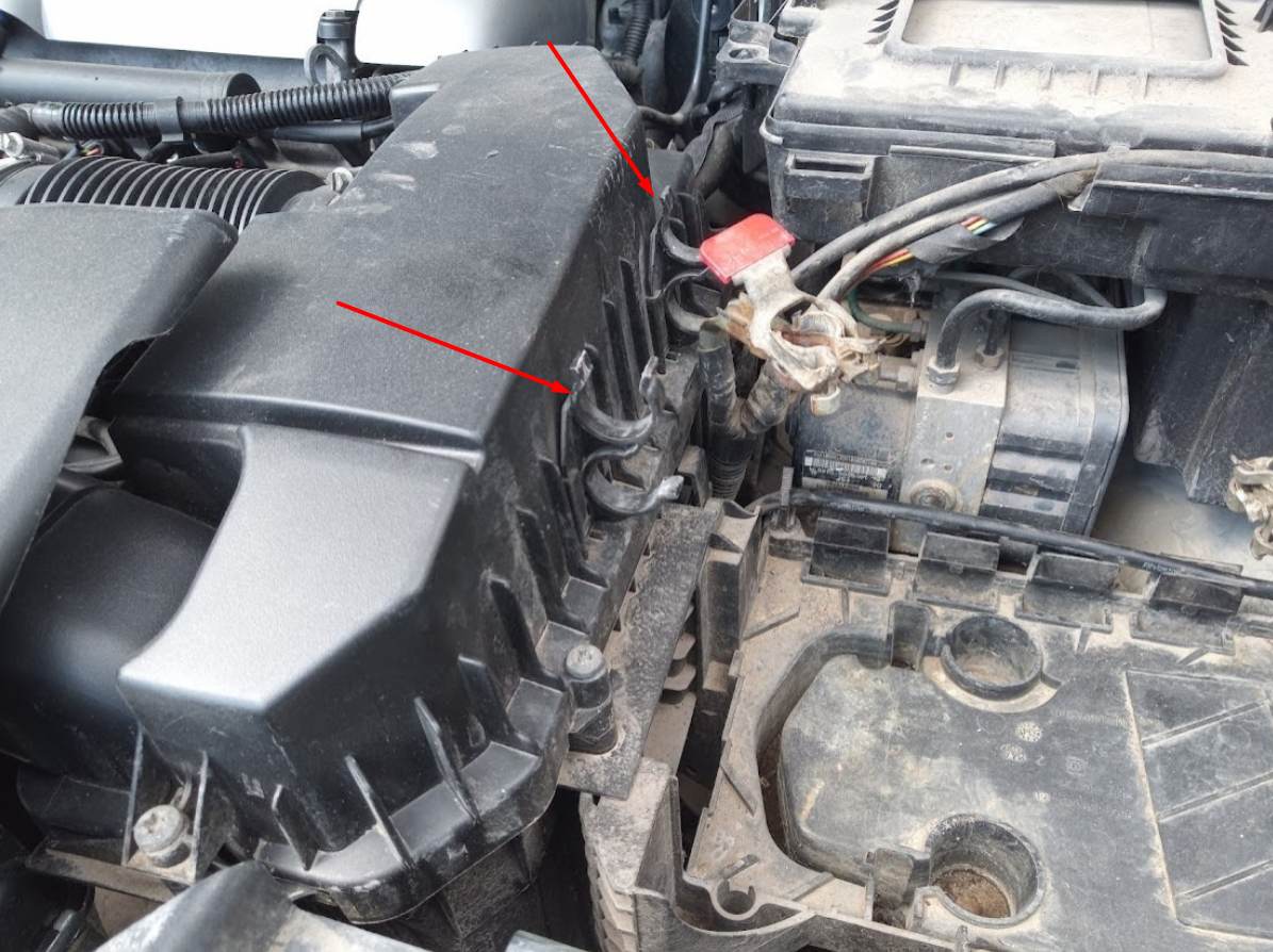

The clips in picture 4 are to remove the air filter cover. They need pushing in to remove once the other clips have been undone.
Don't expect the Lighting to work properly, you really need headlamp wash system to be legal, headlamp ECU, BSI configuration, and the correct loom (which are different for models with and without Xenons). etc.
